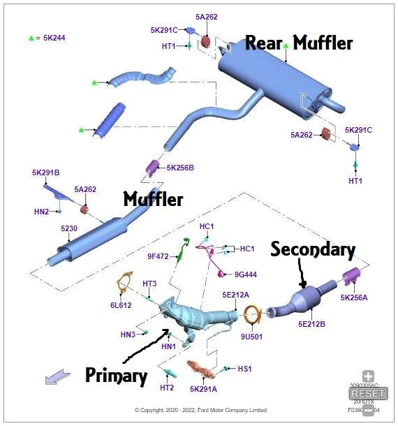

About your ‘one catalytic converter’ statement are you referring only to the 1.5L models? Reason I ask is several muffler shops and at least one after-market shop ( Borla Performance Industries
 ) stated the Badlands 2.0L model has 2 catalytic converters:
Primary catalytic converter is on the Turbo downtube followed by a secondary catalytic converter located under “metal” (maybe felt?) covering.
It's inline with the exhaust baffle unless I've totally misidentified the underside components. I'm still interested in upgrading the useless felt but protecting the cat in today's world is a juicy bonus, if it does accomplish that. But based on the "Hot Wheel" description, I don't think this product will. The primary one is fairly safe, tucked up into the engine bay. The secondary is still a $600 part and vulnerable. It's peeking out in these photos.

I like the idea of replacing the felt with actual protection. If the pair was installed, would it also protect those exposed fuel lines in this photo, and would the passenger side enclose the secondary cat?
Wondering about an increase of on-road noise from these too. Rubber bushings between the floor and plate?
They sell a separate Catalytic Converter Skid that covers the secondary cat. It doubles as a theft deterrent as well.
