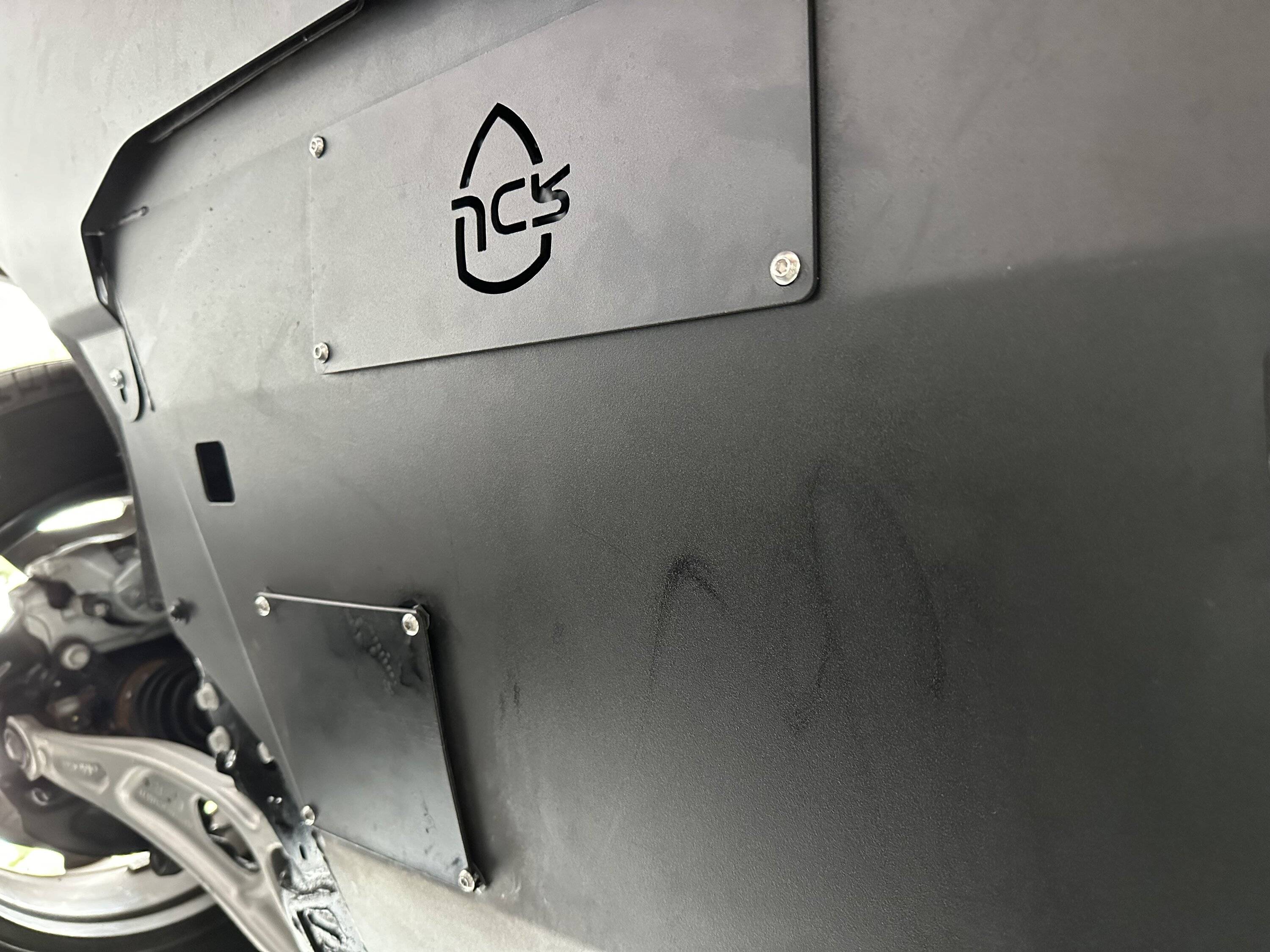

I had the same issue with the drain plug not lining up. I did a minor fabrication, Problem solved.
