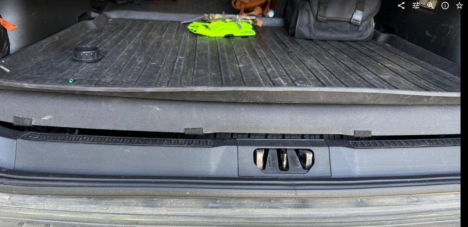

First the photo of the trunk spare tire cover with the 245/65/17 sticking up with tire well insulation left in place
Ford Bronco Sport Sasquatch Tire - fit in trunk? 1750476358432-59
tire reduce to about 12 psi to go into well like this...
Ford Bronco Sport Sasquatch Tire - fit in trunk? 1750476480278-3

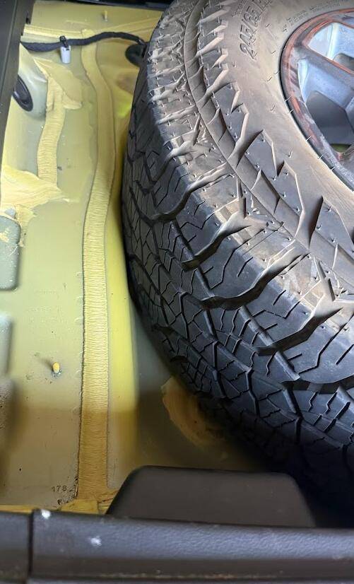

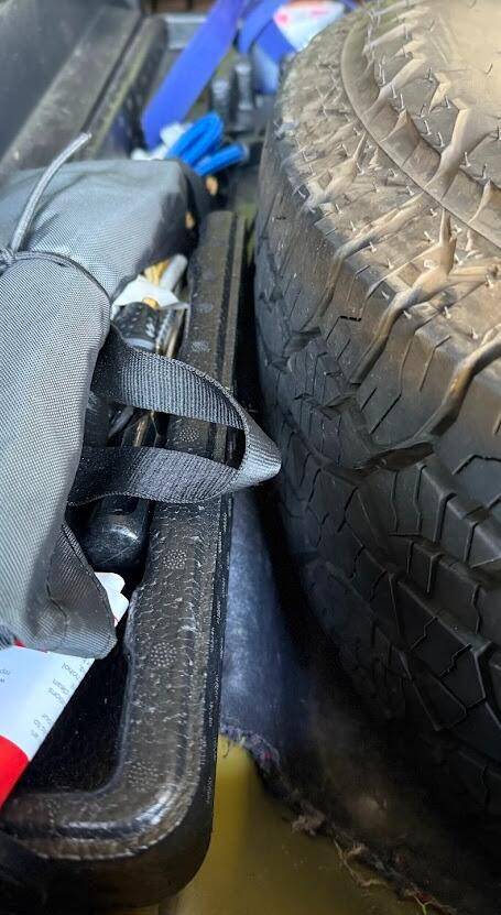

then I removed the insulation liner, the spare went into well easily (still at 12 psi)
Ford Bronco Sport Sasquatch Tire - fit in trunk? 1750476639366-jn
I ended putting some sound deadening mats at the bottom of the well and it fits fine with the cover goes over just like the 235/65/17. I should of try to air to proper pressure....but I didn't.

My experience is that the foam trays can be left in place, they really don’t interfere. If you fill the tire to 33psi you’ll never get it out — it wedges itself against the sides of the well and you’d need a winch to free it. It’ll work at about 20-25 psi.

thanks. yes, the foam trays went back in. so 20 psi is about max is your experience. guess I can just leave it at 12 for now. I can always carry a tire pump with me.
No kiding about needing winch to bring the tire out. as is already pretty heavy. I can see if it is wedged in at 30+ psi....I may need a engine hoist to take it out.

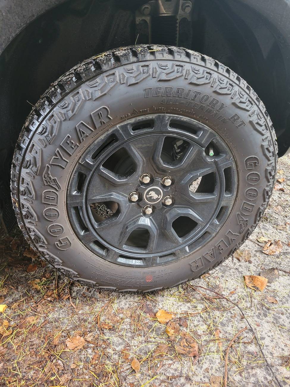

Hitting this thread with the paddles to bring it back to life, along with providing some additional info in case it helps anyone.
To echo what Bill G and WildFord have found, here is a pic of a 21 BS BL with a brand new 245/65/17 Wildpeak AT4W installed on a factory wheel at 12psi. You can just see the tire peeking out. I think I can live with this, and after I get my normal assortment of "gear" back in there on top of the cargo floor cover, I suspect it will be even less noticeable. This is also with the insulation still in place. If I put just a small amount of weight on the rear edge of the cargo floor cover, I can encourage it to go down all the way. Without lowering the tire pressure, I couldn't get the tire to drop down far enough into the well for it to be acceptable to me. I'm looking at buying a used (but new - never mounted) 245/65/17 as a spare to put on the factory spare wheel so I don't have any issues with the AWD/4WD system if ever have to use the spare, and I in addition to wanting the same size, I wanted something a little more "all terrain" than the factory 225/65/17 Pirelli Scorpion that came in there. I suspect that Scorpion would have been just fine, but it's not very expensive to try to match the tire size and have something with a more aggressive tread pattern. Now, to find a portable compressor in case I need to air up the spare!
