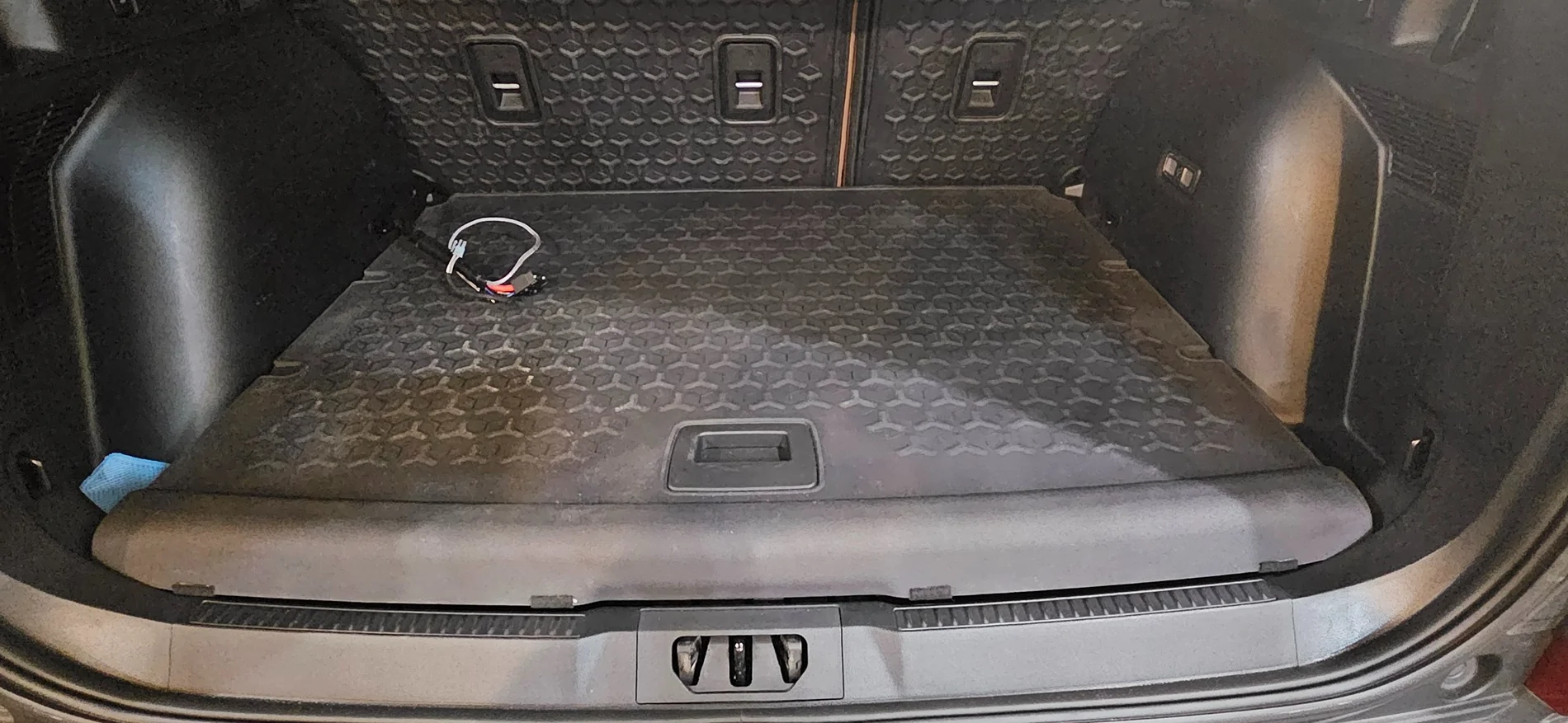

Hitting this thread with the paddles to bring it back to life, along with providing some additional info in case it helps anyone.
To echo what Bill G and WildFord have found, here is a pic of a 21 BS BL with a brand new 245/65/17 Wildpeak AT4W installed on a factory wheel at 12psi. You can just see the tire peeking out. I think I can live with this, and after I get my normal assortment of "gear" back in there on top of the cargo floor cover, I suspect it will be even less noticeable. This is also with the insulation still in place. If I put just a small amount of weight on the rear edge of the cargo floor cover, I can encourage it to go down all the way. Without lowering the tire pressure, I couldn't get the tire to drop down far enough into the well for it to be acceptable to me. I'm looking at buying a used (but new - never mounted) 245/65/17 as a spare to put on the factory spare wheel so I don't have any issues with the AWD/4WD system if ever have to use the spare, and I in addition to wanting the same size, I wanted something a little more "all terrain" than the factory 225/65/17 Pirelli Scorpion that came in there. I suspect that Scorpion would have been just fine, but it's not very expensive to try to match the tire size and have something with a more aggressive tread pattern. Now, to find a portable compressor in case I need to air up the spare!
