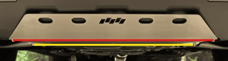

Maybe some underside photos of the skid plate. Also, if it's not too much to ask, could you measure the width from bolt-to-bolt of the 4 mounting points? For reference, the measurements between the bolts represented by the red and yellow lines in the picture below. Thanks!

Yea I'll try to get those to you tomorrow

Red line measurement 38 inches
Yellow 34 inches

Thanks! I really appreciate it.

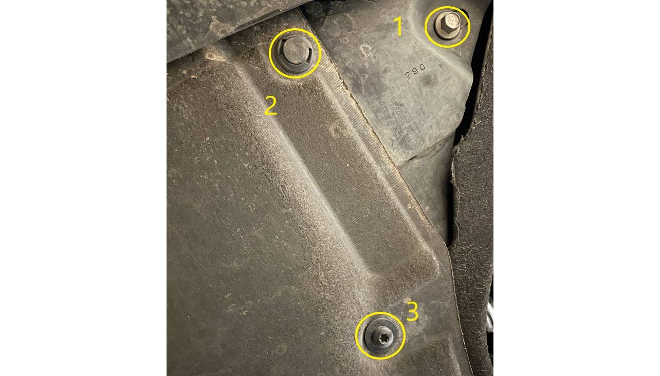

I measured between the gray bolts (only one side shown - labeled 1 in picture below) and the measurement was about 43-44". I also measured 36" between the two plastic grommets (labeled 2) and 33" between the two black screws (labeled 3). So unfortunately, it doesn't look like I have found the same mounting points that are on the Badlands/FE as of now. I may go fishing and start to take off the composite splash shield to see if there are any other holes underneath that would match the Badlands. If anyone else with a non-BL/FE trim wants to start looking too, please do!
