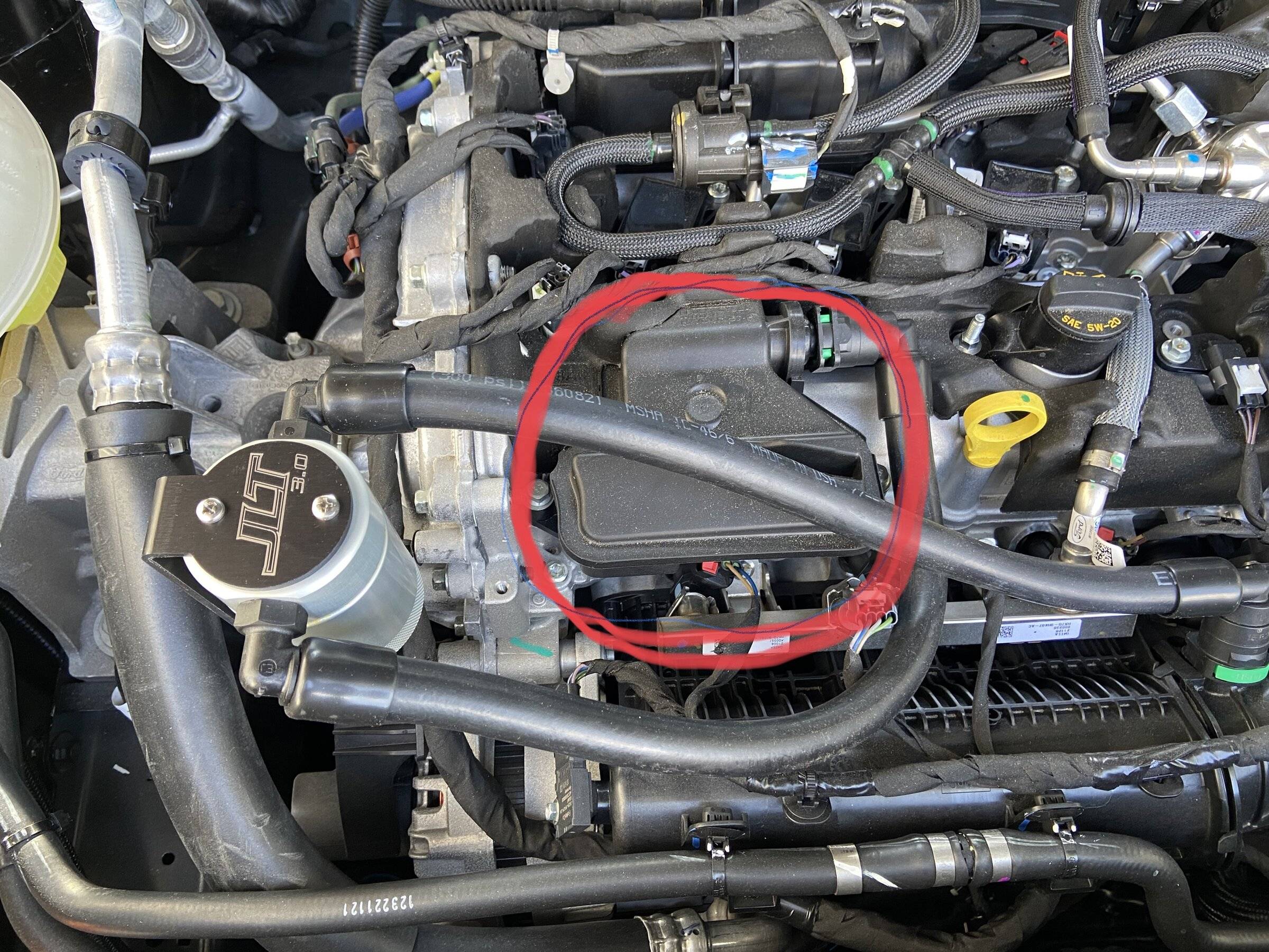

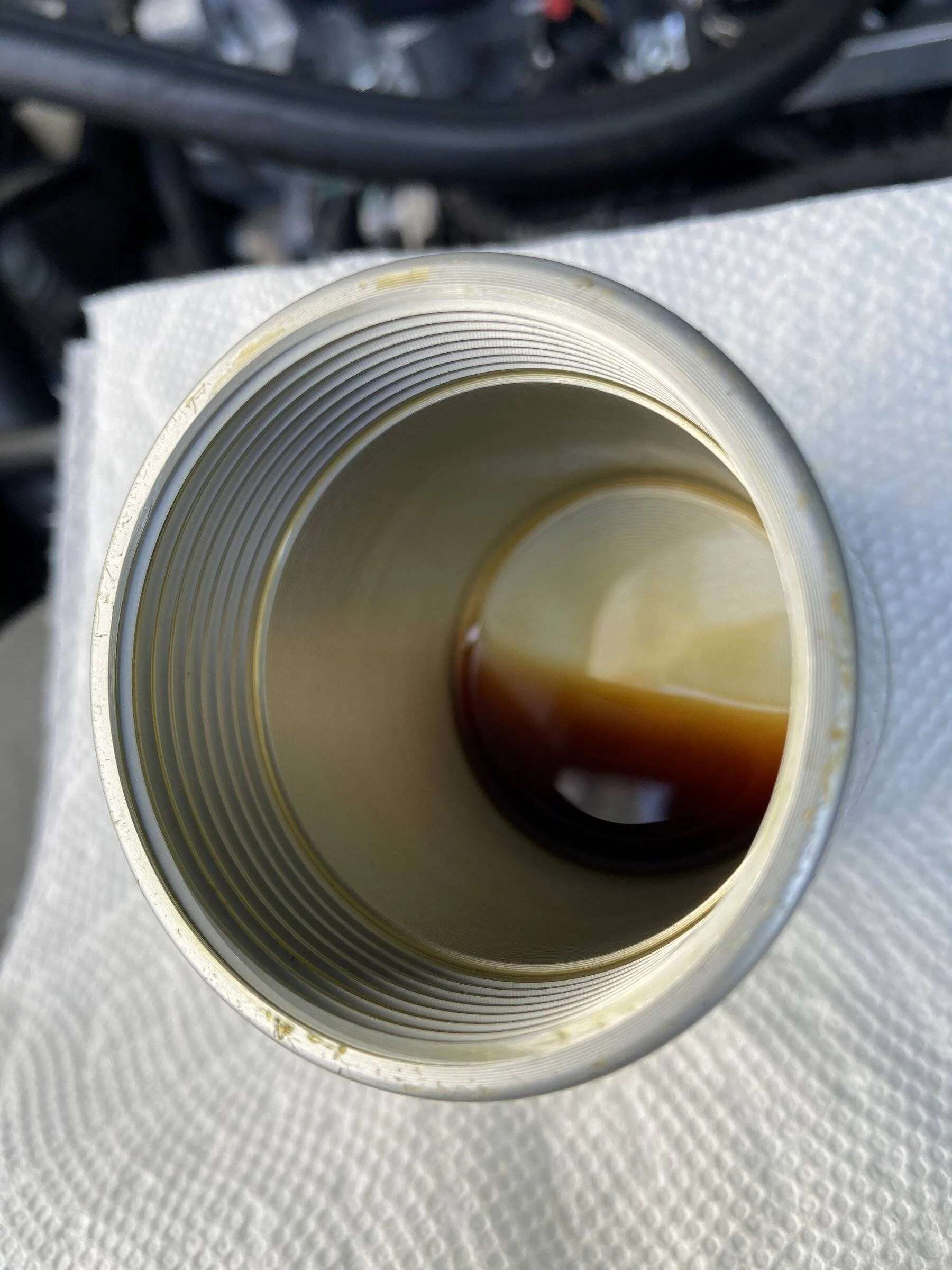

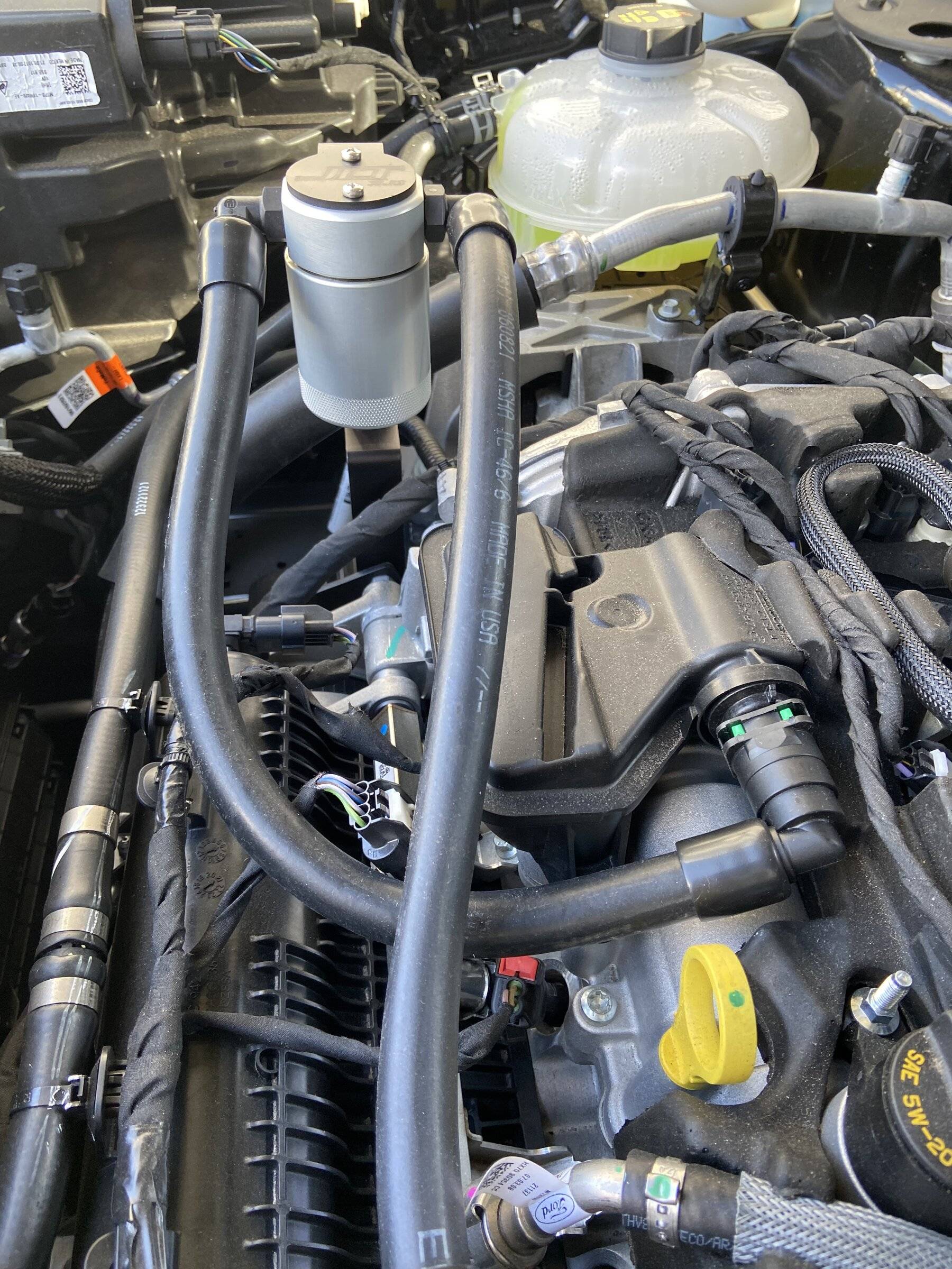

I did this, JLT 3.0... Actually, Ford already has an oil separator on the 1.5L. In the second pic, coming off the left side of the JLT can, follow that hose to where it connects (2 green tabs), that container is Ford's oil separator. So we're getting double protection right, ;).
Ford's oil separator dumping it back into the oil pan, maybe, I don't know? My JLT can is about half full at about 1500 miles. I have to remember to empty it...
Dumping it back in the oil pan is sound science. Crank case venting allows the water to harmlessly burn off.
I do not see the need for redundancy with this system.
I have ran several engines up near and past 500,000 miles without this addition and never had an engine related problem.
Part of a motor oil's job is holding contaminants in suspension. The recommended service interval ensures you change the oil before there are enough contaminants to harm the engine.

Ha , never had one in the first place and don’t feel like fighting with the catch can to possibly being covered by said engine cover. I’m not putting one on.
Hey, I'm just kidding you, the engine cover won't interfere with the catch can because it sits just outside of it. I also have the JLT but I want to replace the phillips screws for the cap to a allen screw.
