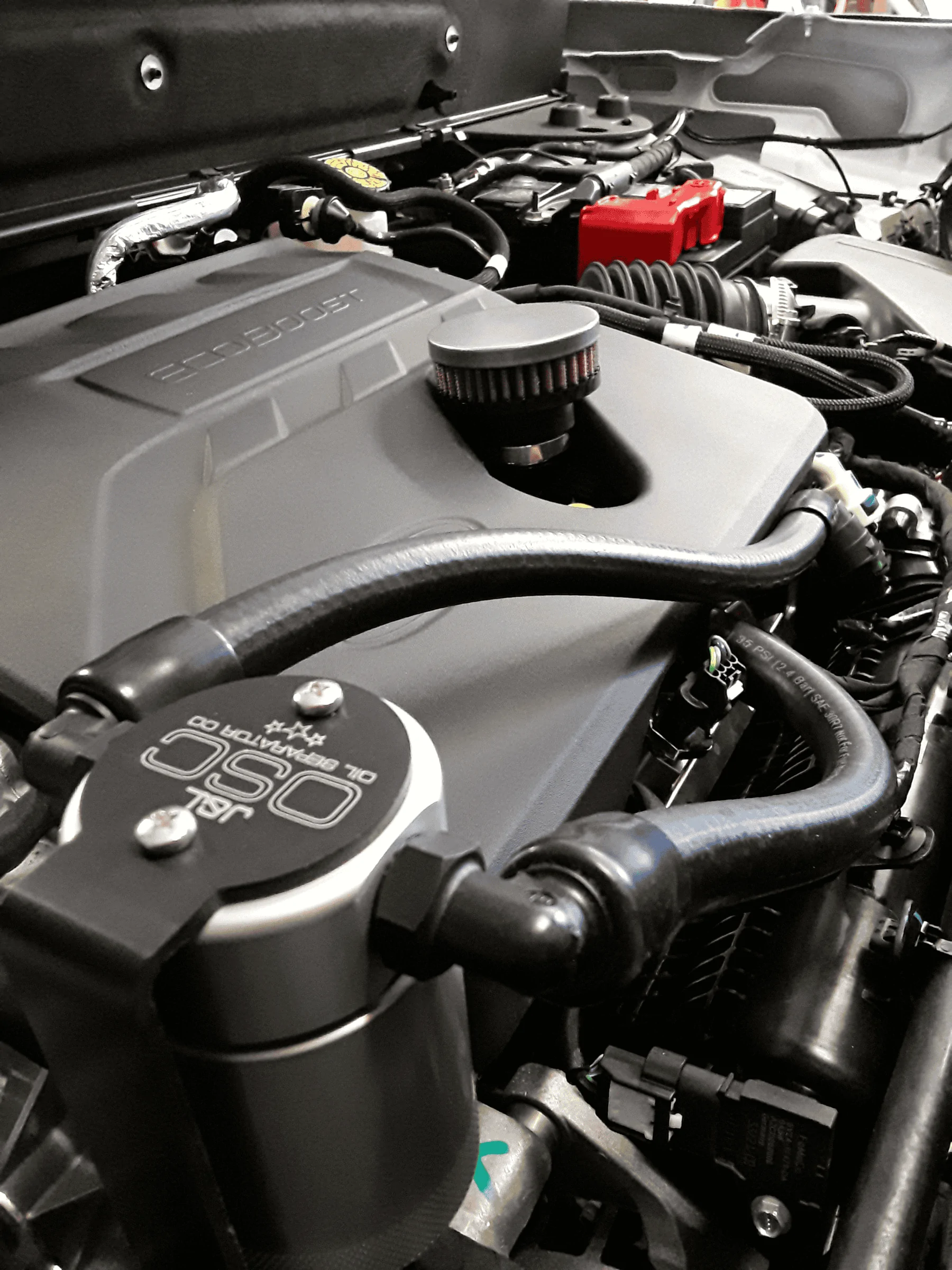

too soon to re-introduce the breather debate? ?

Why on earth would anyone have a breather and a catch can?
related but independent of each other
breather function: when blow-by gas pressures overcome PCV negative vacuum pressure the breather allows those pressurized
gases to escape to atmosphere.
when the PCV circuit has ceased to lack to vacuum so would the catch-can (being on the same circuit)
it would be at this point a breather picks up the ball and runs with it
2,164
3,159
Belleville, IL
This breather must be working much differently than what used to be common in engines up through the 70's.
