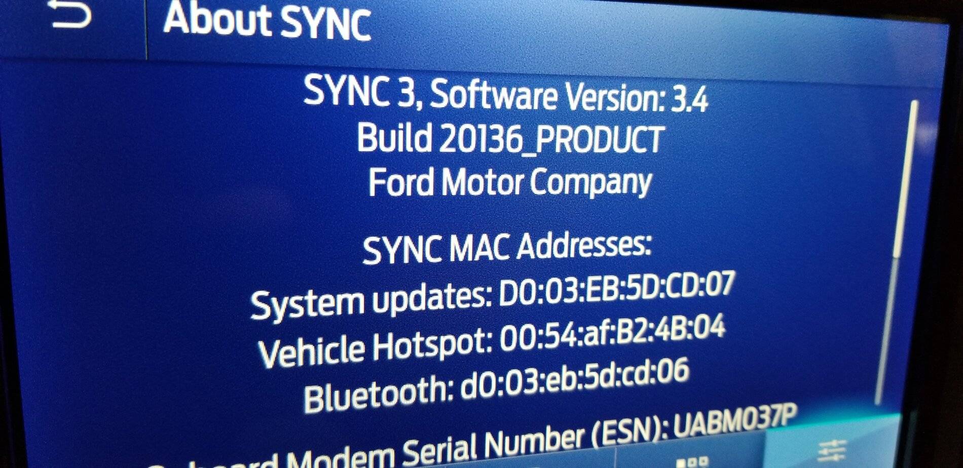

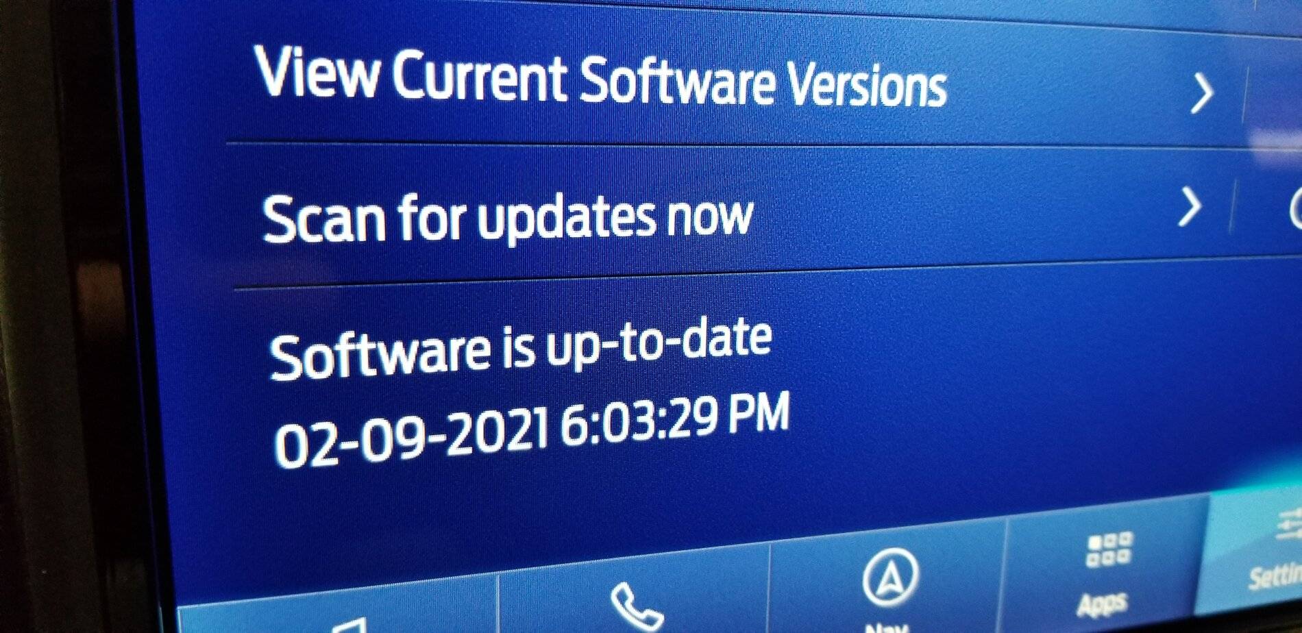

I did first format the USB drive as EXFAT. I'm attaching a photo as requested. I also tried a 2nd USB drive - same thing. It's not really an "error message". It's just a message saying the SYNC software is up to date, and it is Build number 20136 (in the other attached photo). This is incorrect since there is a new Build update 20282. Can anyone tell me - when the vehicle is running, and in Park, and the USB drive is inserted, what am I supposed to see? All I see on the display is that the USB drive is recognized, and a second quick message about some sort of checking file index --- then nothing. For those of you that did the update via USB, should the screen say anything about the update in progress, etc because nothing happens on mine (unless the update is happening but it doesn't tell you)? Thanks.
This is your problem. The files aren't on the drive as expected. You need the autoinstall.lst and DONTINDX.MSA files, along with SyncMyRide folder at the main/root level. It's indexing because when you plug it in, it's not seeing that .MSA at the main level. That's also why it isn't kicking off the auoinstall script.
The other screens are only pertinent to OTA update (scanning). 3.4.20282 isn't available OTA, so it's going to tell you it's "up-to-date" as 3.4.20136 is the most recent OTA available release.

When I updated using USB, on your second picture at the top where it says About SYNC, it changes to a banner something like Updating SYNC blah blah blah. It took 15-20 minutes and everything worked while updating. When done, it flashed a screen to approve a restart.

Thanks to everyone who helped me with this. It is finally solved. The issue turned out to be when I unzipped the 5U5T-14G381-EK zipped file onto my thumb drive, my unzipping software put the unzipped files on the thumb drive in a folder named 5U5T-14G381-EK, and there should not have been this root folder. The folder SyncMyRide and the files autoinstall.lst and DONTINDX.MSA all need to be in the root of the thumb drive, not in a subfolder as the unzipping program did. Hopefully this info may help out someone else. Thank you - update finally worked fine!
