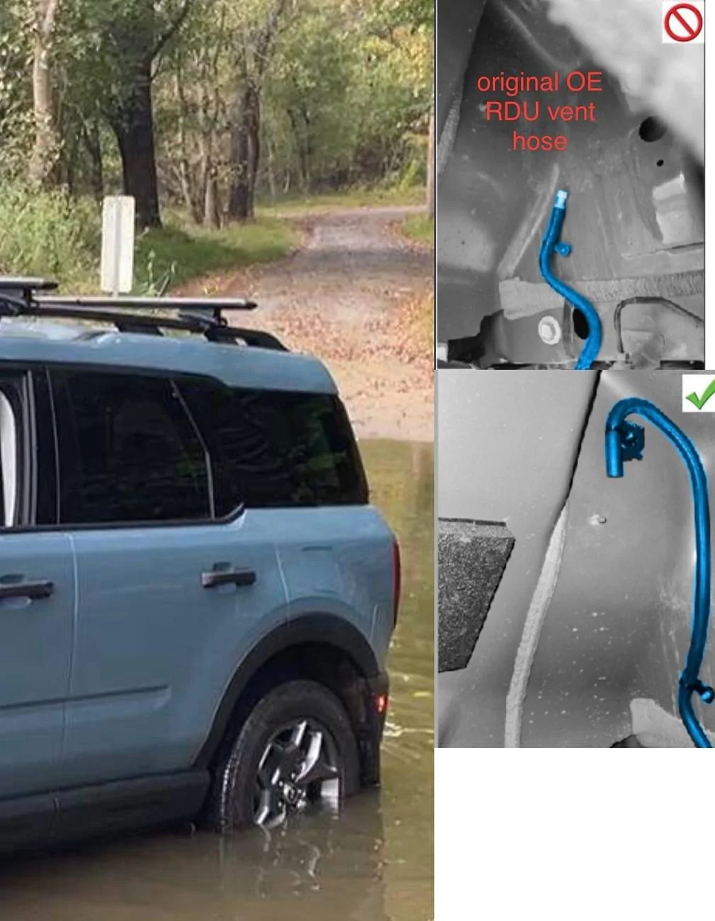

@Major Kong see pic, looks like the top of the original OE vent hose is well above the rear tire (on the passenger side), seems pretty amazing that the RDU vent hose is pulling in liquids and in fact a Ford Tech has commented on a Fb Bronco Sport group that he doubts any of the RDU failures are due to the RDU vent hose design. Not confirmed.. just his opinion.
But perhaps liquids like rain water on the road surface could be forced up towards the top of the original OE RDU vent hose then the liquid is pulled into the RDU which seems plausible given that the redesign RDU vent hose has a 180° curve at the top pointing the vent side downward.
Ford Bronco Sport More RDU issues Imag
it does stand to reason the addition and re-positioning is water related
especially the 180 degree invert of the vent itself
does the force of water get pushed behind the skirting
tire treads may just carry enough water to find any accepting crevice
note the original position
right at the crease point of the wheel well
in roofing terms the "valley"
even more of a collection point
it would be of interest to hear just what was the catalyst for the modification
115
4,740
5,828
Good point, that is a potential collection point for the original OE RDU vent hose
