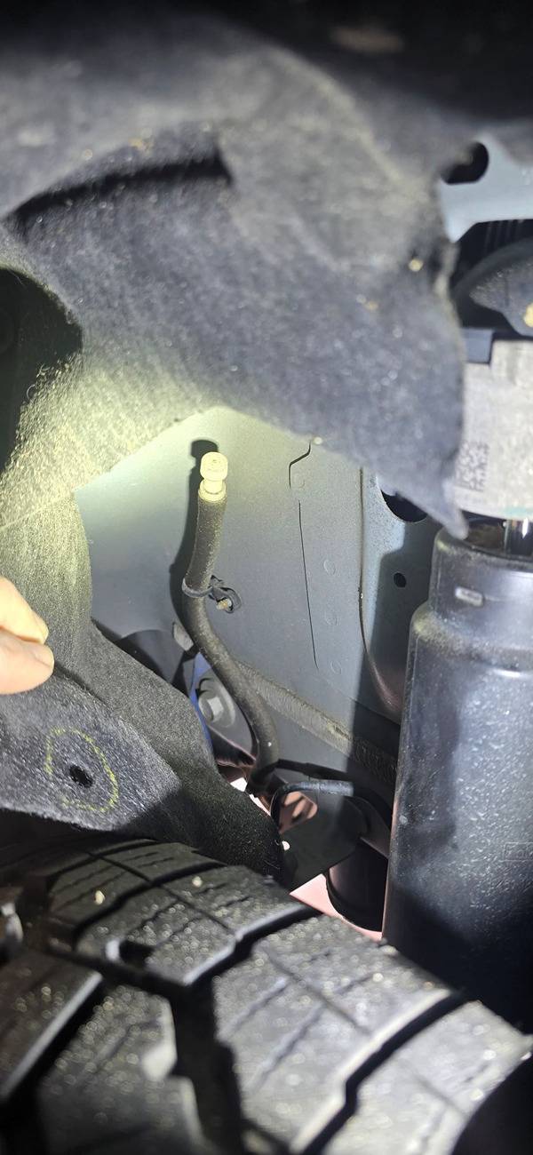

Checked my vent hose out today. Easy to get to when you know what to do. Mine needs to be replaced. I'm gonna talk to my local dealer but I don't expect much. Think I will change the RDU fluid to be on the safe side.

kong solution
remove terminal screen from existing hose
add rubber hose purchased from corner hardware store
sleeve and shrink wrap connection point of old to new
insert screen into new section of rubber hose
good to go until parts come in

RWT mentioned routing to elevated section of rear tail light
concept phase is expanding towards that direction
I may look more closely at the point where the tube 90 degree bends
the point of the bend upward into the wheel well may be a good take off point
from that point of connect a rearward run towards the tail light housing
seems viable
