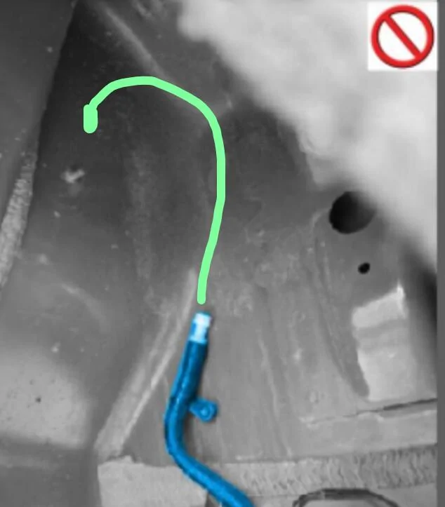

it looks like the new and improved is extended upward and bent downward
makes more sense to elevate to max level
might pick up vent hose myself for switcheroo
catch it before it becomes an issue
Ford Bronco Sport More RDU issues 1725673470092-2o

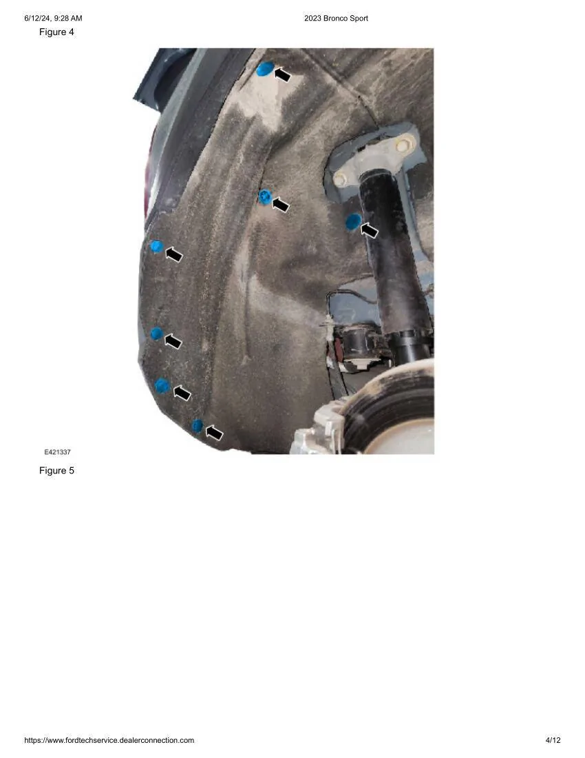

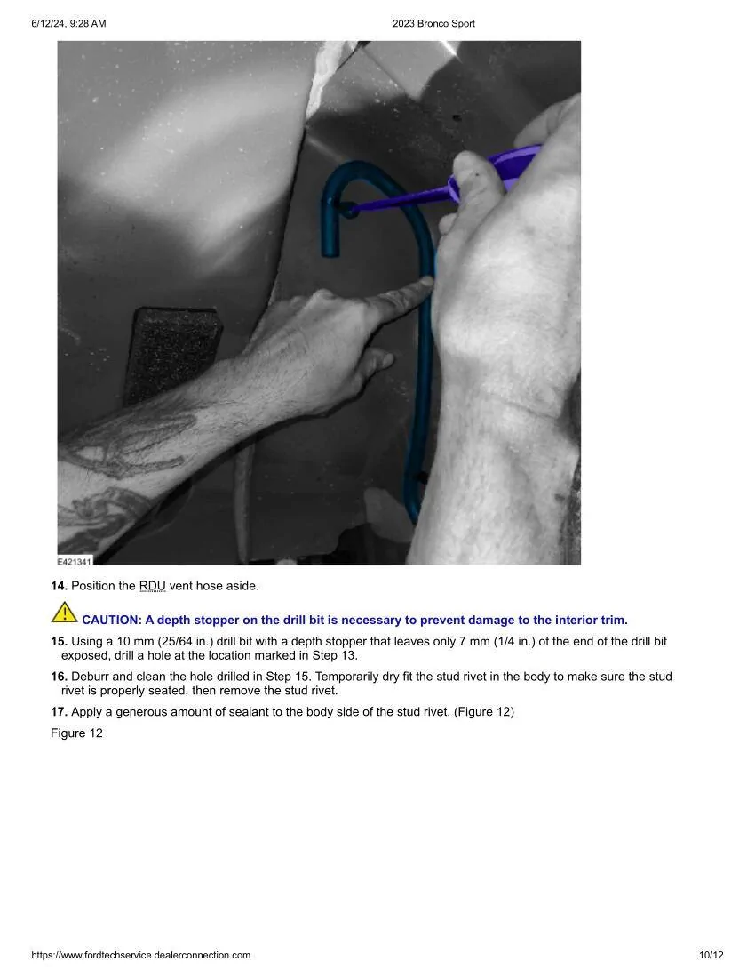

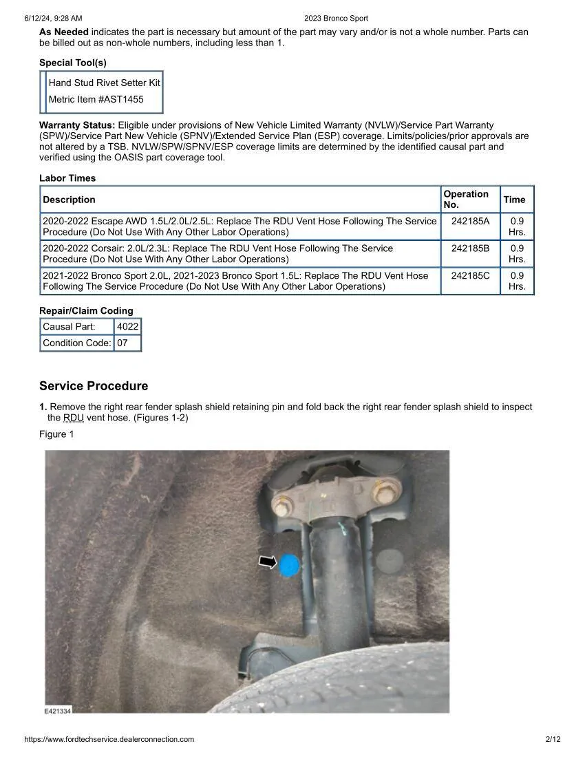

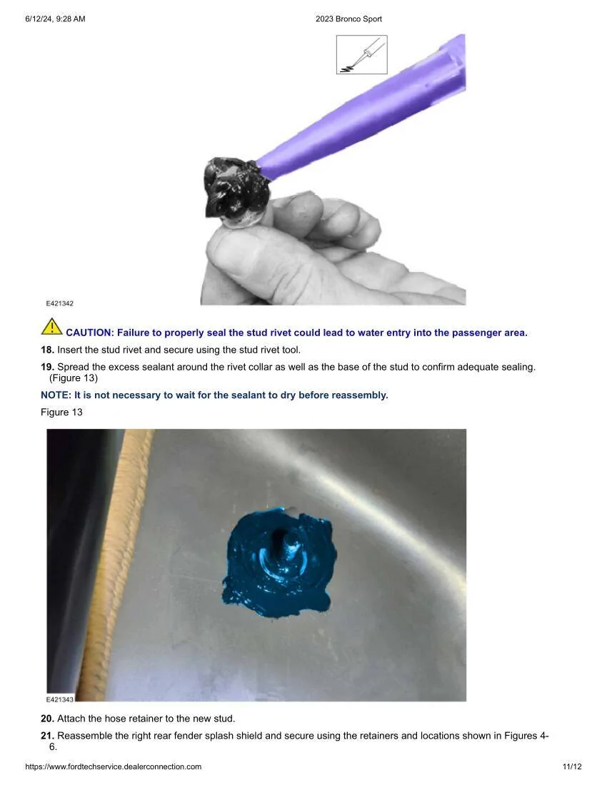

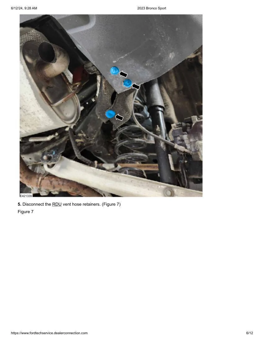

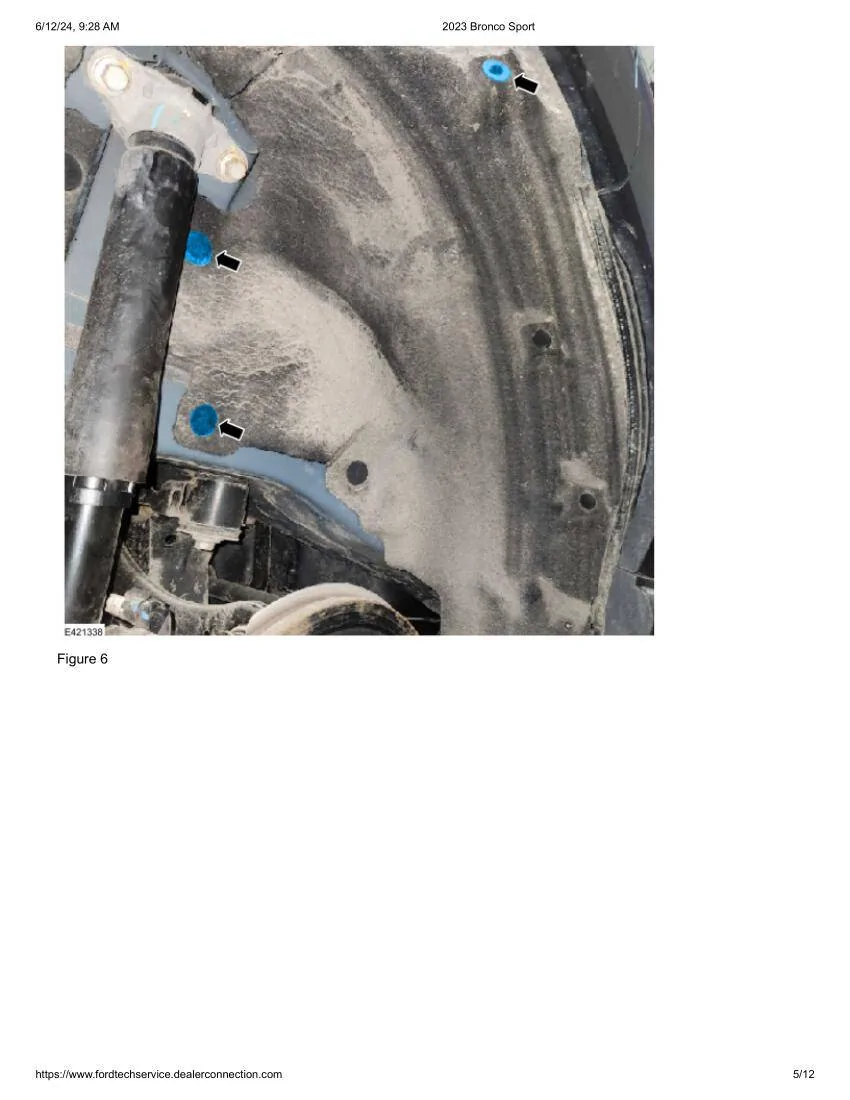

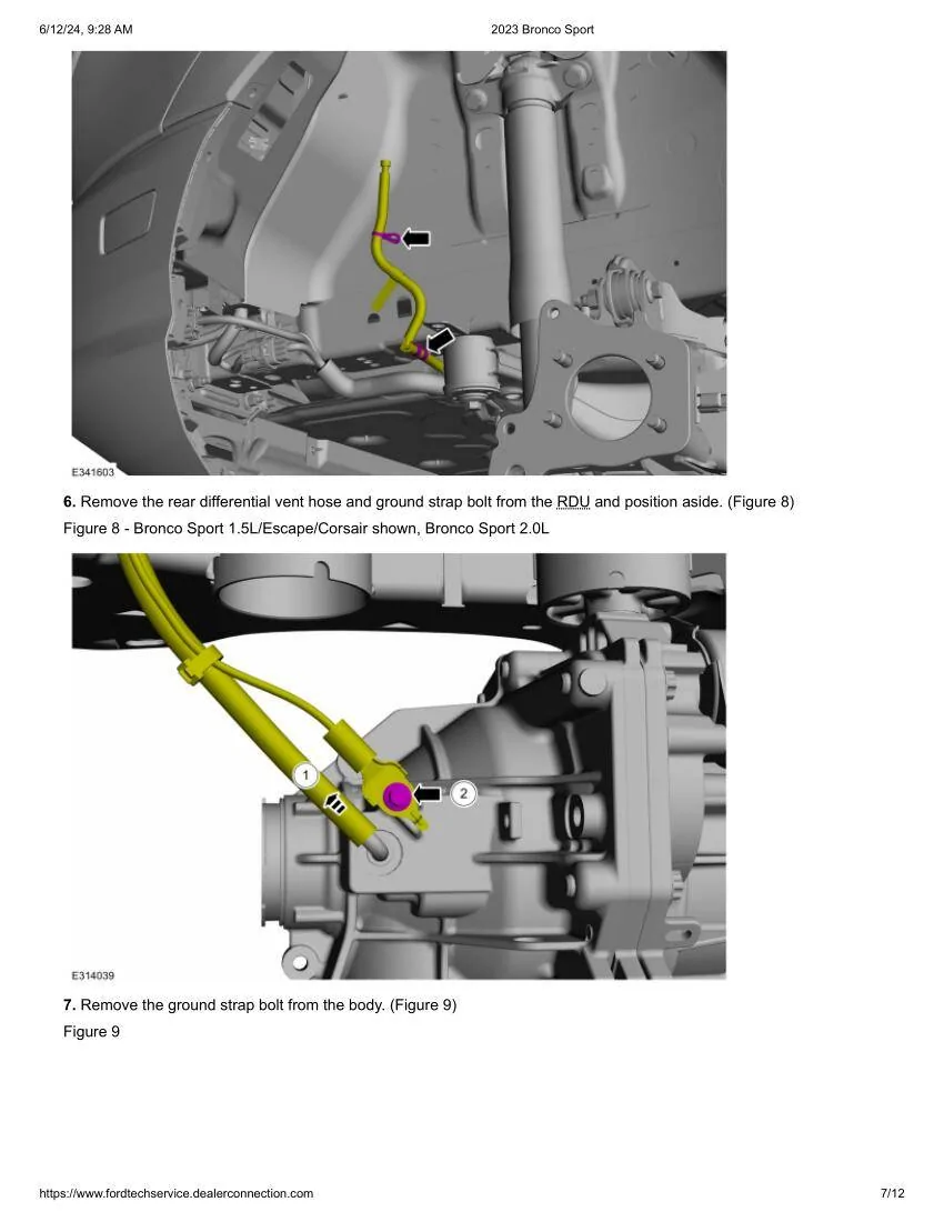

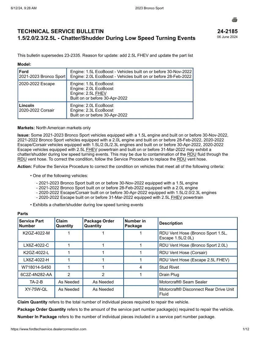

I have a 2021 First Edition I bought used last summer. I need to go out and inspect mine. No noises coming from my RDU so far. The TSB spells out the steps involved.
Ford Bronco Sport More RDU issues TSB 24-2185 11
@BS FE 21 The last page (pic) you posted is #11 of 12. Is there a page 12 you can post please.

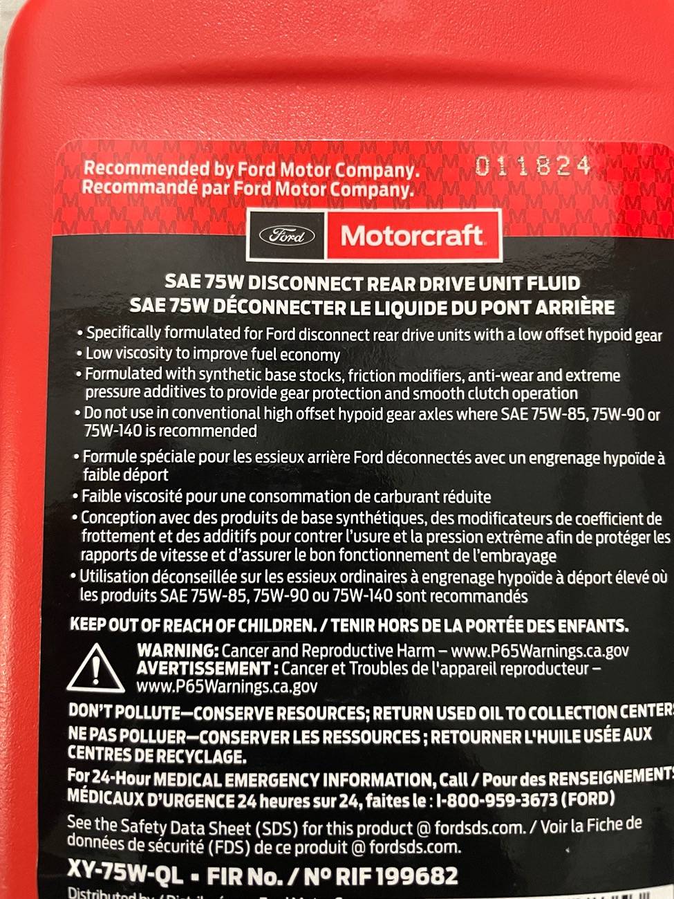

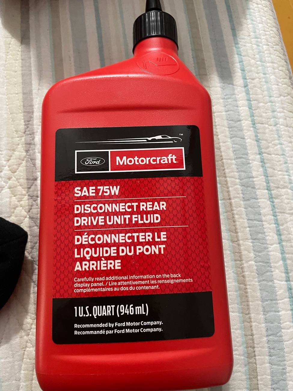

Hello,
after i replace the vent hose and drain the RDU, do i need to mix friction modifier to the new RDU fluid before filling it back up? I saw someone on here mix in friction modifier to the new oil. I got the motorcraft SAE 75W RDU oil from the dealership and it says "formulated with synthetic base stocks, friction modifiers, anti-wear and extreme pressure additives..."
please advise! Thank u

I'm no expert but I believe the oil that Ford supplies should do the job. I think someone was trying to improve the recommended fluid. When it comes to oils and additives there are many opinions. I plan on changing my RDU oil.
