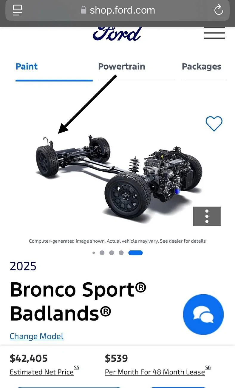

more favorable weather is finally here
shade tree mechanic skills initiated
prepping to make the RDU vent modification
but before committing
quick question addressed to the group
can anyone confirm if the PTU has a vent
it would seem a gearbox would have a need for one
if so my point
two birds one stone
preliminary concept
run RDU vent hose to firewall
run PTU vent hose to firewall
common manifold to vent device

I need to look up the math and physics
Wouldn’t you need a larger diameter vent hose to vent the RDU across to the vehicles firewall
Maybe even an air pump ?

thinking cap material
my guess is we're not dealing with CFM
at best a couple cubic inches in volume bled off as temps slowly rise
reverse flow same unless there's a rapid cool down
aka stream fording
in which case negative pressure may occur in the rear unit
so
your advice will be noted in the concept drawings under review :)
thanks dude

Good points… and I didn’t mean an air pump to move large volumes .. just that air trapped in long horizontal sections of tubing might resist movement to vent

may have found answer to vent question
surprised to see vent only slightly higher than propeller shaft
which raises a question
if water levels exceed propeller shaft could this compromise the gear oil/PTU unit
120
6,729
13,198
This is a different PTU than that used for the Bronco Sport. Refer to the first video you posted. The PTU only turns when power goes to the rear wheels.
Major Kong
Major
Mar 5, 2022
1,209
2,911
Right Here Right Now
Bronco Sport aka "Spark Plug"
video intention to display possible location of the PTU atmospheric vent
sorry for the confusion
the video start time was forwarded to the segment pertaining to the vent
but yes it is a different PTU than the bronco sport
still curious though
why a vent might be positioned anywhere near a potential water submersion
