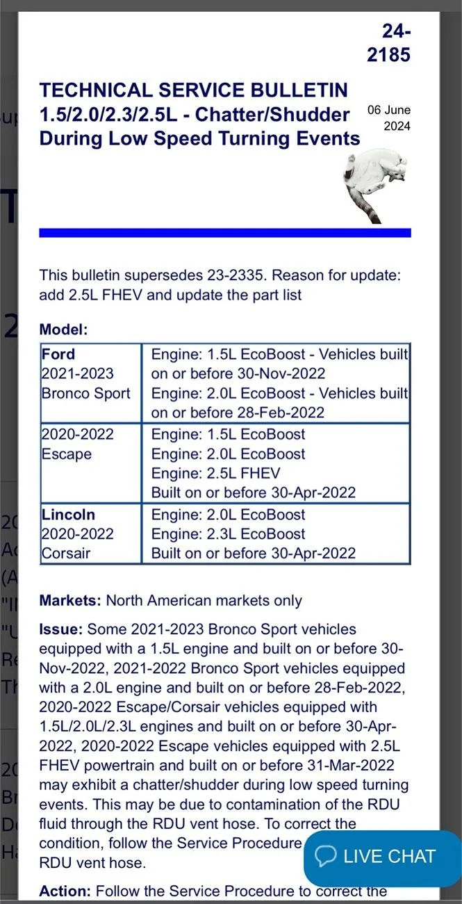

How in the Hell could anyone (service rep or technician) believe that replacing a hose could do ANYTHING to fix contaminated fluid and or failing/failed internal components?? The original hoses were suspect of allowing contaminates in. The FRIKKEN TSB states to drain then fill the RDU with fresh fluid AND the new-design hose installed to keep the new fluid clean. If this combo does not resolve the issue, the RDU is toast and will need replacement. I MEAN, THE STUPID DEALER DERPS HAVE ALL THE INFOS AT HAND AND SEEM TO BE HELL BENT ON NOT FINDING OR USING SAID INFOS. Ford must be doing a Jeep thing, because I do not understand.

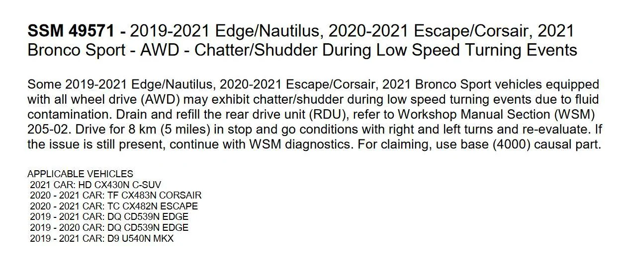

Do NOT give your dealer this SSM (49571) number. Tho' it lists the Sport in the top section, it does not in the, "Applicable Vehicles" list. This is the number I originally brought up to our dealer and after they kept the vehicle for a day, informed me that the Sport is not on the list. There is at least one updated number for this that DOES list the Sport as applicable. It took me 3 more visits to them and a few phone calls to convince them that we have a problem that needs fixed and even at that I had to go to a different dealer and start all over again to finally, months later get THEM to understand, get the parts, and finally fix the frikken thing. 8 months total from 1st visit to repaired.

Correct - see TSB 24-2185 (supersedes 23-2335)

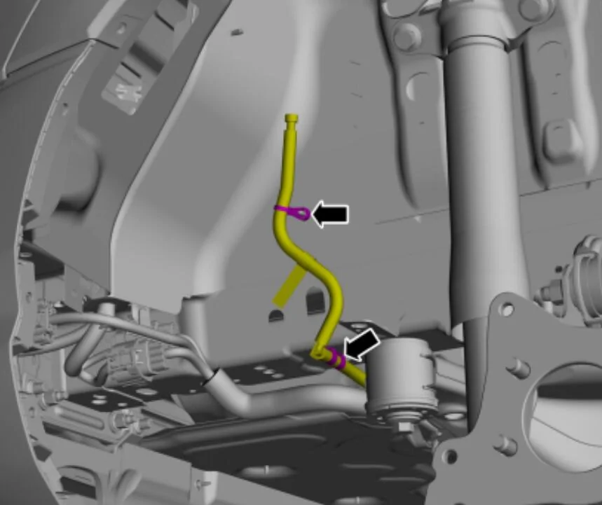

well there's the culprit
vent hose poise in an upright vertical position
ready to take in any moisture
RDU running normal operating temperature encounters puddle water event
rapid cool down
vent air flow reverses
kinda like taking that sip of coffee while inhaling
sometimes not so pleasant
repeat over and over
gear oil turns milky
planetary chaos ensues

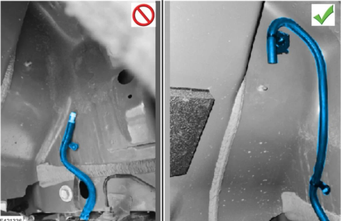

Did you bend it over?
it looks like the new and improved is extended upward and bent downward
makes more sense to elevate to max level
might pick up vent hose myself for switcheroo
catch it before it becomes an issue
