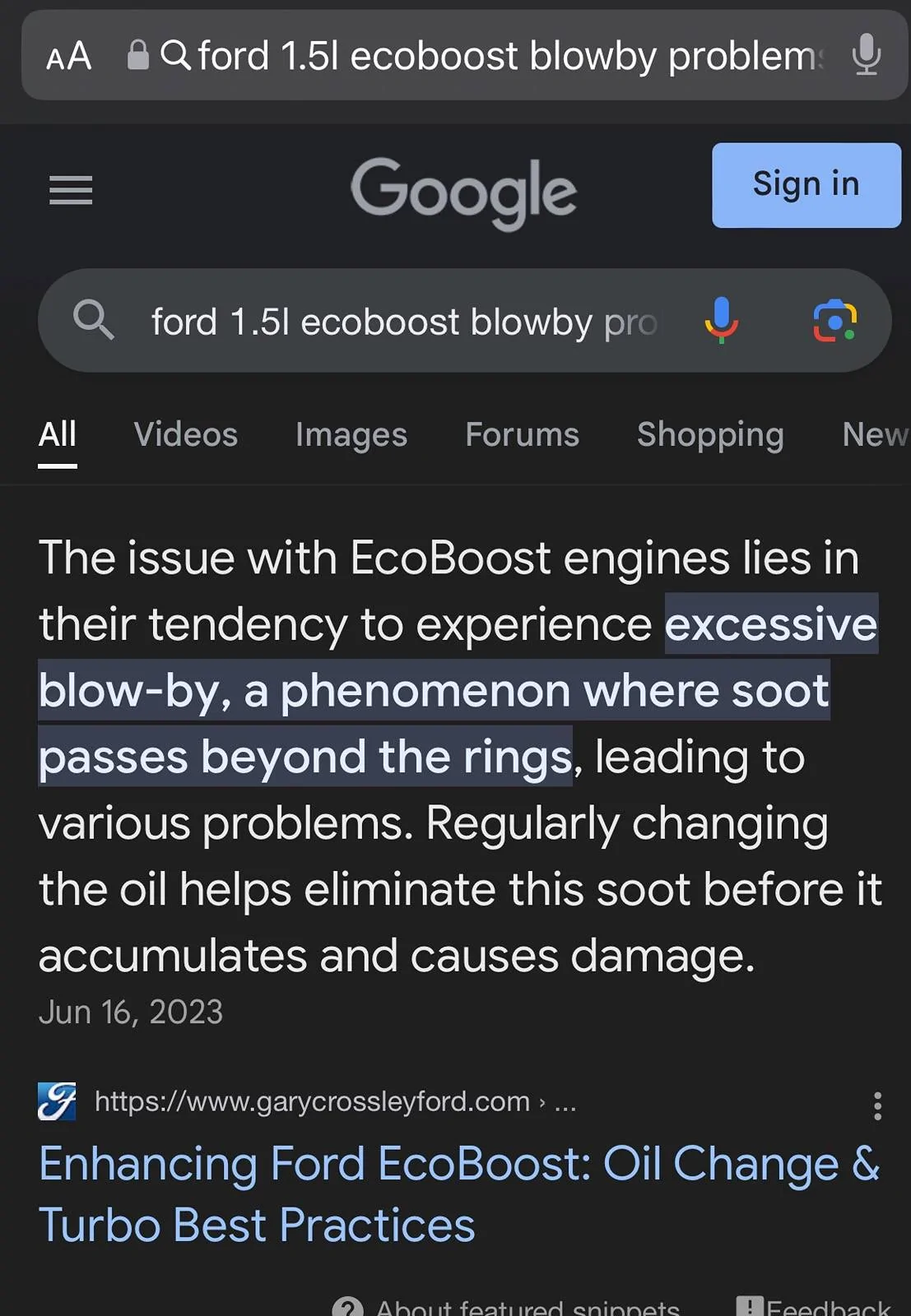

Google shows info for the 1.5L ecoboost blowby issue… didn’t research to find out if the Bronco Sport is applicable or not
Ford Bronco Sport Low oil level after 3400 miles? IMG_4493
"Google" is not a source, it's a search engine. There are several different versions of the the 1.5L EcoBoost engine. Please share the specific sources you found.
Wasn’t my original post on the topic
Just pointing out people can find information in various ways including search engines like Google and in libraries.
A prior post stated “Blow by? I have yet to hear of this being an issue in the 1.5.” without being specific to which 1.5 version.
