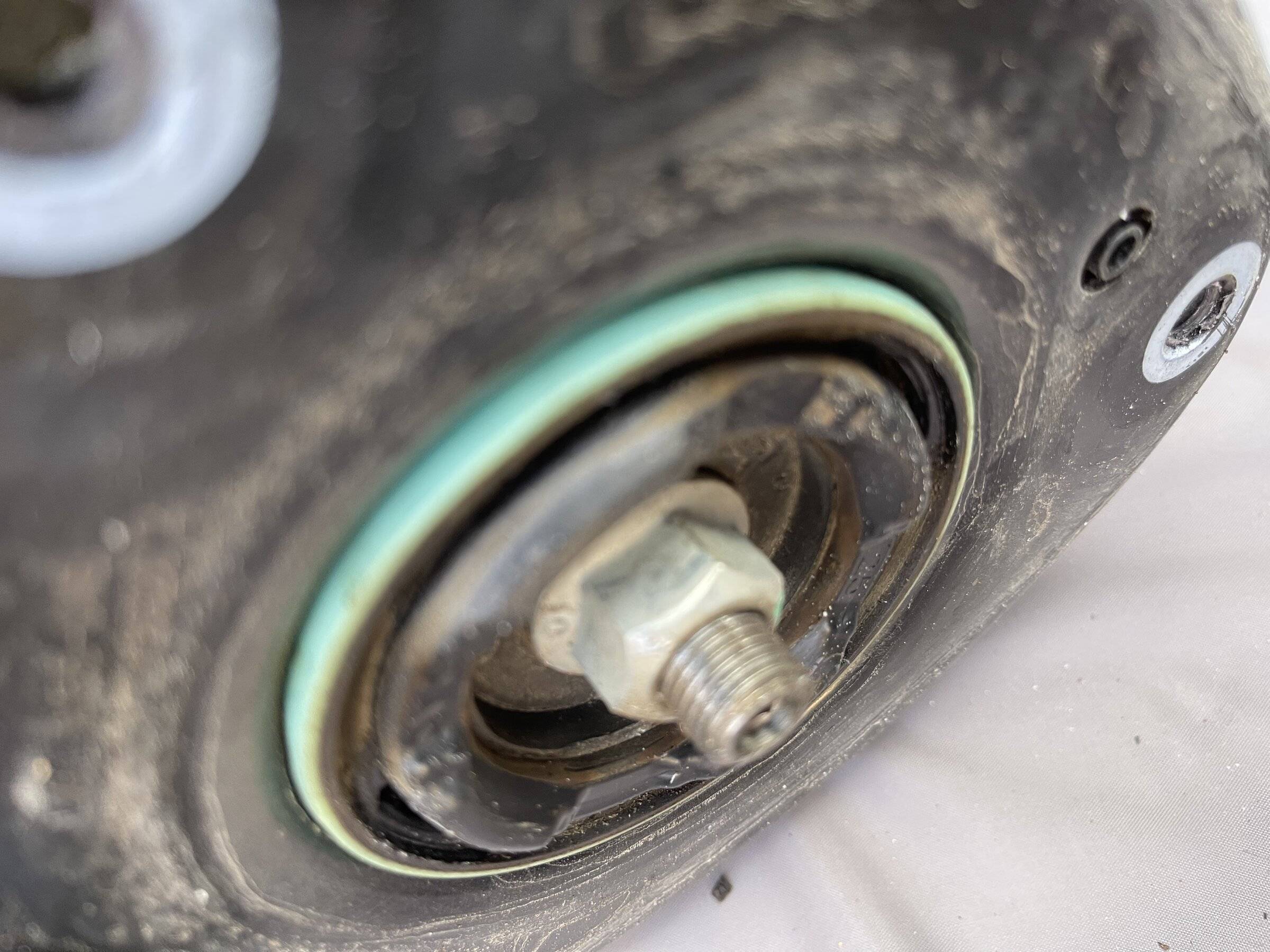

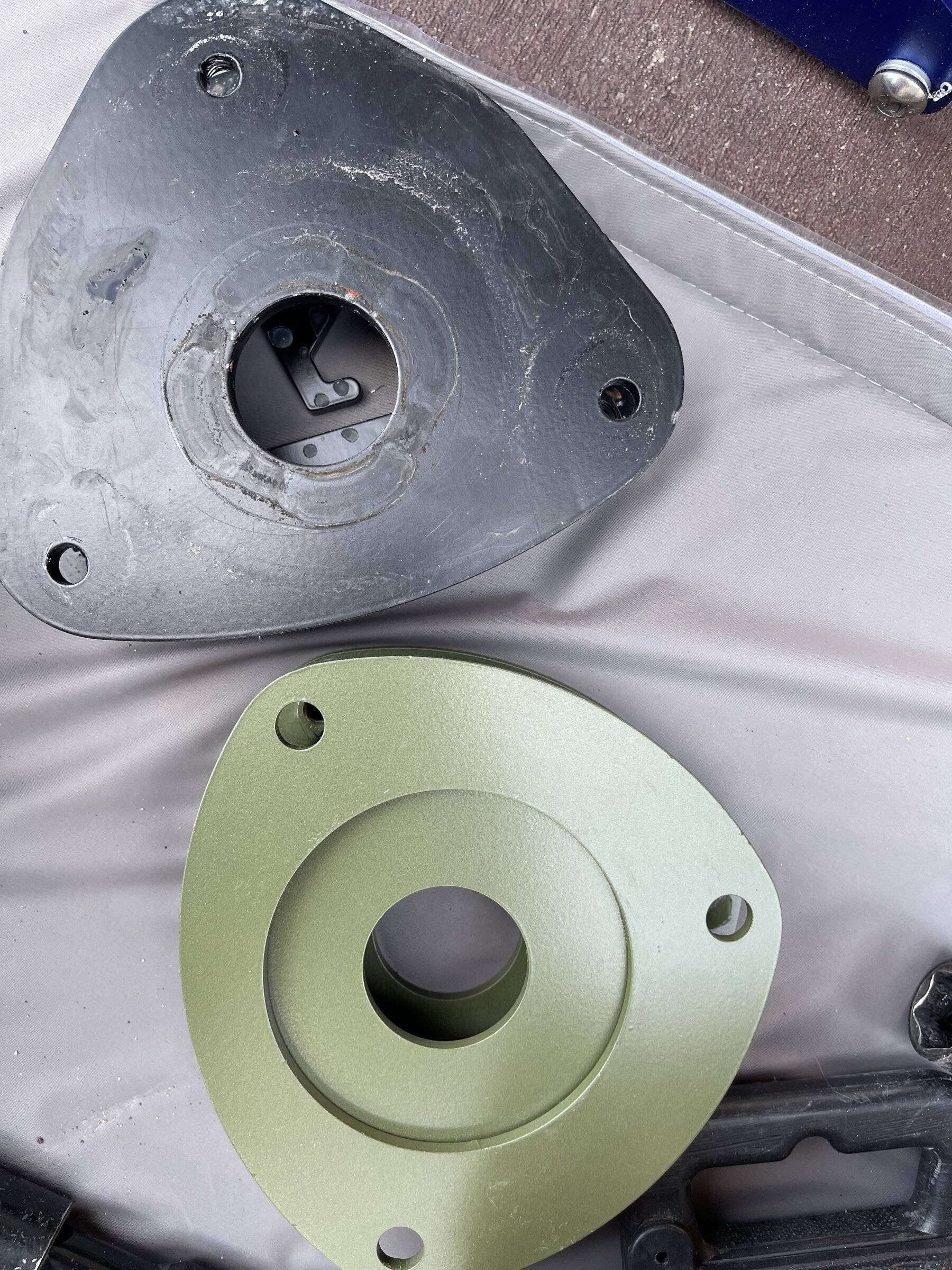

This is correct, it was not just rc lifts it was also ready lift and a few others. I had this exact problem with ready lift. The pictures show the issue the green spacer (hrg) has cut out for top of strut(strut hat) the black one readylift does not. This is what causes the clanking, the strut hat has no flex because it is compressed to the spacer
