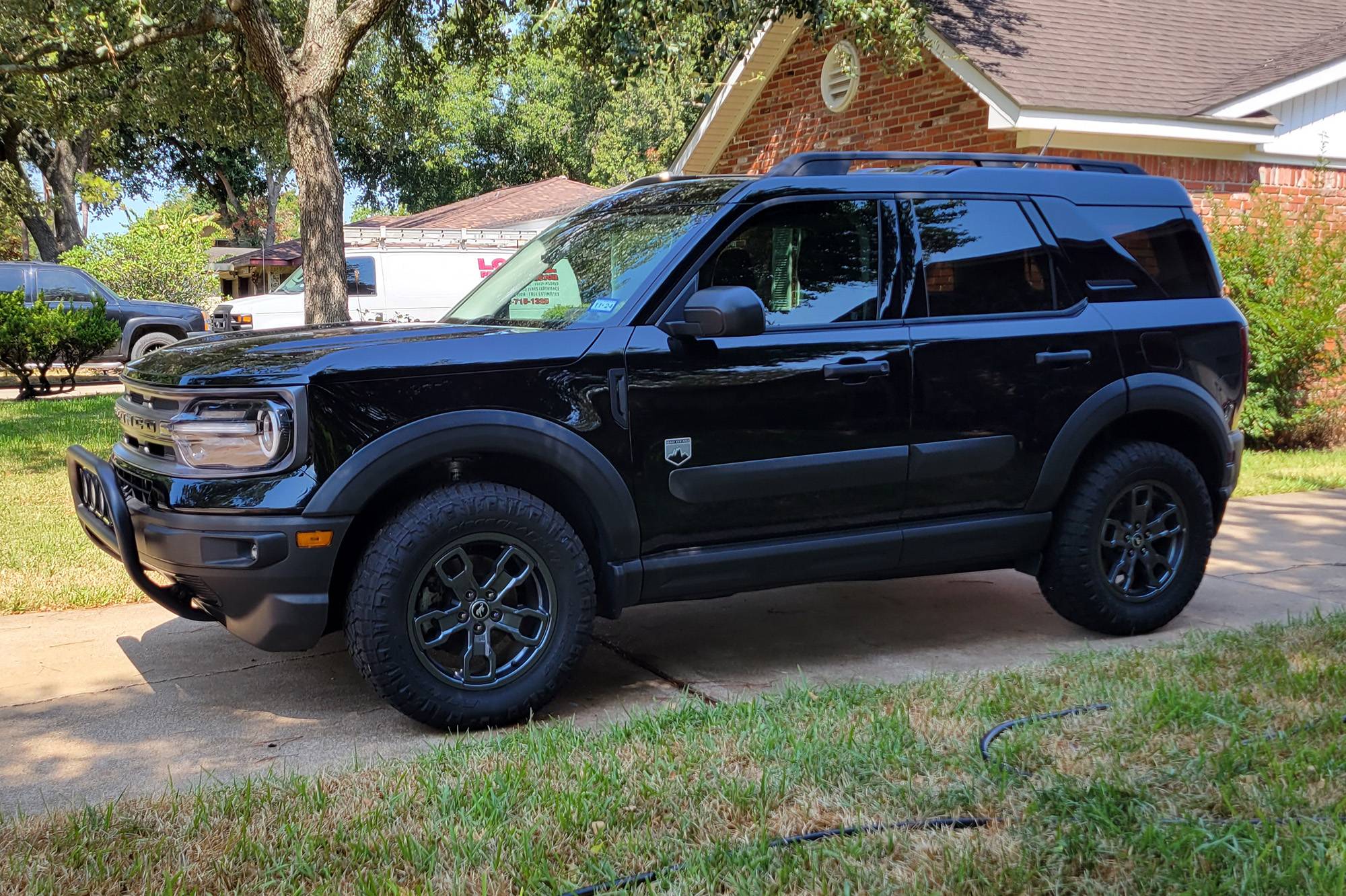

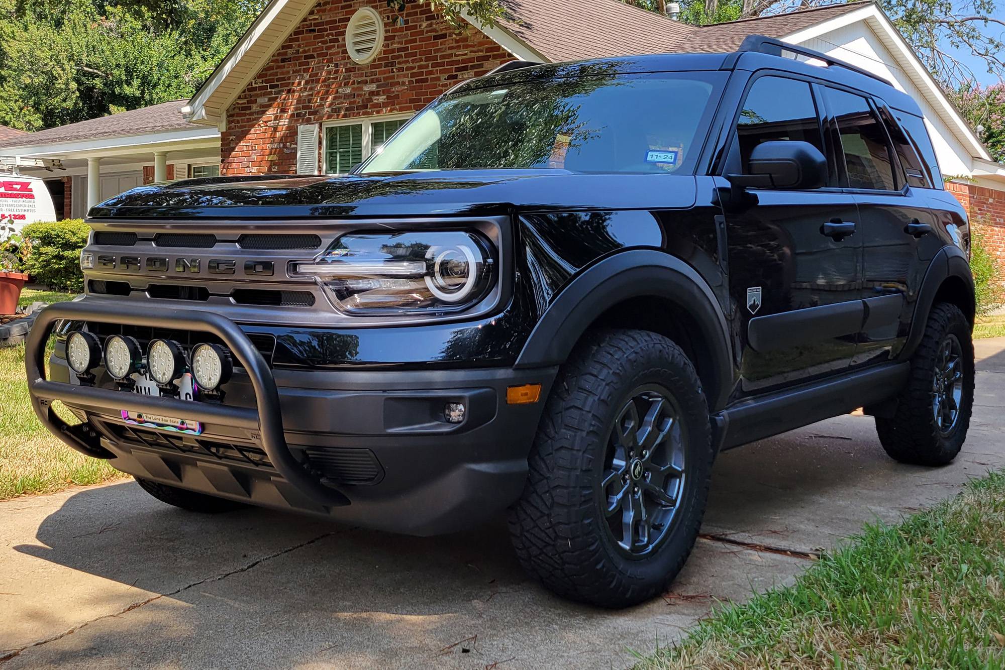

We've been happy with our RC strut/spring lift. Rides better than stock and takes bumps whoops better. The 245/65/17 Nitto Ridge Grapplers have been pretty good too. My wife daily drives this to work and has no complaints. Her offroad extent is a muddy driveway at our place in the country. But it does well there lol

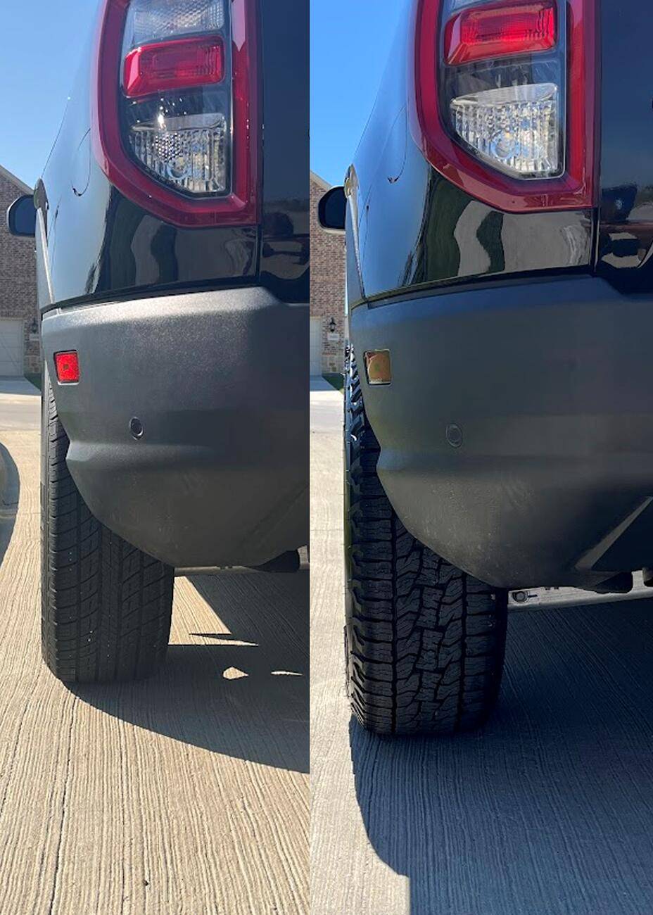

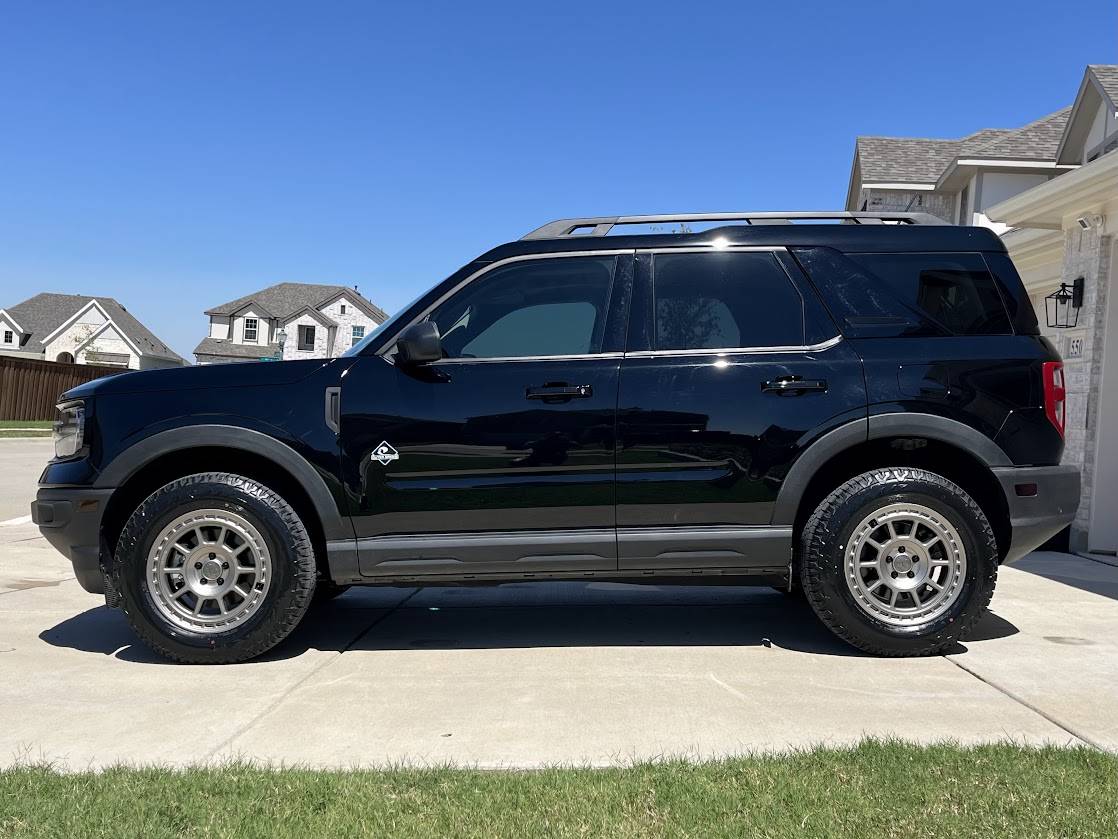

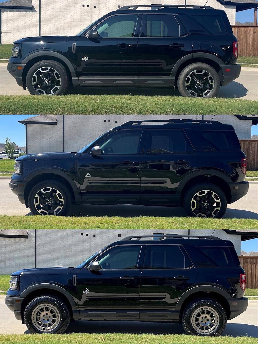

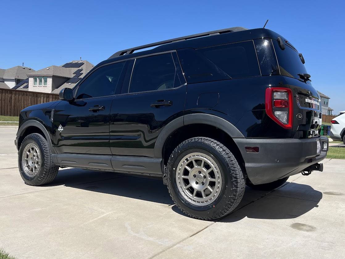

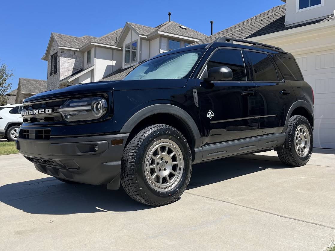

I just installed the ReadyLift SST 1.5" lift over the weekend and had Fifteen52 Traverse MX (17x8 +38) with Falken Wildpeak A/T Trail 245/65-17 installed this morning. Followed that with an alignment. Alignment was naturally off, but not crazy. Pre/post measurements in my garage show a 2" lift in the front and 1.8" in the rear with the larger diameter tires.
Stacked side shot shows stock height, lift height, and then wheels added.
Side by side front/rear shows the difference in the width of the stock 225/60-18 (on OB 18x7 wheel) vs. 245/65-17 (on Fifteen52 wheel).
