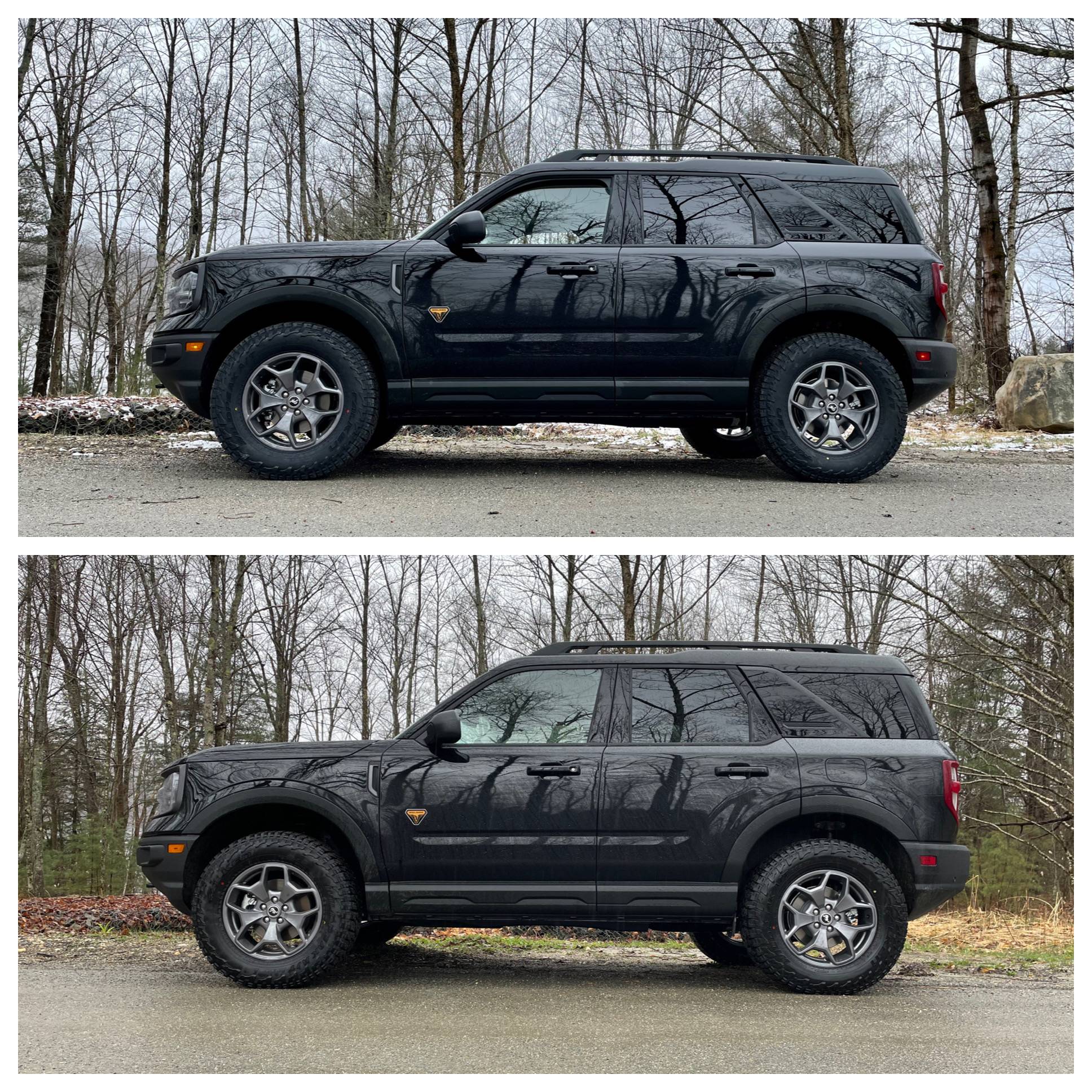

RiotfunK
Apr 10, 2022
630
544
Mass
22 Bronco Badlands
So I get more rub after the lift since the angles changed. I’ll fix this eventually.
And, it feels like a spacer lift. I’ve built enough vehicles to realize that the ride is stiffer and less compliant over chop at any speed, whoops and things are fine.
As soon as someone drops an actual suspension setup, I’m gonna pull the spacers and throw that in. Most won’t notice the difference in ride, on or off-road running spacers. But is noticeable to me especially on such a short wheelbase.
Again I’m not bashing the setup. Is nice piece of kit and does what I needed. I just need more lol. My last two builds.

RiotfunK
Apr 10, 2022
630
544
Mass
22 Bronco Badlands
I mentioned it earlier in the thread. But running the HRG kit on my badlands with 245/70/17 on oem wheels. I do not get bad scrub, but it does rub on full lock and dog legging. But not enough that I wouldn’t wheel it. I’ll see what needs to be trimmed etc. next week.

RiotfunK
Apr 10, 2022
630
544
Mass
22 Bronco Badlands
