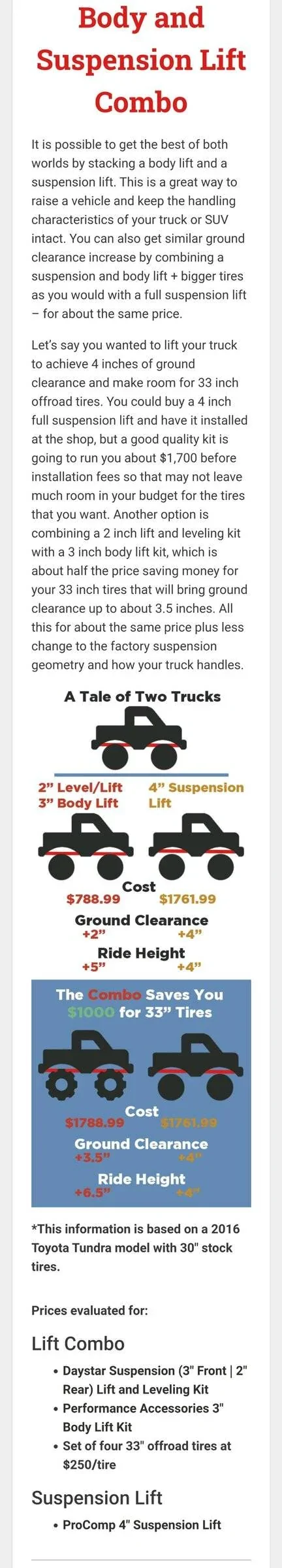

I'm gonna look into this more. A body lift and suspension might be possible.
This attachment may be outlandish because it's based on a Toyota tundra but the logistics seem tangible for the bronco sport or any 4x4 vehicle.

I don’t think you can do a body lift on the bronco sport there is no main frame . The bronco sports body and frame are all one.
Yes, unibody. Good to know?. So it's one or the other? Springs for performance or spacers for the look?
Certainly bigger tires for all-around more clearance.
