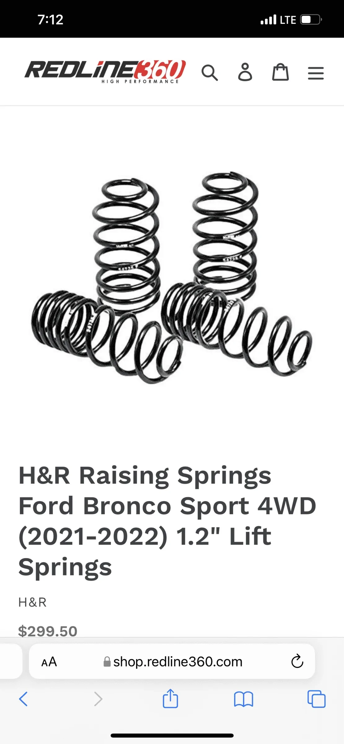

Also found these replacement springs 1.2” lift might go this way.
Ford Bronco Sport Lift Kit Compilation List C2A97AC9-C4D9-492A-96B1-476346CDDF1F
Very curious if you ended up purchasing these...

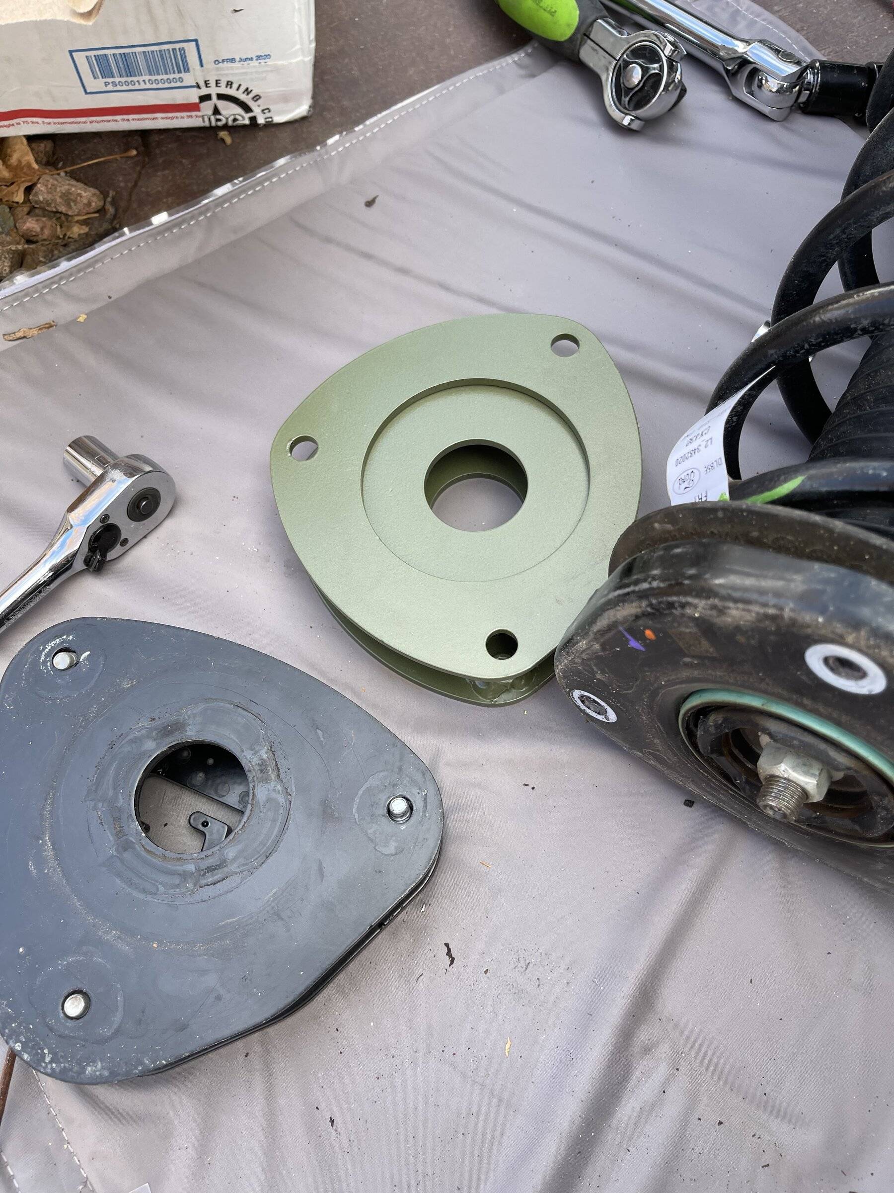

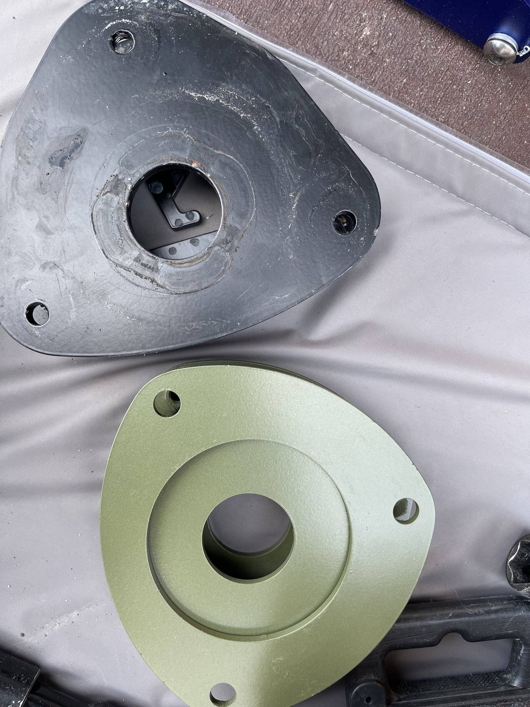

No, I ended up putting the hrg lift. Replaced the ready lift, could not believe how easy it was. This solved the strut rattle. What a difference.the ready lift kit was not the updated parts like they claimed. Here are pictures of the difference in the spacers, also came with new sway bar links not brackets to drop it. Notice the cut out for the strut hat.

That's great. Only heard good things about the hrg.

They would have to be a strut package or something. Not just springs.
I believe the kit only contains springs and nothing else. You reuse the factory struts and just replace the factory springs with the new ones. However, I would reach out to H&R to verify. There's also at least one user on the forum that has had the springs installed.
Furthermore, there's a video on YouTube that shows the installation of Eibach lift springs on a Toyota Rav4. If you watch that video, you'll notice they just replace the springs and not the struts.
Ford Bronco Sport Lift Kit Compilation List B10419D9-B831-4B56-8735-FED458E9E4AC
Ford Bronco Sport Lift Kit Compilation List 704EF705-CB03-4645-8388-508F5F0FD1FB
Ford Bronco Sport Lift Kit Compilation List 523F65BD-8BE3-4CD9-909A-3105F9A6200A
HRG Much better...
Your story is worth its own post!
Good its posted here. That info from experience is going to be helpful for people to know
