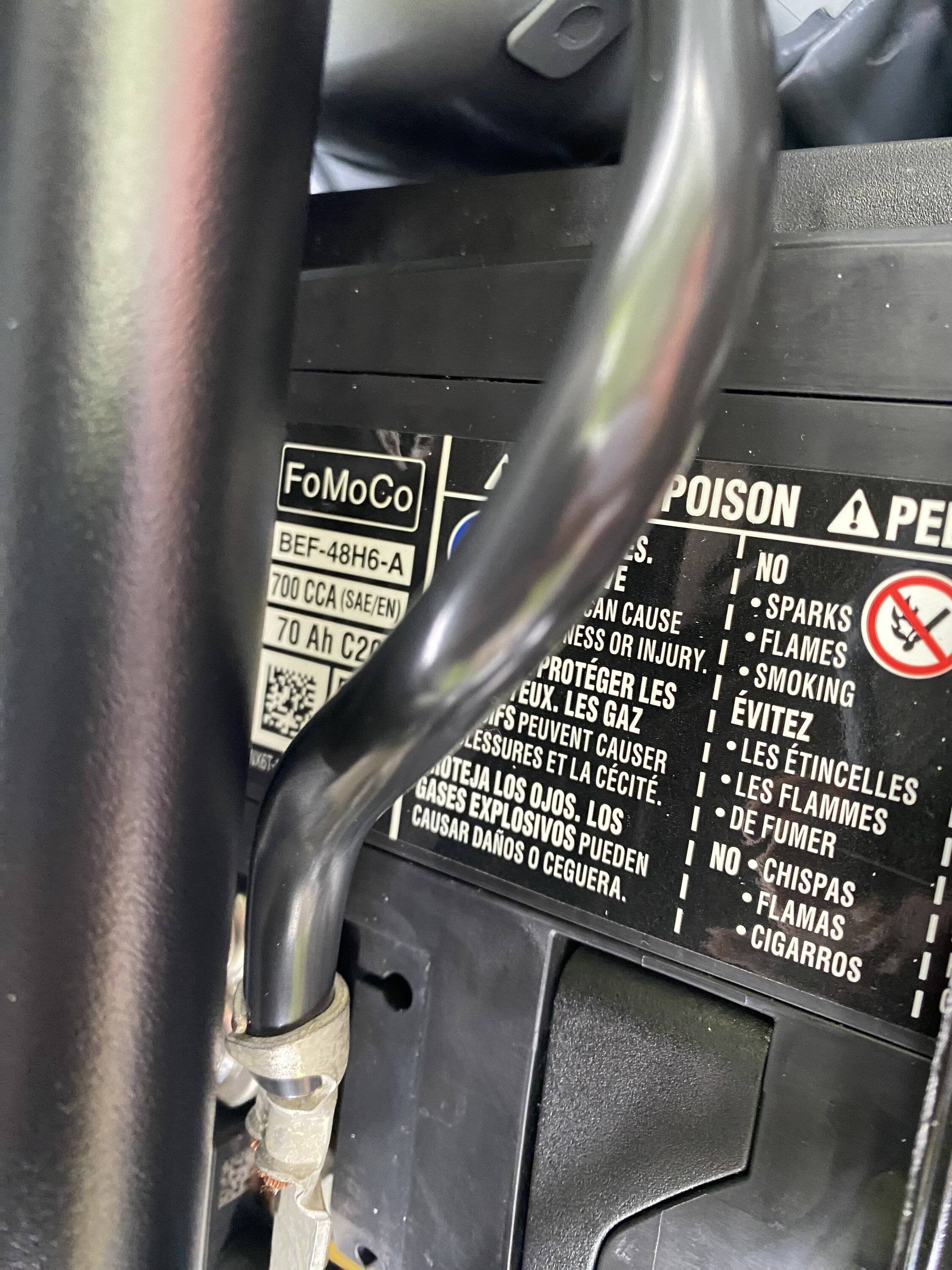

2023 Heritage trim here. Picked it up a couple of weeks ago. Mine has the BHEF-48H6-A lead acid battery.
Note: the -A suffix that appears, versus some of the battery photos in this thread . Wonder what the difference is. Looking at the Motorcraft parts website, the -A version replaces the other stock number.
Perhaps improvements in construction and/or chemistry, to address prior issues?

The OEM battery in your vehicle was supposed to be an AGM battery. I have a 21 OB and it was shipped with the AGM battery.
Ford had supply issues and could not get enough AGM batteries for the Bronco Sport and had to start using conventional lead acid batteries.
AGM is of course a newer (not "new") design, but is still a lead acid battery. My BL built December 2020 has the conventional 700A battery. I don't think I've ever replaced one without noticing degraded performance first, but replacement is normal to expect after a time. But, you can spend more on an AGM and less time and effort replacing them.
Note: the -A suffix that appears. Looking at the Motorcraft parts website, the -A version replaces the other stock number.
Can also just be a different vendor for the battery. Ford doesn’t generally state what the change is when a part number is changed.
