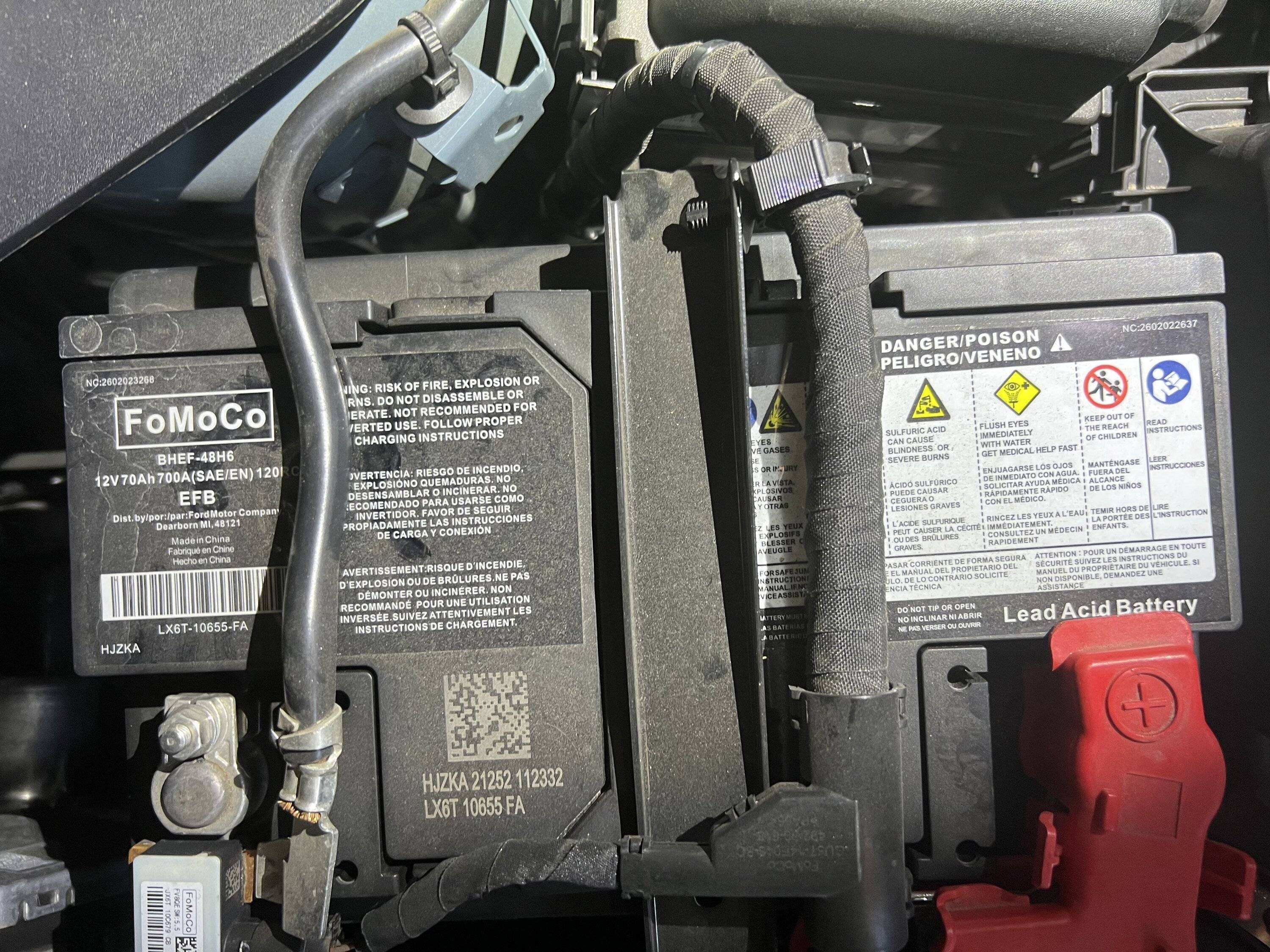

An after thought. How can I tell if my 23 battery is an AGM?
Info on the top of your battery will tell you.
Examples: (not a complete list)
BEF-48H6-A,
BEF-48H6,
BHEF-48H6
Lead-Acid
EFB: Enhanced Flooded Battery
BAGM-48H6-760 (AGM)
AGM: Absorbent Glass Mat
