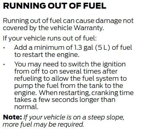

Check your owner's manual:
Ford Bronco Sport Fuel warning 1724335665297-8
The requirement to add at least 1.3 gallons tells me that much is required to provide adequate cooling for the pump.
