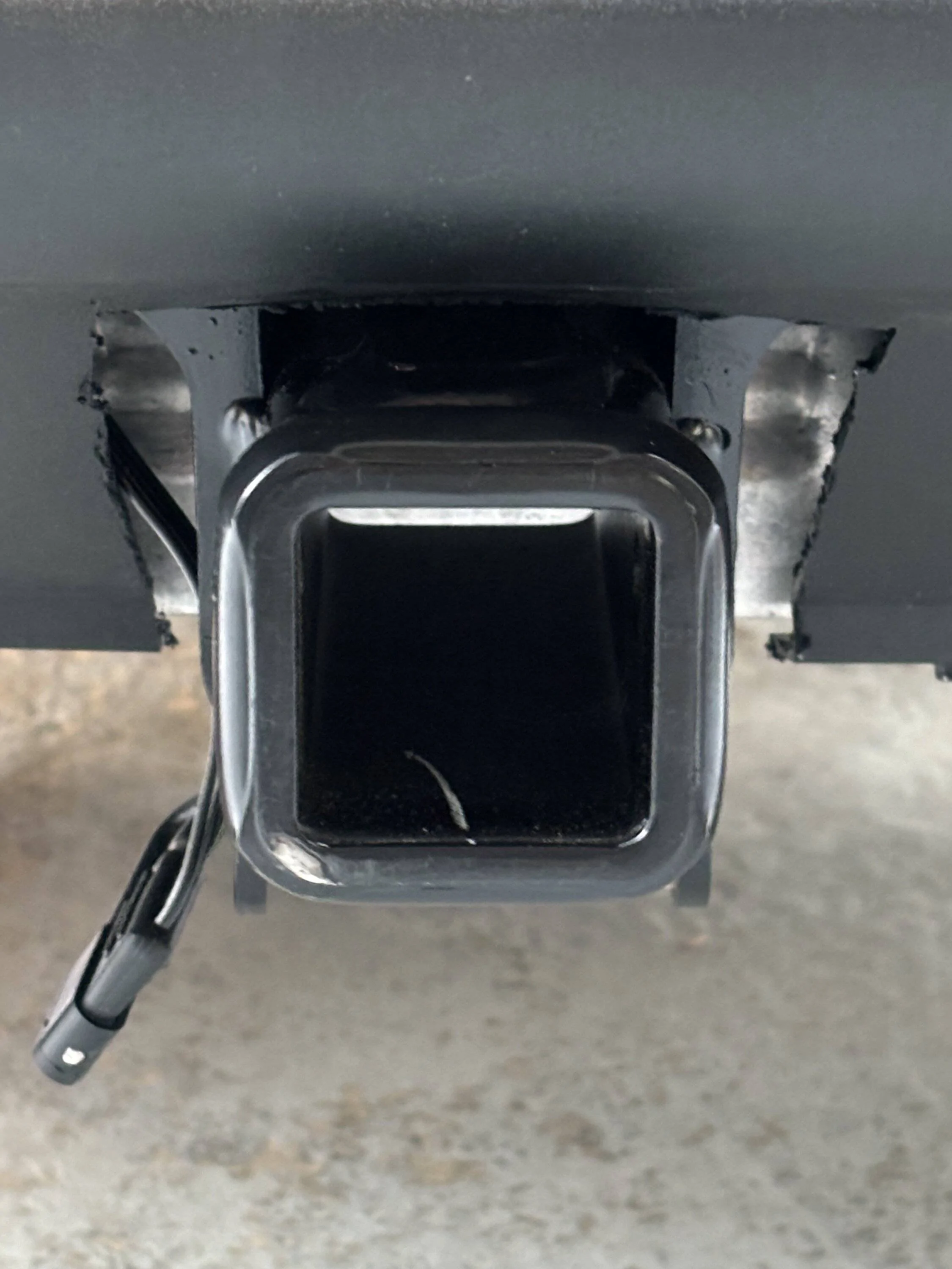

I installed the factory hitch on 12/9/23 and followed a youtube video of a different hitch install that required the same procedure. Only thing, I had also ordered the Ford Factory wiring harness, but you have to splice into wires with the OEM wiring. I actually bought a Tekonsha T-One plug and play wiring harness. Only thing I had to do was run the power wire from the rear to the front under the suv. Was really easy. The picture you have there is what you would have gotten if you ordered it with the factory hitch. The bumper can be bought, if it's in stock or buy used. I opted to just cut out for the hitch itself and leave the wiring harness part behind the bumper.
