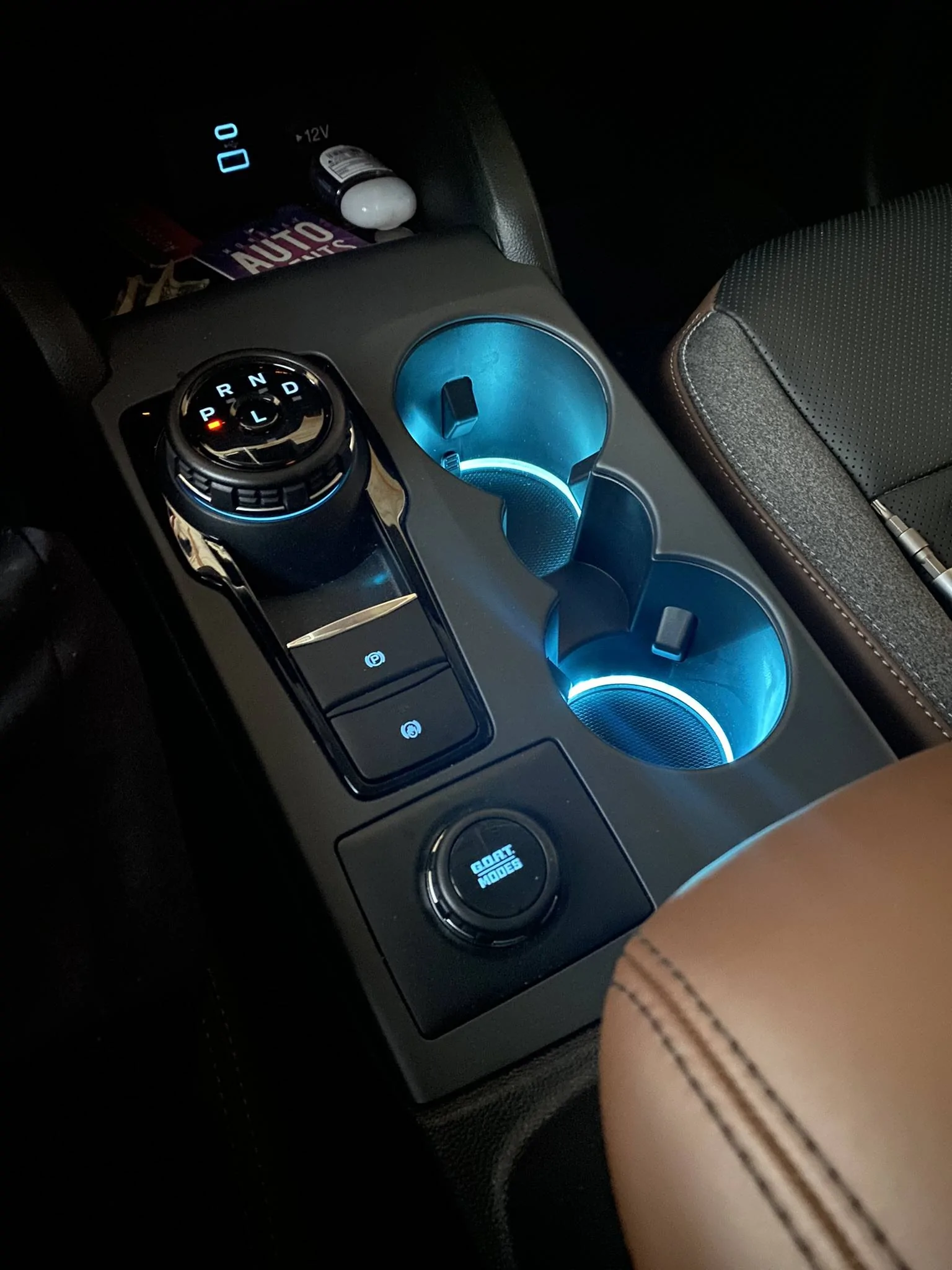

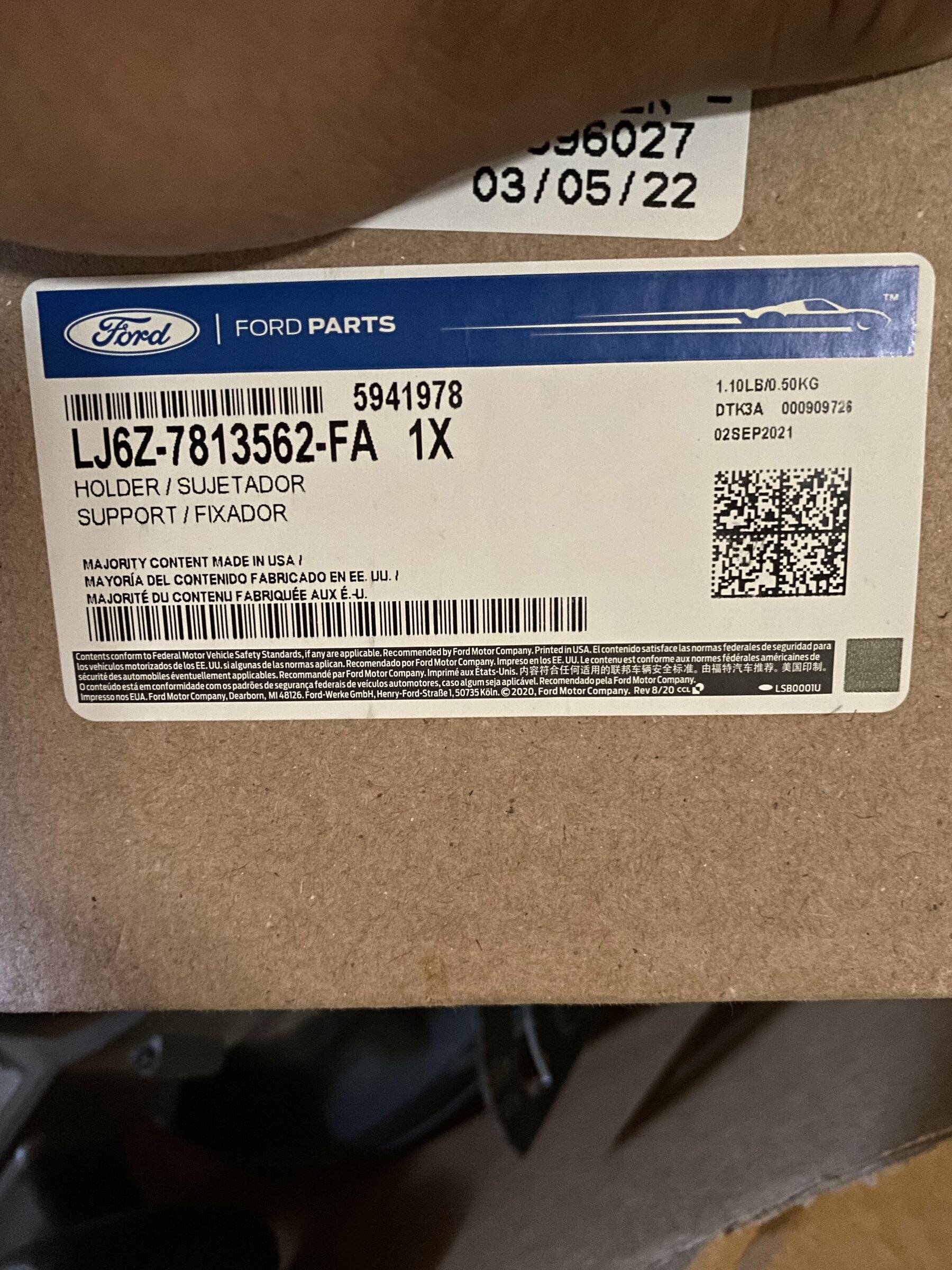

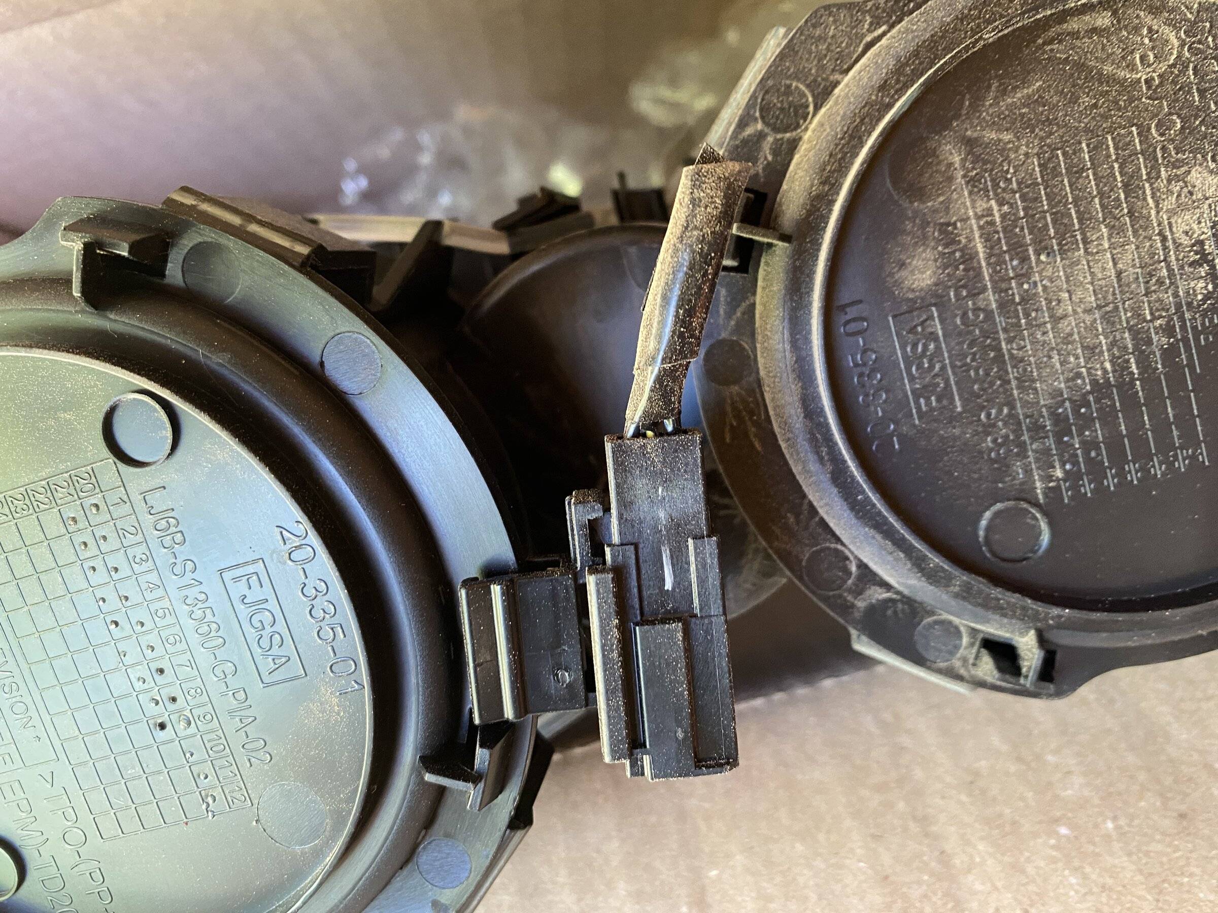

Hi ya’ll I’m new to the forum, but wanted to share a little bit of my BB experience. I got my Cactus Grey Outer Banks on December last year and noticed the cup holder wouldn’t illuminate like in other ford models. I contacted several dealers and all said the cup holder didn’t come with ambient lighting. After removal of cup holder I found wires cut and pre-set for ambient lighting, so I started my research. I ended up finding that the 2020+ Escape cup holder fits which has ambient lighting. Part #LJ6Z-7813562-FA. Now I have the full ambient lighting inside my Outer Banks and if you want to add it here it is! Attached are pics of originally equipped cup holder and the cut wires, part number, and finished product.

I have the part, but not the plug on my 2022 OBX built on 7/4. DM me if you are interested in the part. Paid $34.18, just add shipping to your neck of the woods and it’s yours.
