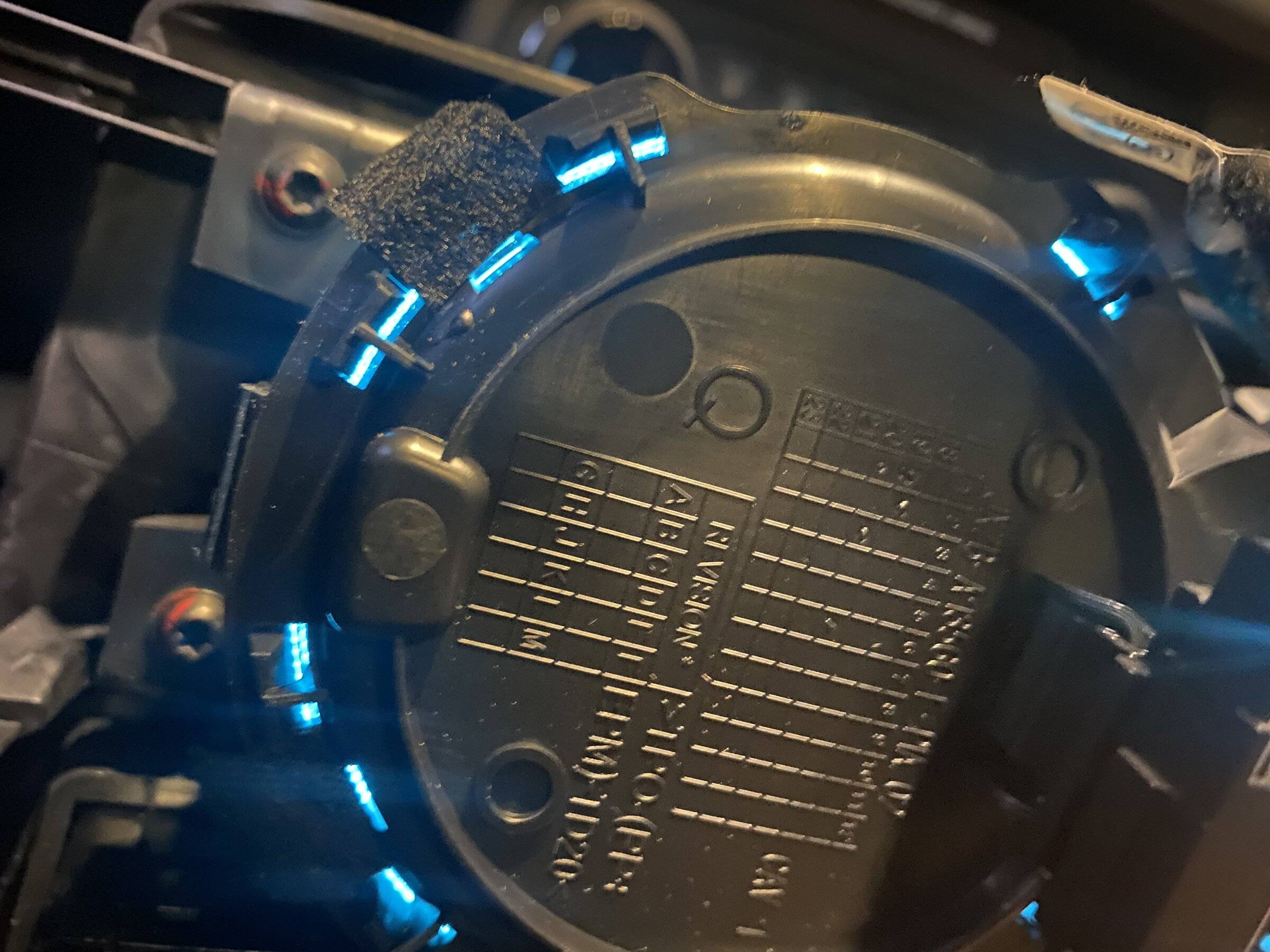

Then you will pry it out from the front first as there are tabs in the back that lock it in place.
Ford Bronco Sport Cup Holder Ambient Lighting 9BDCFCB2-8B77-4ABE-9D32-E4AA9EFA1114
Ford Bronco Sport Cup Holder Ambient Lighting 5ED91C4F-5FD7-4E8A-974E-85412AAAE0E4

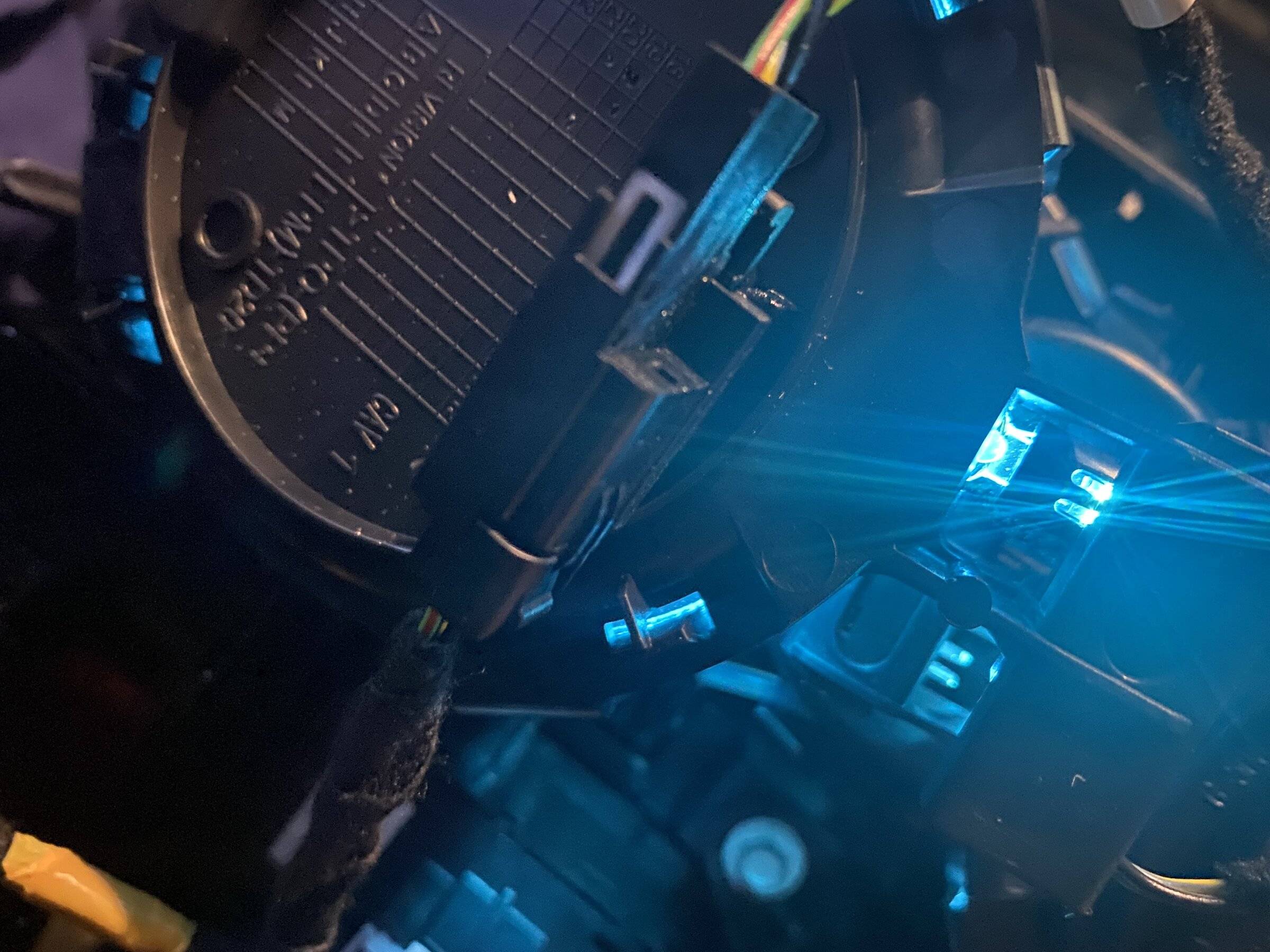

After removal of trim, flip it around on a side (optional to disconnect every connector if you want more wiggle room). I didn’t disconnect any other connector besides the pre-wired cup holder connector.
Ford Bronco Sport Cup Holder Ambient Lighting 024D6758-8144-4DAC-834B-AF56D14BDF62

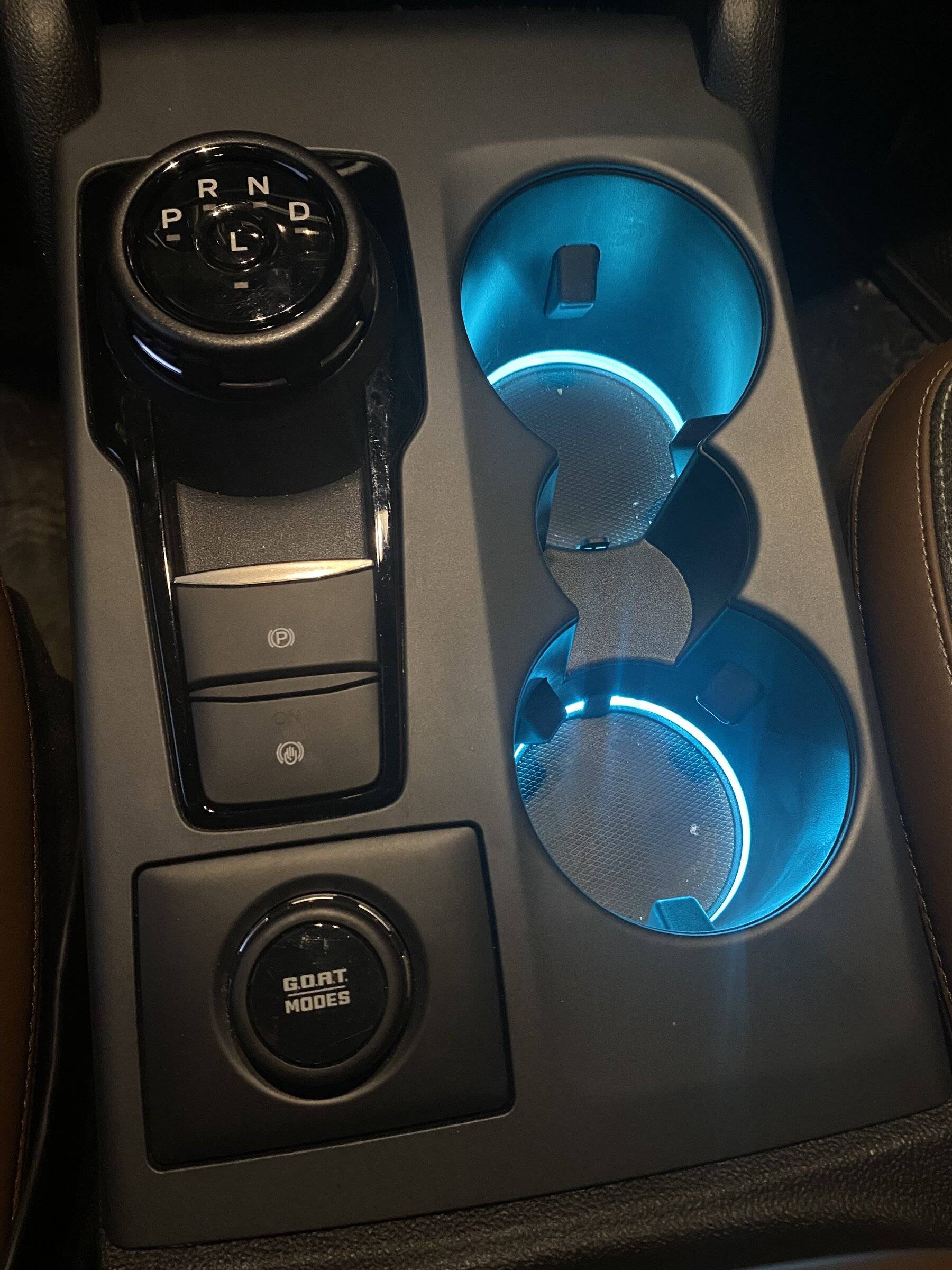

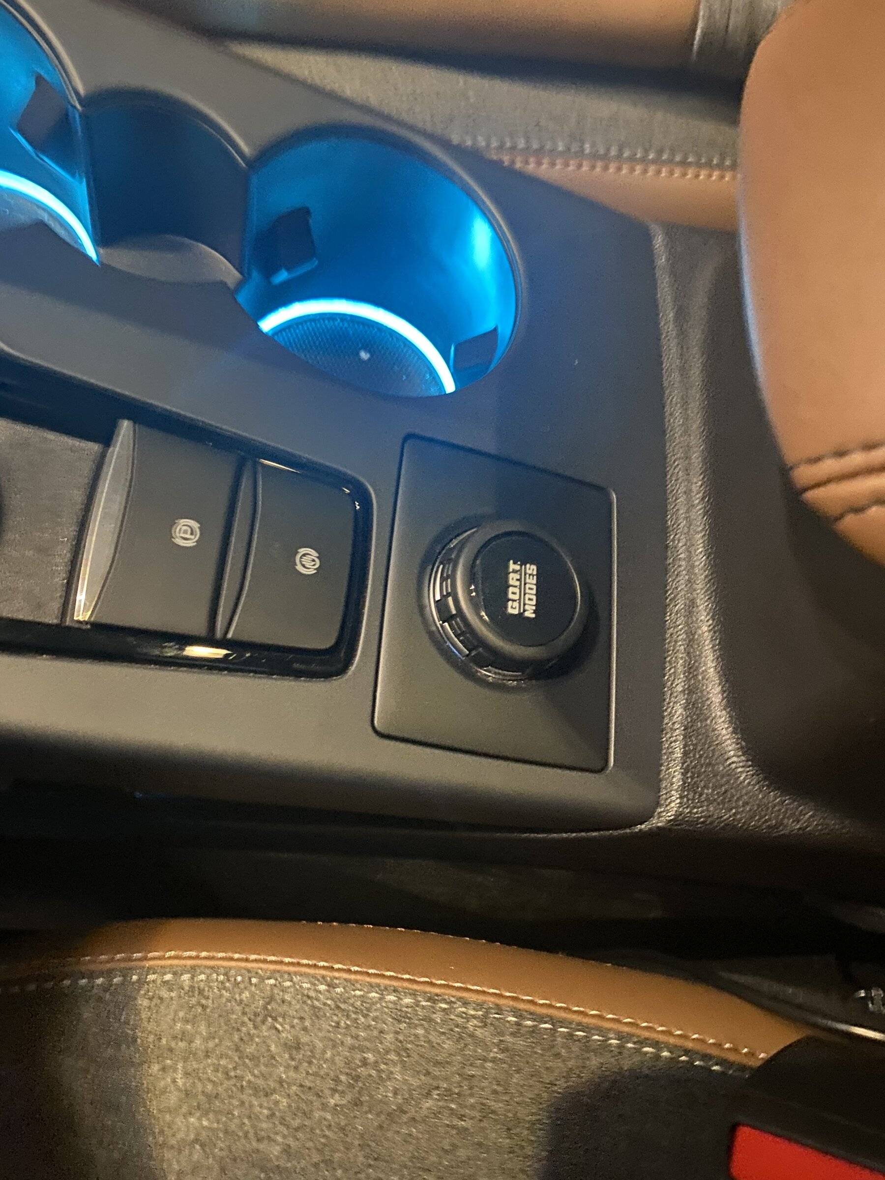

Once that is disconnected you can go ahead and remove the 3 T25 Torx screws holding the cup holder in place. Once removed just wiggle it off and remove it then install the new ambient lighting cup holder in its place and reconnect connector and snap it back and place and enjoy!
Ford Bronco Sport Cup Holder Ambient Lighting BD052064-3D58-4F4E-8094-669F801944DB
Ford Bronco Sport Cup Holder Ambient Lighting F657D6BE-9D04-4AB5-B6A9-2A1F78E7E11F
Ford Bronco Sport Cup Holder Ambient Lighting A45459F2-F023-4196-B227-A101492584F7

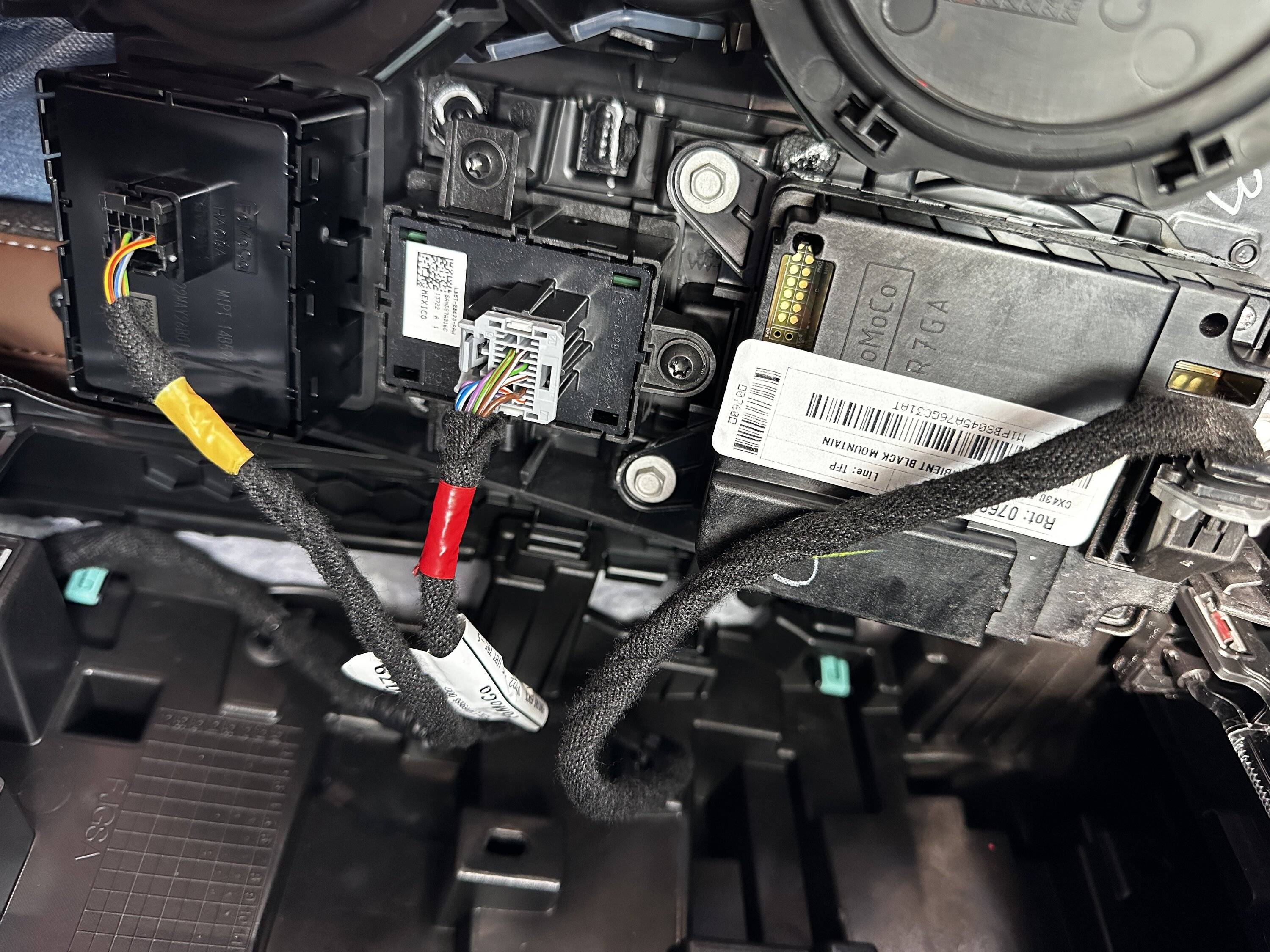

I have a 2022 OBX and there is no connector inside, pic below. Any suggestions?
Ford Bronco Sport Cup Holder Ambient Lighting C850C55E-C76F-4B9C-8E95-B129D78091B8
Try using a volt meter and get a readout for a wire that gets power when your lights are on or if you want to get technical I’m pretty sure you could tap into the footwell lighting.

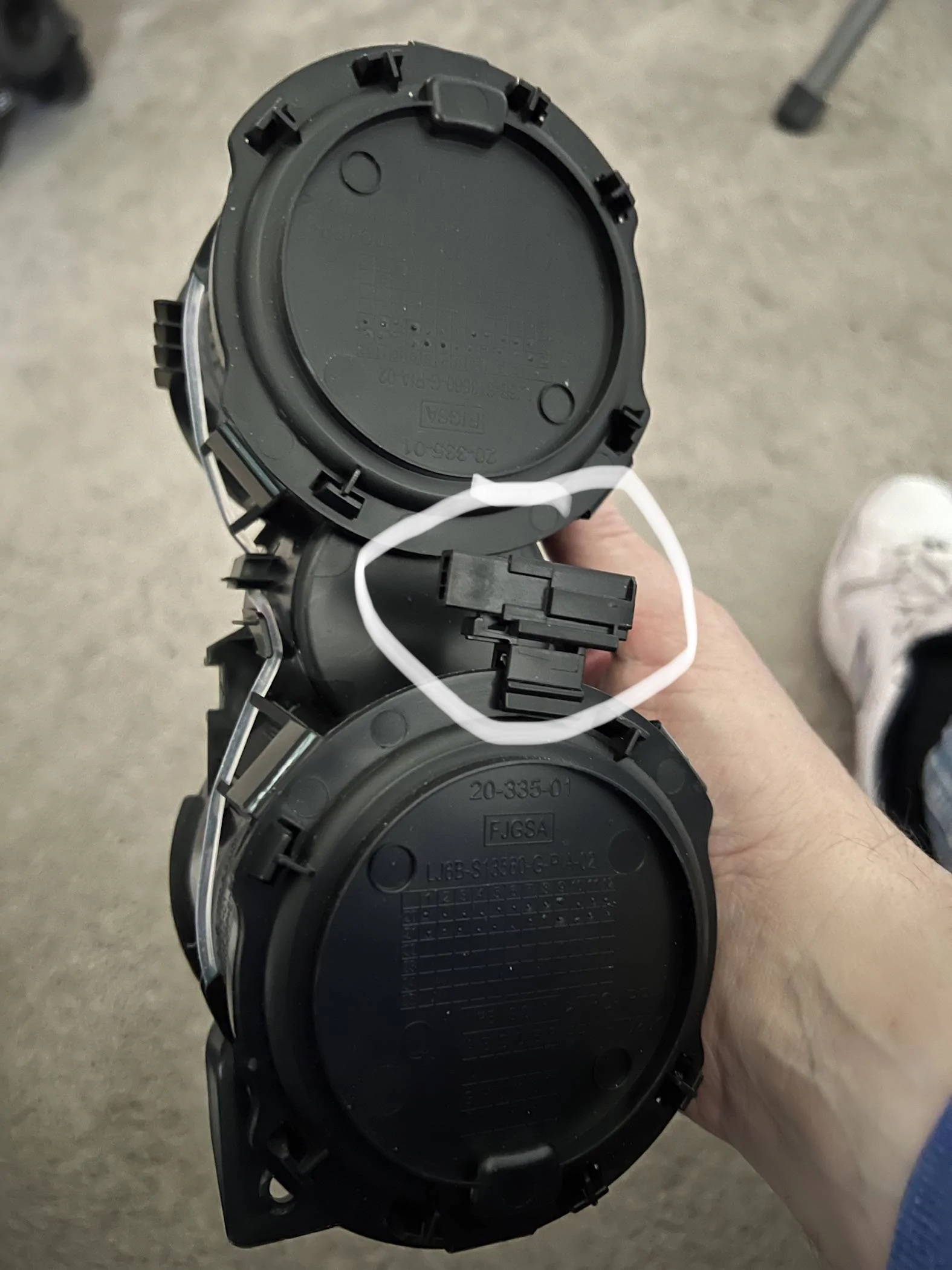

If you look at the bottom of your cup holders, if there is a wiring harness plugged into the circled location in the picture, that's the wiring you need. It unplugs from there and plugs into the ambient lit cupholders.
Ford Bronco Sport Cup Holder Ambient Lighting 7857706D-4DF7-4FCF-BA18-05AD3BF5FDD3_1_201_a
Just want to ask a quick question. So if I understand everything there is a wire and harness in the console once the shifter cover is removed that the new cup holder will hook into?
Yes and no. Depends on when it was built. Mine was built in January and had the wiring. Another member has one that was built in February and didn't have the wiring. If yours is a recent build, you probably don't have it. I checked mine before I ordered the new cup holder.
