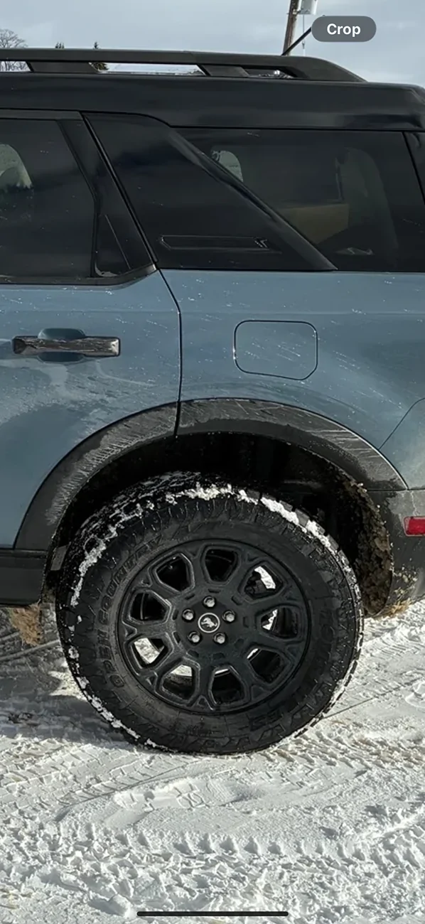

In trying ti sell my old shocks and struts in the for sale section, Canada
Bad luck here with the b8 I will create a post to explain my issue but was a factory problem .
Ford Bronco Sport Bronco Sport Badlands - Lift Options IMG_6459
It looks like your swaybar link is bent

@Garth Trying to determine if what I think I'm seeing is accurate. Looks like the bracket that WAS welded to the strut that the sway bar link attaches to broke off. Is that correct? If so, I assume it was a poor weld. Is that a factory strut?
