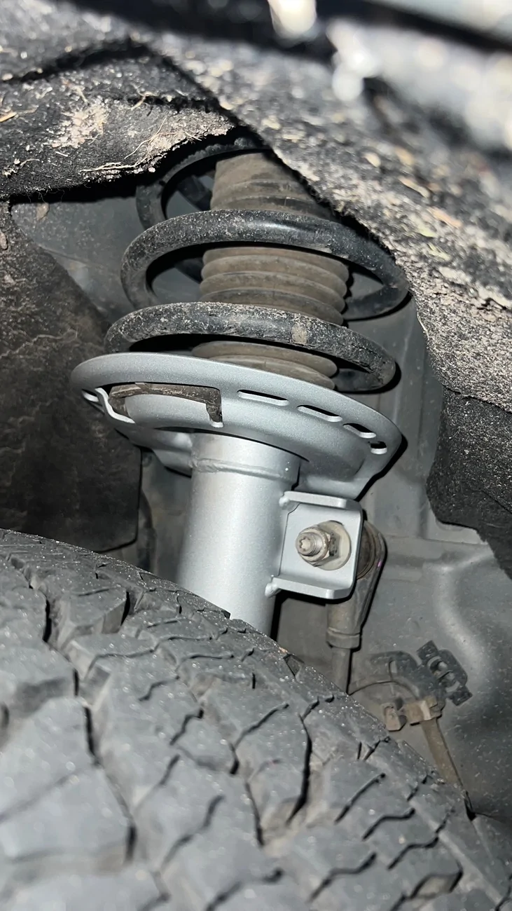

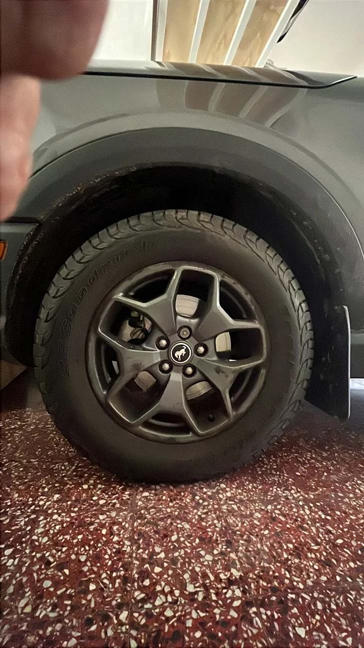

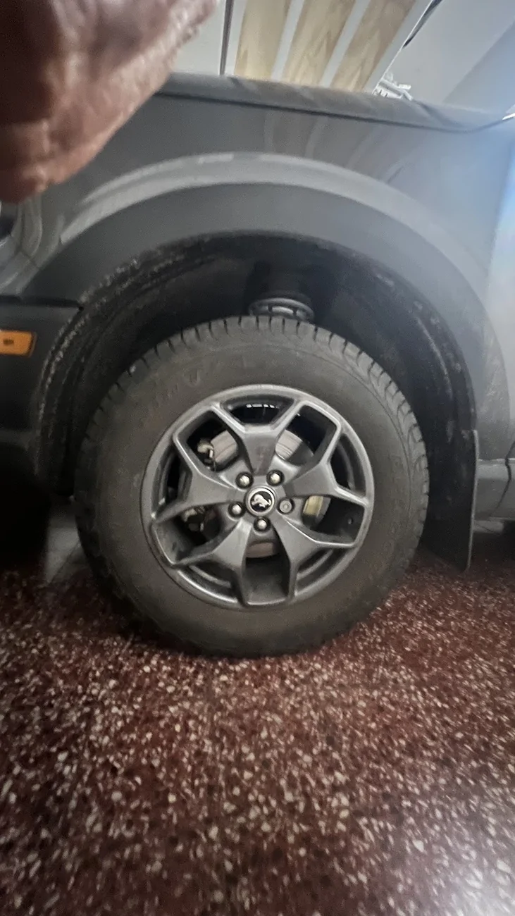

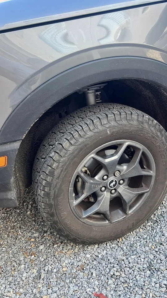

How does it feel?
⚙ 1️⃣ Typical Measurements for the Bronco Sport with Bilstein B8 TerraSport
Before the lift (stock, 225/65R17):
Front ≈ 10 cm · Rear ≈ 11 cm
After installing Bilstein B8 TerraSport + 235/65R17 tires:
➕ Bilstein adds about 32 mm (1.25")
➕ Tires add about 6 mm
🔹 Expected result: Front ≈ 13–14 cm · Rear ≈ 14–15 cm
The drive feels just the same on-road — smooth and stable. I’ll be heading to Patagonia soon to really test it on gravel and mud. I’m pretty sure it’s going to perform way better than the OEM setup.
