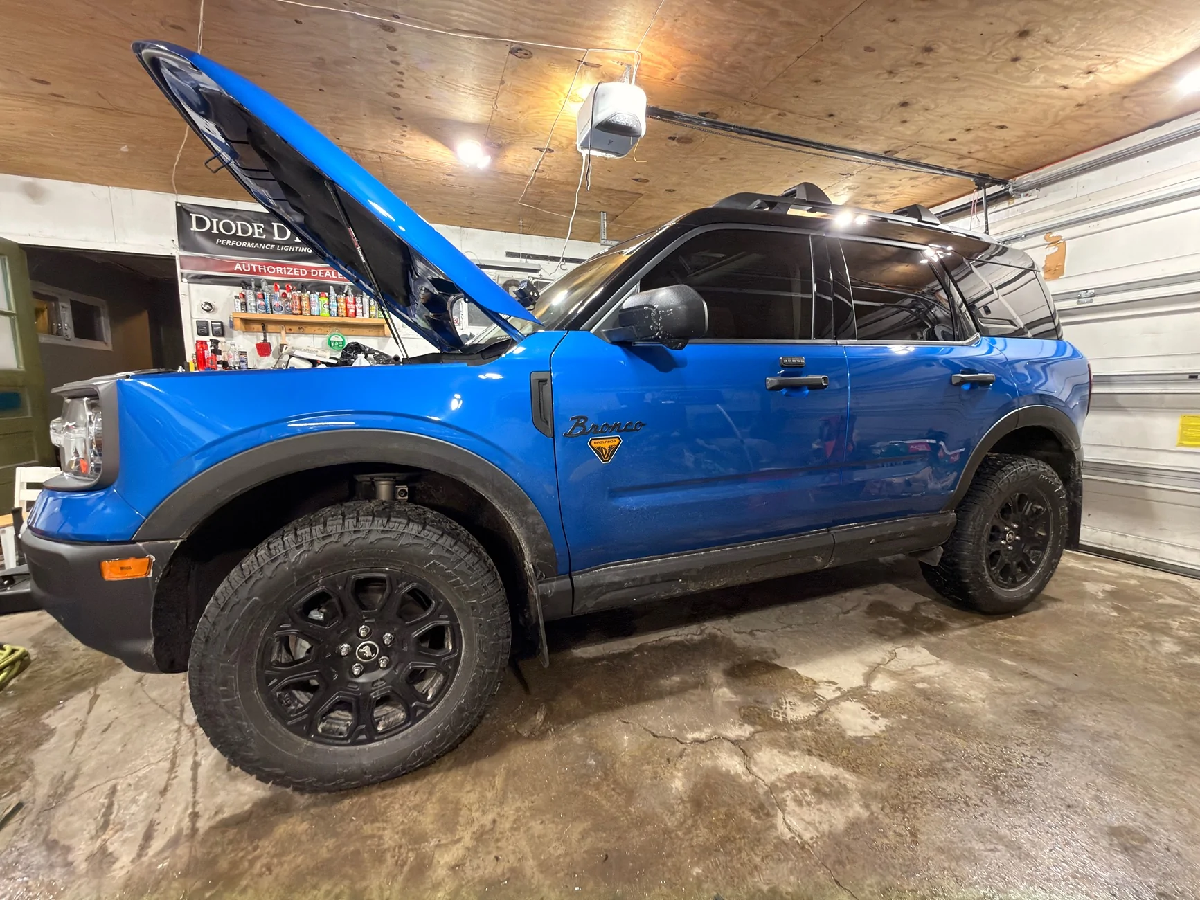

Fronts are in. Not a bad job, two hours start to finish, wish I had started sooner so I could do the rear tonight, but I’m doing them in the morning.
Looks great. I did mine across a couple evenings, too. Had an appointment i had to break for one night.
PS. Did you check the welds for the brackets that the sway bar end links attach to? 😀
Frenchy906
Dec 10, 2025
402
1,022
2025 Bronco Sport Badlands
Mine all look solid. That was the first thing I checked after seeing the post the other day lol

Ford Bronco Sport Bronco Sport Badlands - Lift Options IMG_2493
All done. Camber was spot on afterwards in the front. The rear is 0.1° out of spec on the driver side, perfect on the passenger side, so I’m not messing with it. The toe in front was all wack, but that’s fixed now. Rides so nice.

Did you use after market camber bolts?
