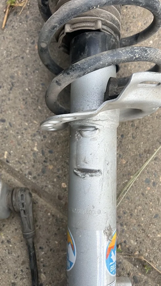

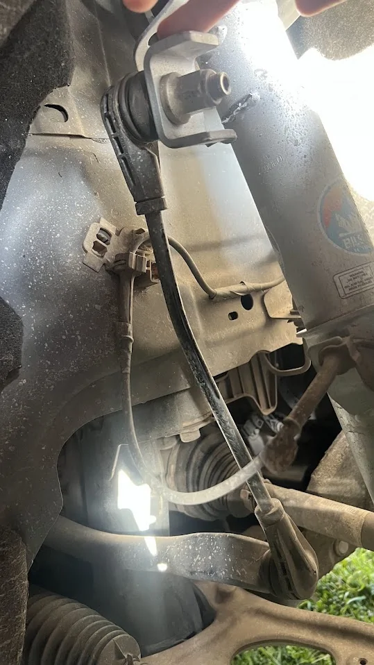

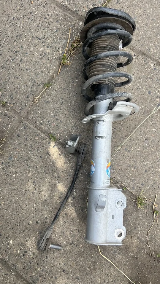

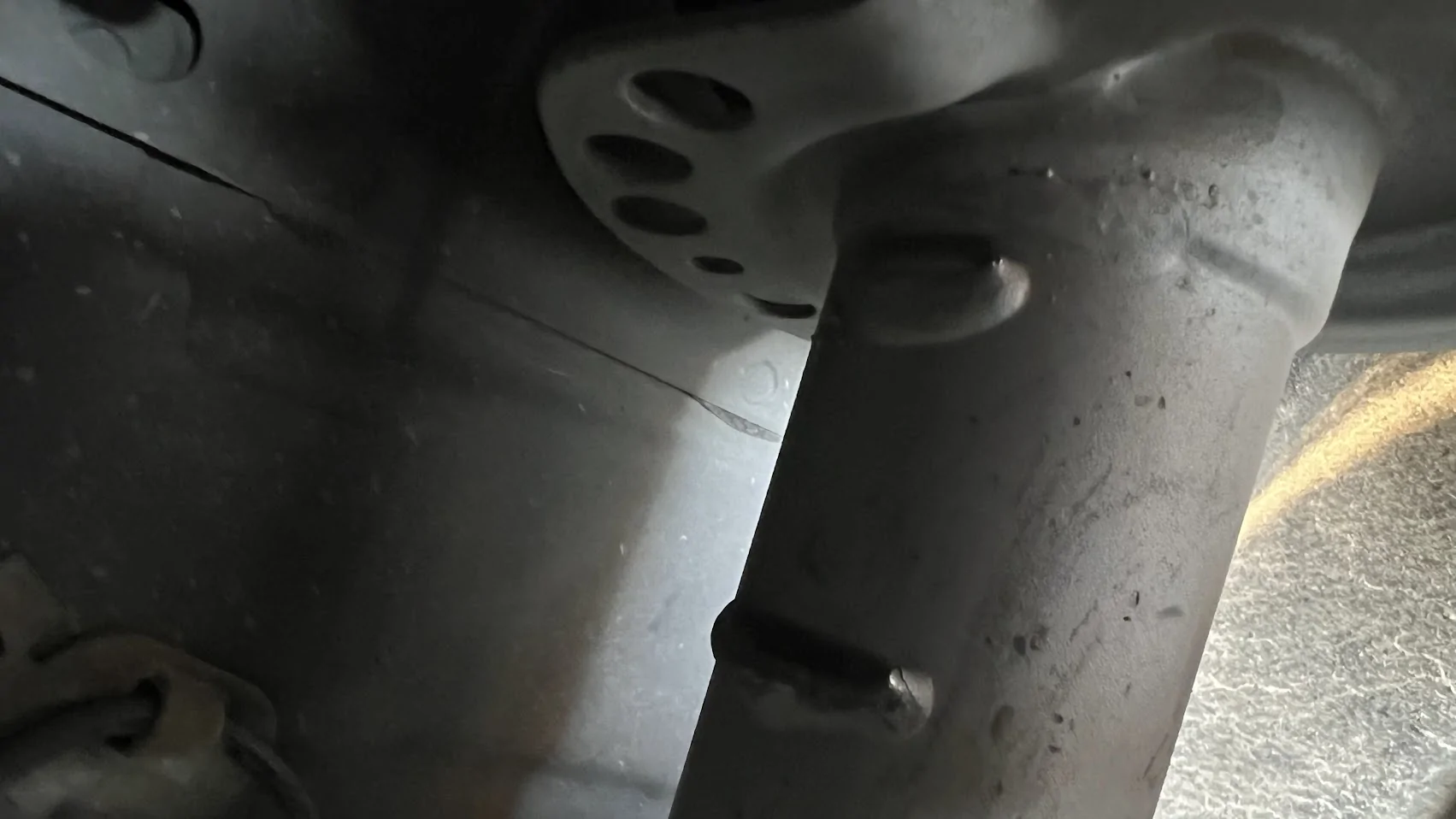

@Garth Trying to determine if what I think I'm seeing is accurate. Looks like the bracket that WAS welded to the strut that the sway bar link attaches to broke off. Is that correct? If so, I assume it was a poor weld. Is that a factory strut?
Weld for end link tab broken, end link bent, and no not factory strut

Yes the bracket broke off, this is a Bilstein B8 terra-sport aftermarket strut. I have just installed a set on my 25BL, I will look closely at mine when I get home tonight. Dosent look like much of a weld
Good catch, it was a poor weld. :facepalm: .. I bought a stabilizer link , Bilstein never answers me ...

- I lost the warranty because Bilstein wants my shock, but I need to send it to the US haha, and that's the problem. Although I'm driving without issues, a replacement is coming to my house this week. And of course, I bought two stabilizer links.

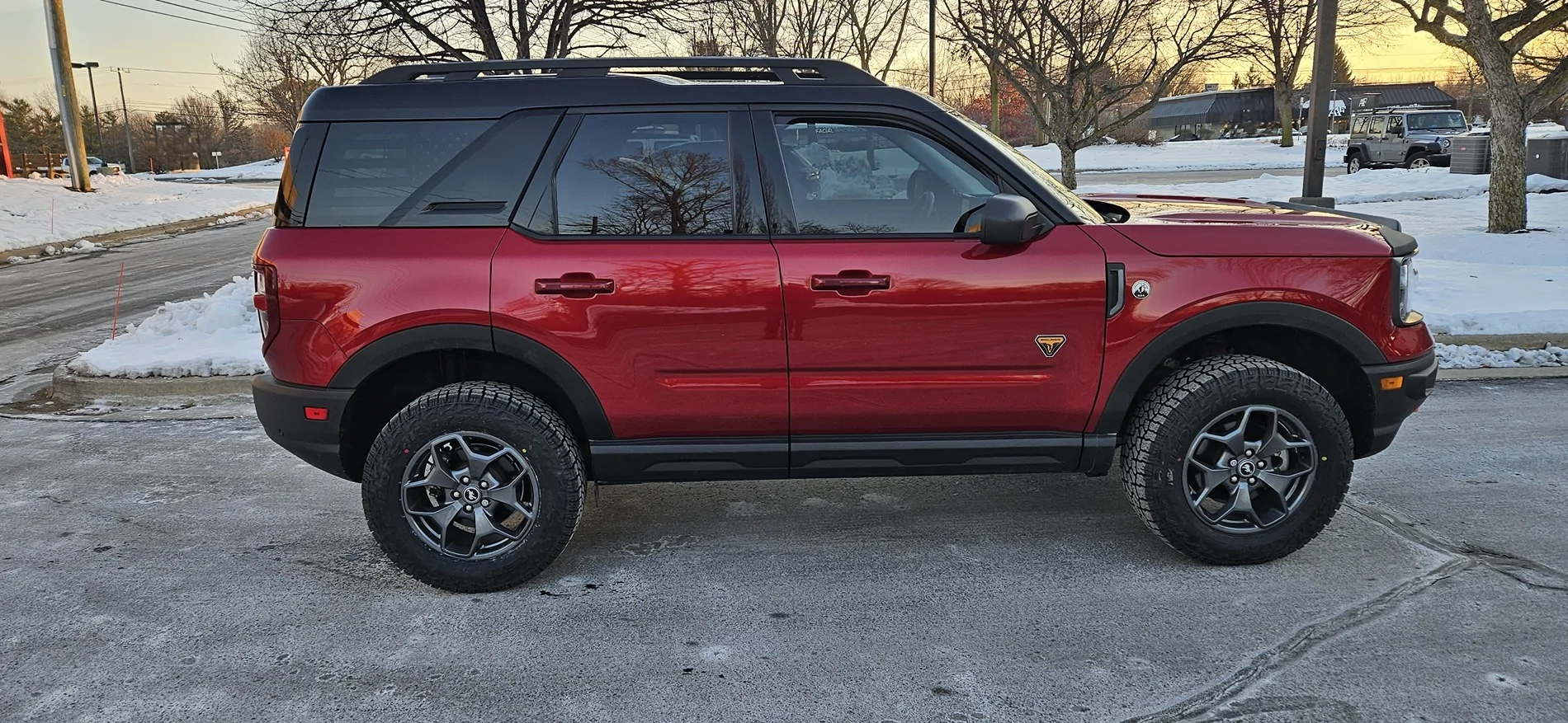

Because you asked.........
Here's one of the pictures that was missing from the story.
Ford Bronco Sport Bronco Sport Badlands - Lift Options BS BL 1.5 lift AT4W
Looks like about stock Badlands Sasquatch height now.

I think it's really close.....those are 245/65/17 AT4Ws. I've measured two '25 Badland Sasquatch vehicles (ground to the bottom edge of the rear wheel molding through the center of the wheel) and compared to mine and those measured 34.25" and 34.75". Mine is sitting at 34.6" (average between left and right), BUT I'm not sure that's a fair comparison because I believe they changed the wheel well moldings on the new Badlands Sasquatch. I'm not sure, but I think they may be a little shorter, which, if true, would make those numbers slightly larger. Not 100% sure about that, but I know they are different. I'll have to make another trip to a local dealer and compare side by side now that the lift and tires are installed. I originally planned to measure to the bottom of the trailer hitch, but I ended up going with an aftermarket hitch so I'm not sure that's apples to apples either now! Drats!
