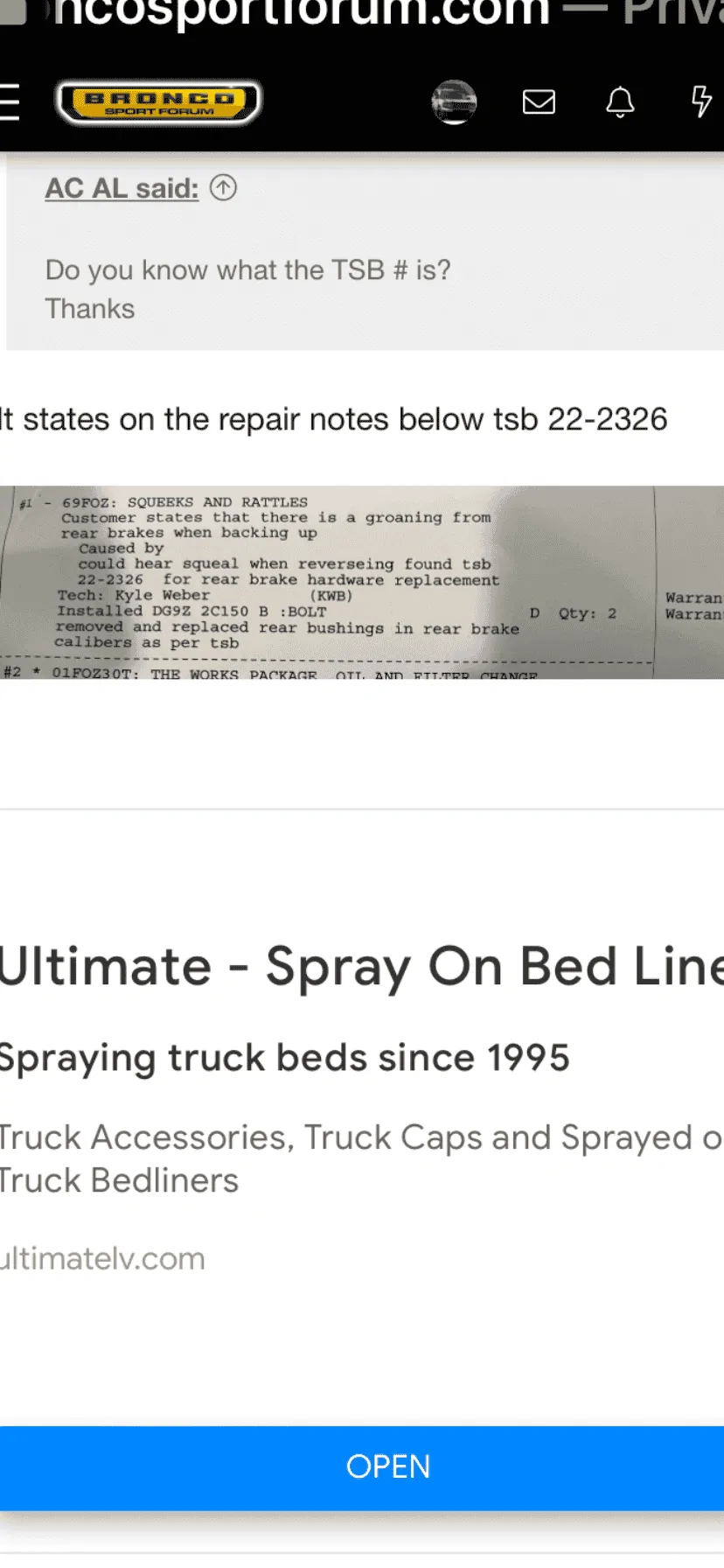

Can you share the part numbers?

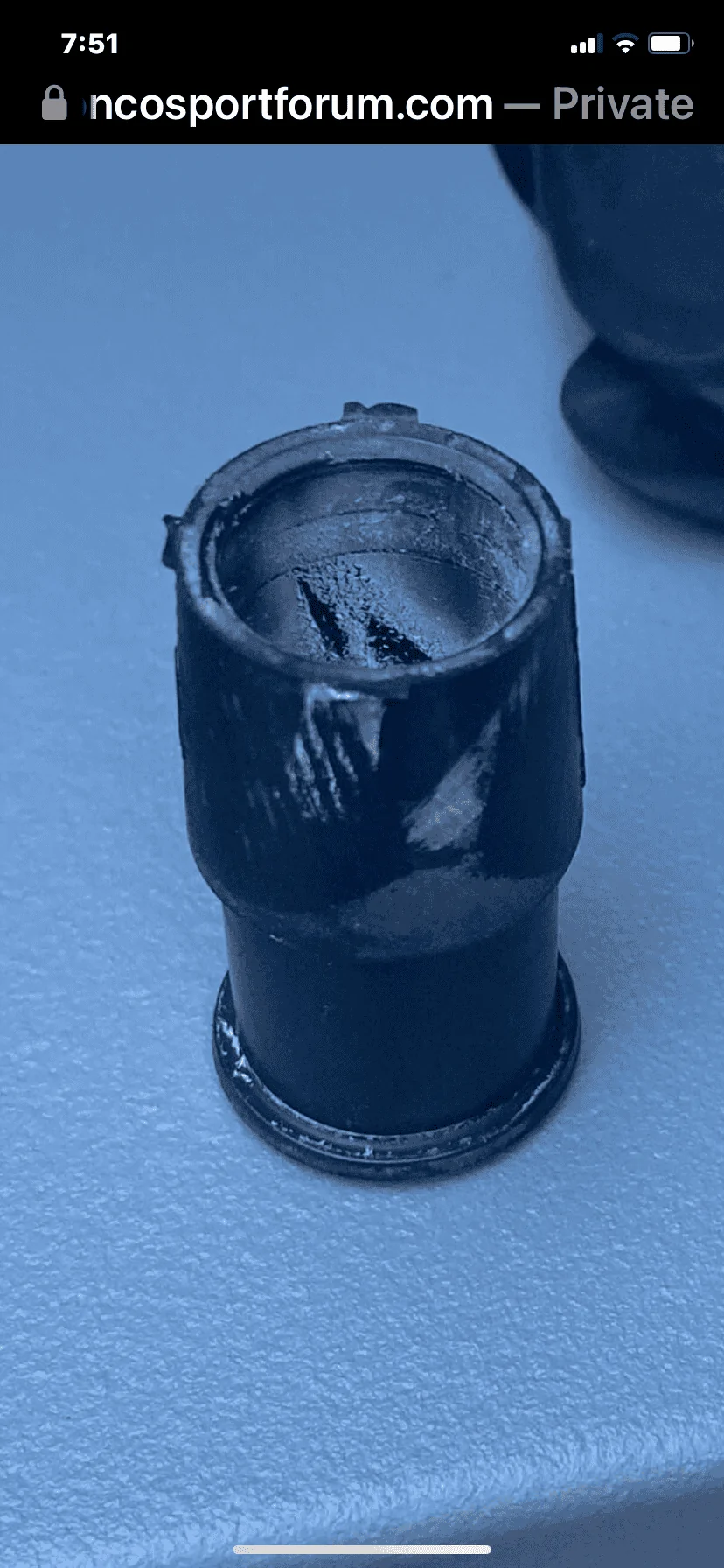

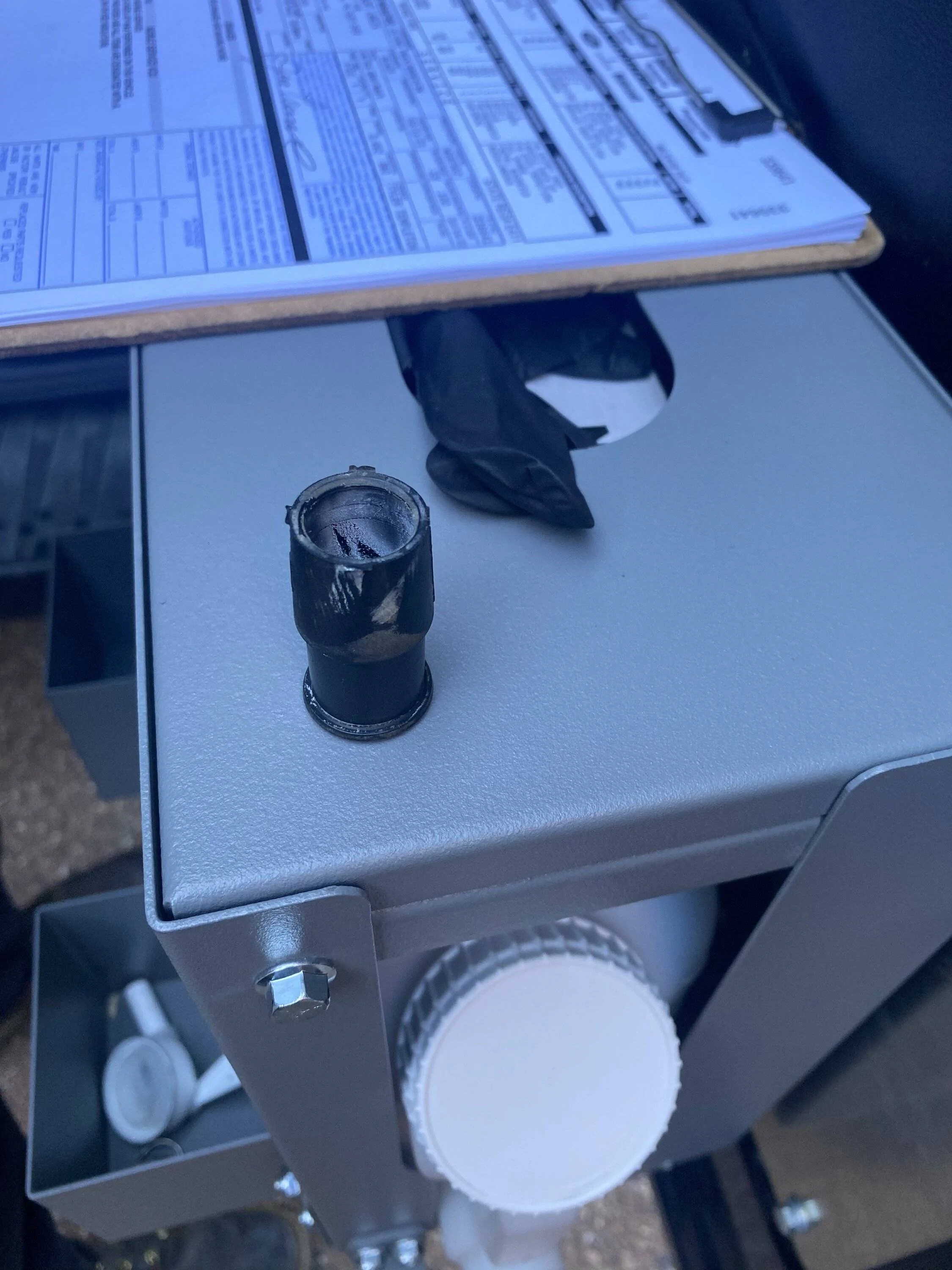

Looks like caliper pin bushing which indicate calipers were sticking not releasing causing brakes to drag hence noise.
Some of the videos I have seen where sounds like tug boat horn in a harbor certainly seemed like brakes not disengaging.
While all the complaints been rolling in looks like Ford took it seriously and found a root cause fix.
I believe at the factory they were not greased initially. That’s my 2 cents .

This bushing just was removed from my sport , no grease .
Part number below in my mechanic dealer notes. . You can clearly see no grease on bushing, new parts are different in appearance .
