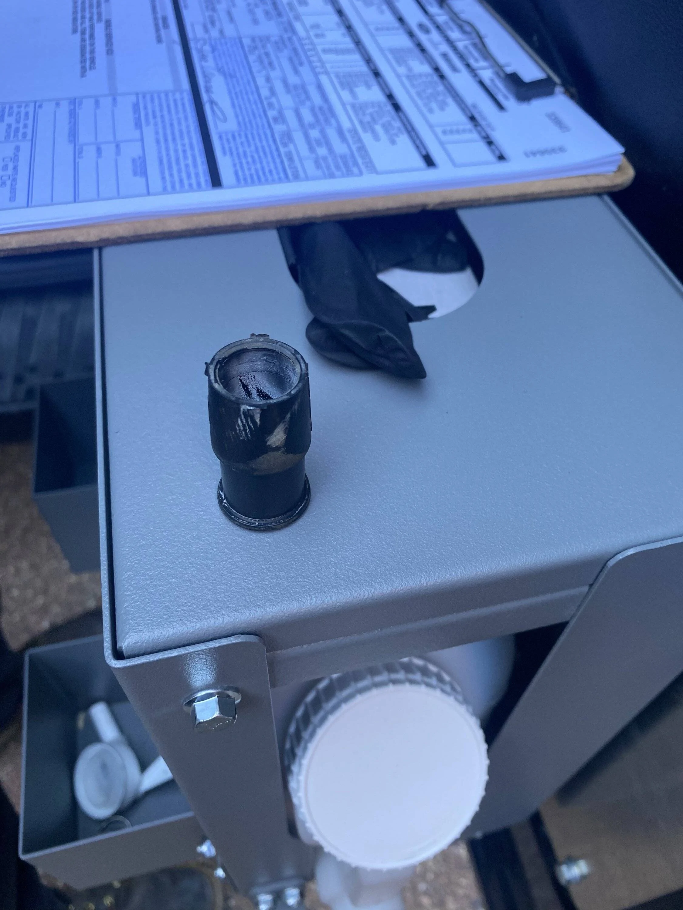

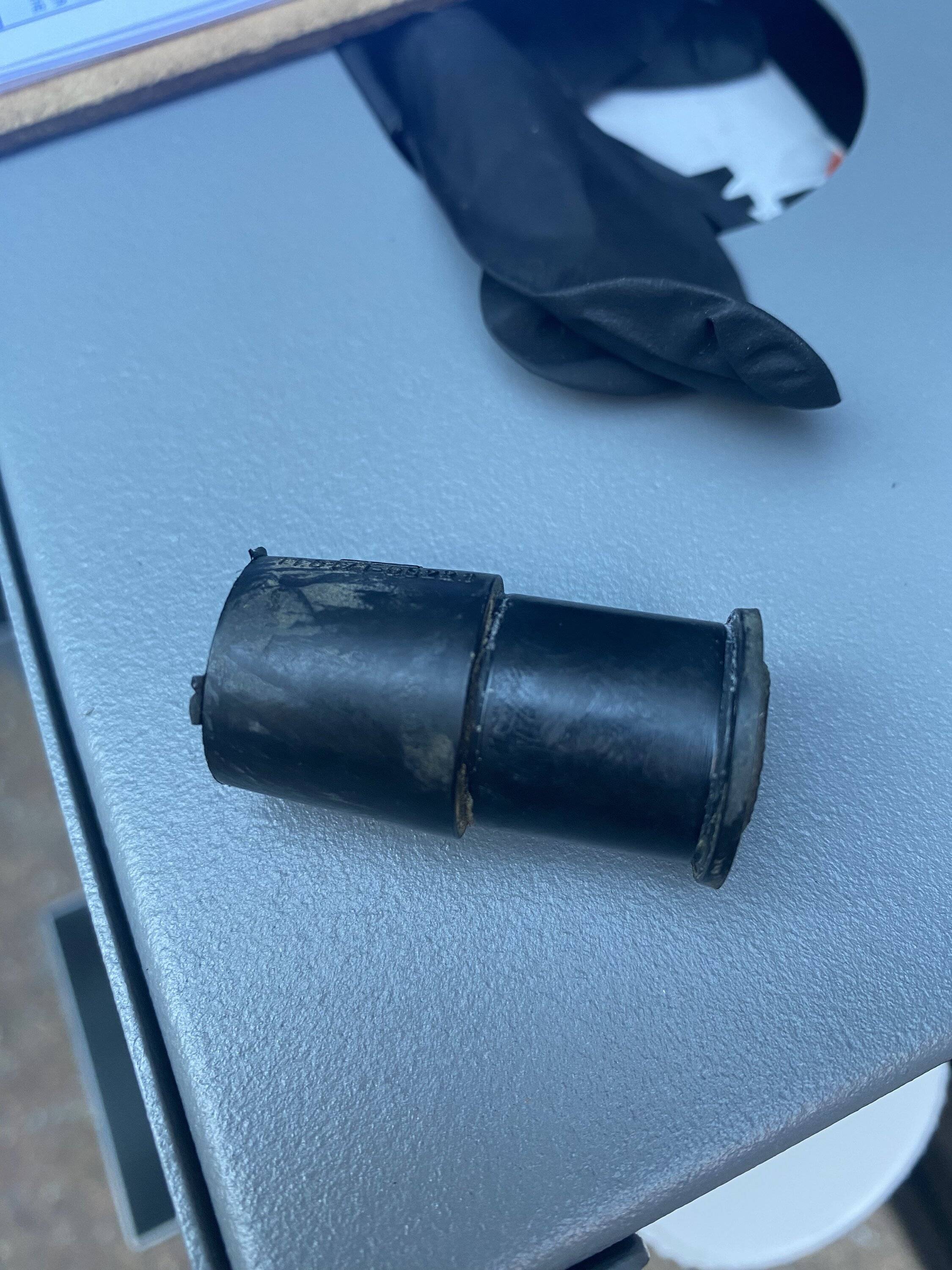

My ford dealership came to my house today and put in 4 new rubber bushings in the calipers, they now make no growling noise at all . This is the correct and only fix for that problem, note it only happens when in reverse. Thanks goes out to Alex and the Shults ford south team Pittsburgh pa
I would like to add that the bushings had no grease on them when disassembled . That is suspect.
