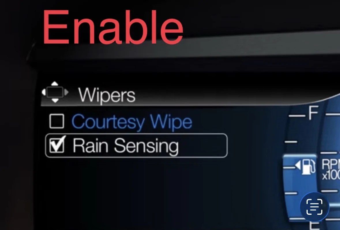

Did you say you are also getting the right side stalk with the control for rain sensing wipers?
F150 Forum says the specific stalk with rain sensing is not needed - is just an on/off switch for the feature

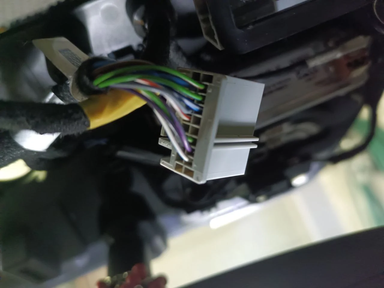

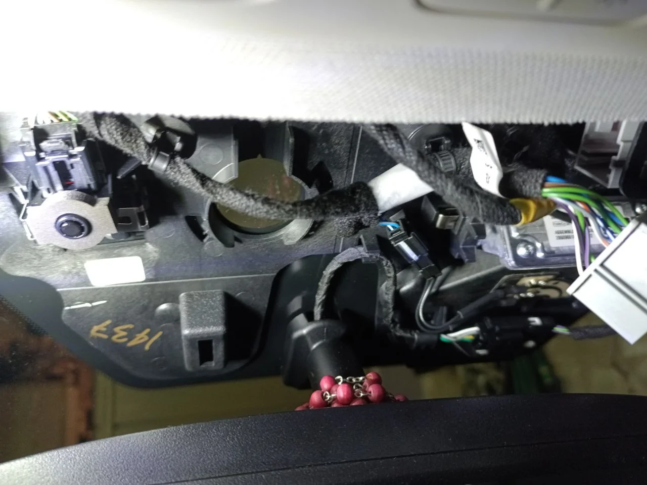

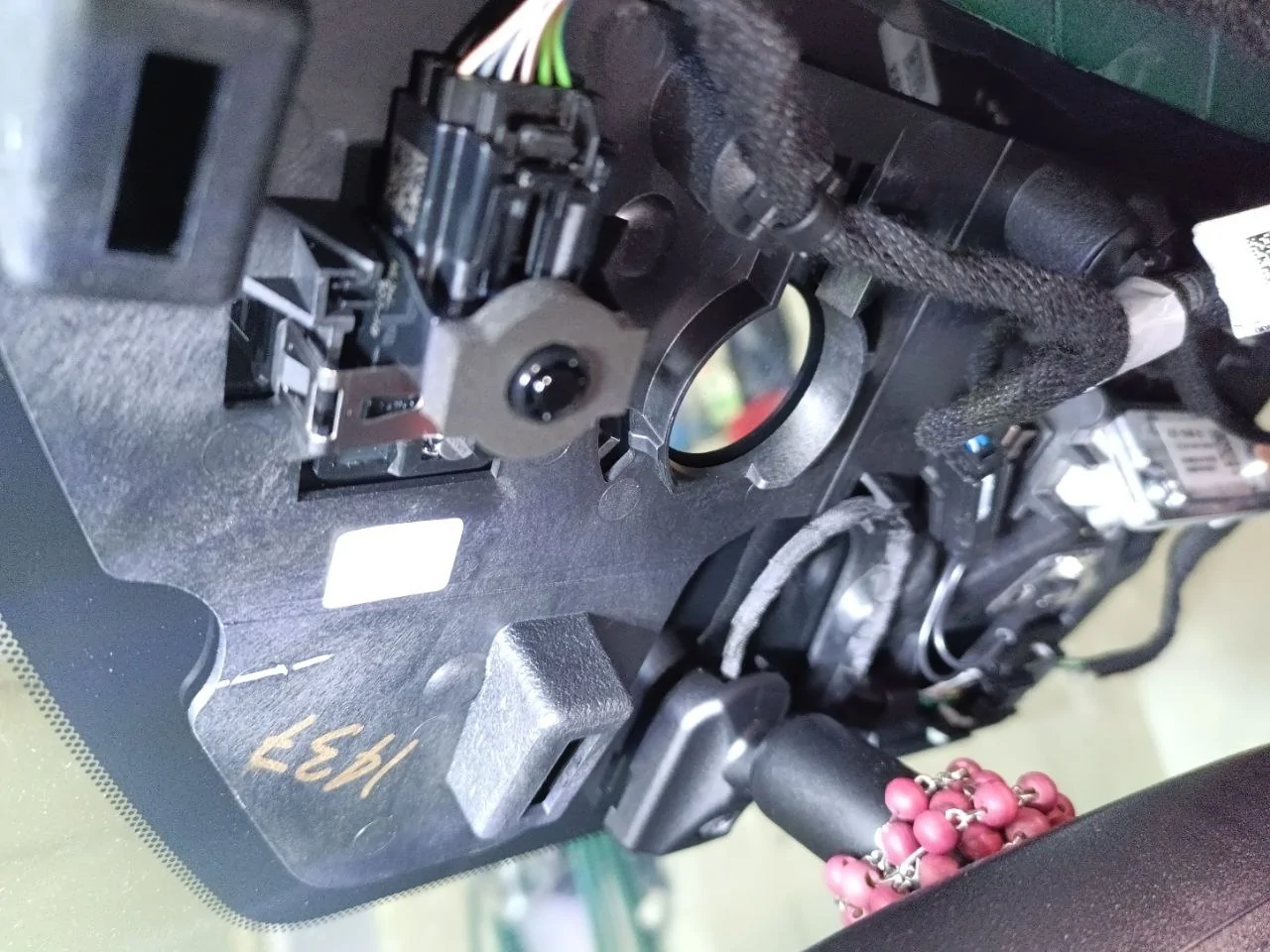

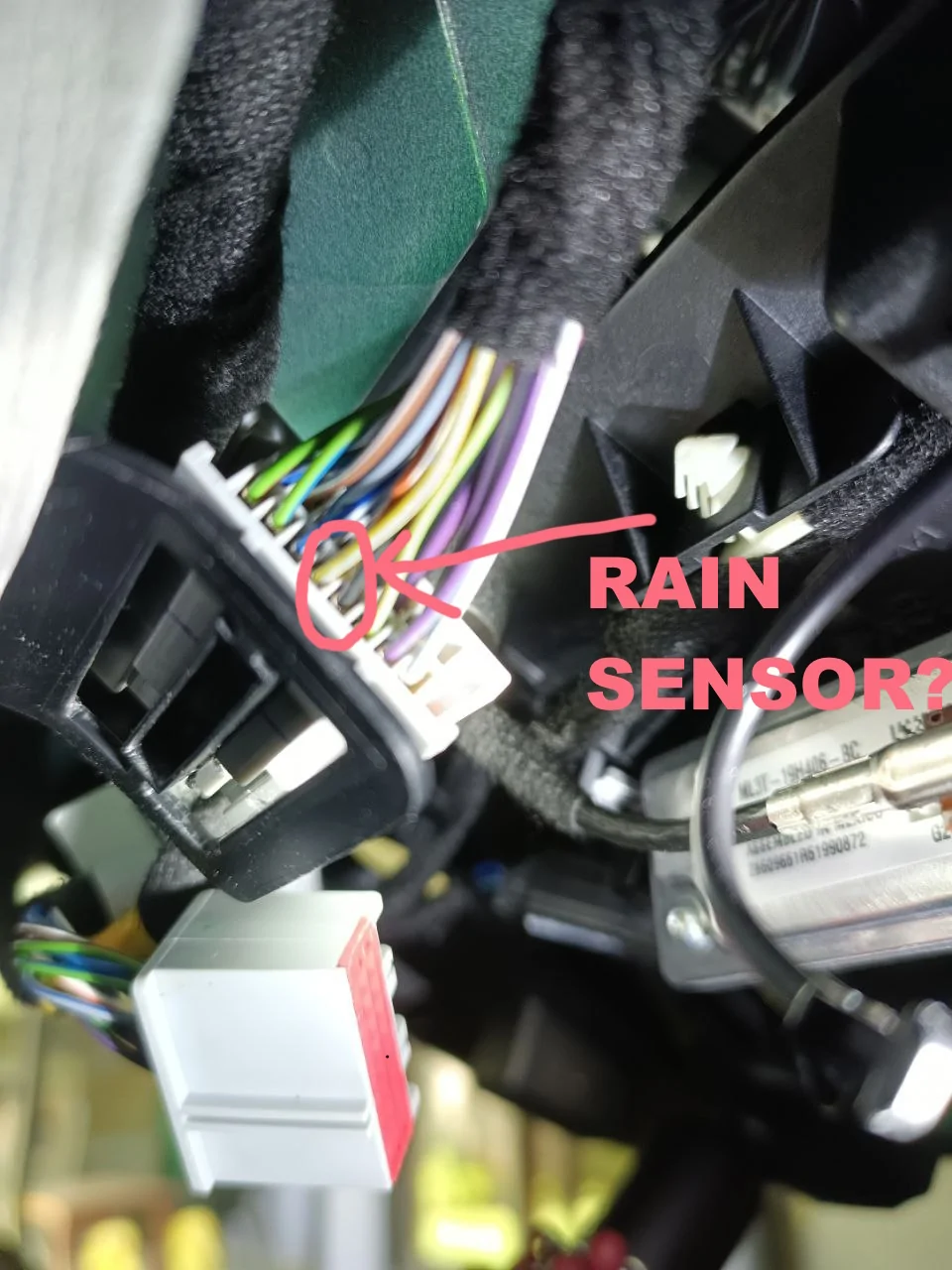

Here I show what's under the lid
The main cable has unused wires. Could those be the rain sensor wires?
Does anyone have a photo with the sensor attached?
If anyone has the electrical diagram, I would appreciate it!
Very thanks!
