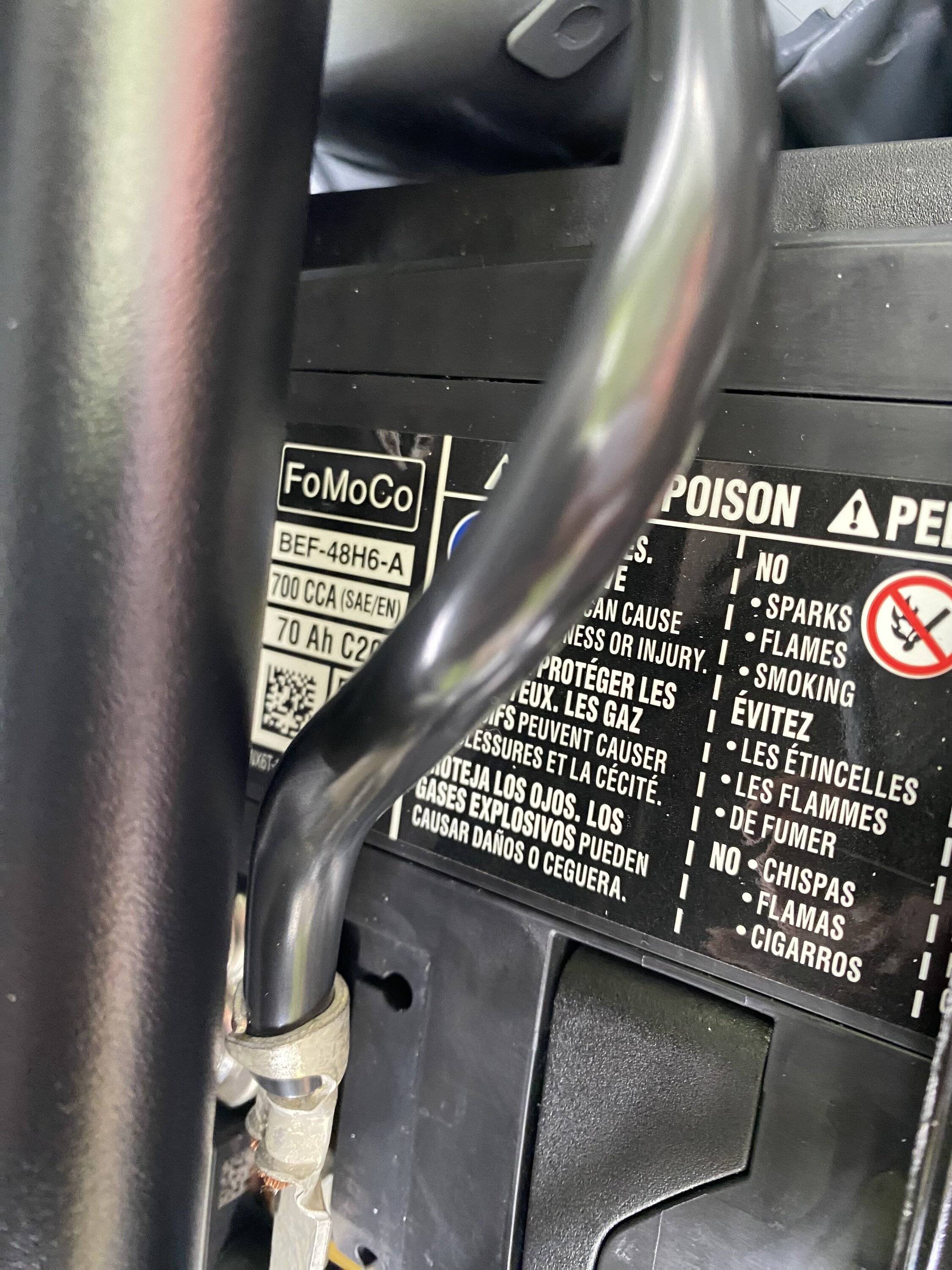

Ford is aware of the battery issue. I wonder if maybe the '23 and more so the '24 models have or will have upgraded batteries.
I have a 6/23 build date in my BB. I will check later and look to see if it is an AGM battery. Fingers crossed. ?
I seriously doubt it will be an AGM but at least maybe an upgraded acid battery.
I think you're right. I don't see anything that says AGM. Cheapo Lead Acid. As long as I get till the warranty is up with it I guess I can't complain. Just so I know to set my battery tender correctly.
Ford Bronco Sport Your Bronco Sport has been put into Deep Sleep mode IMG_2124
I posted the same battery numbers in the Mechanical and Maintenance and Servicing forum.
