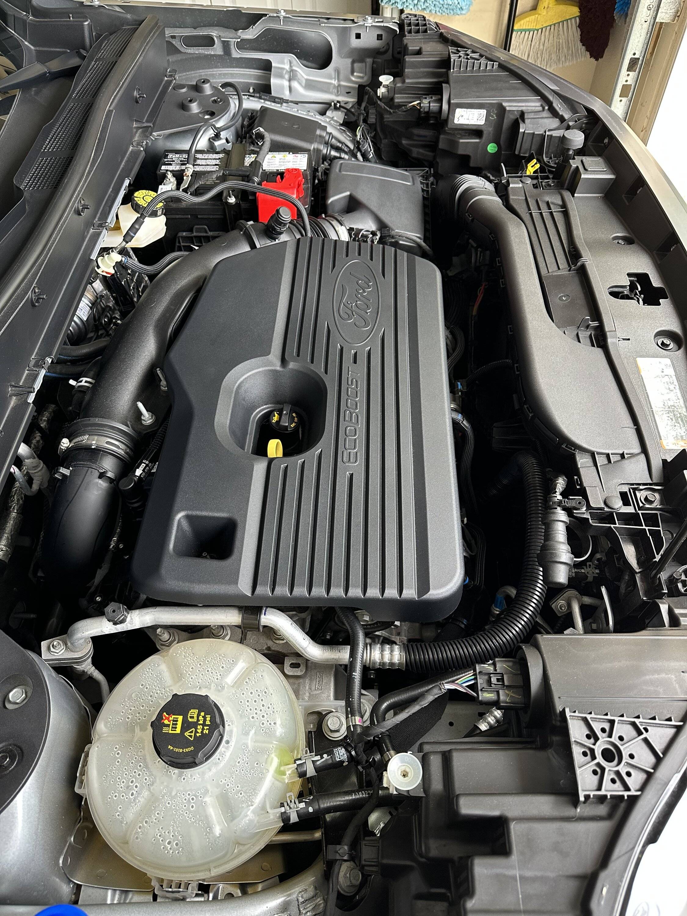

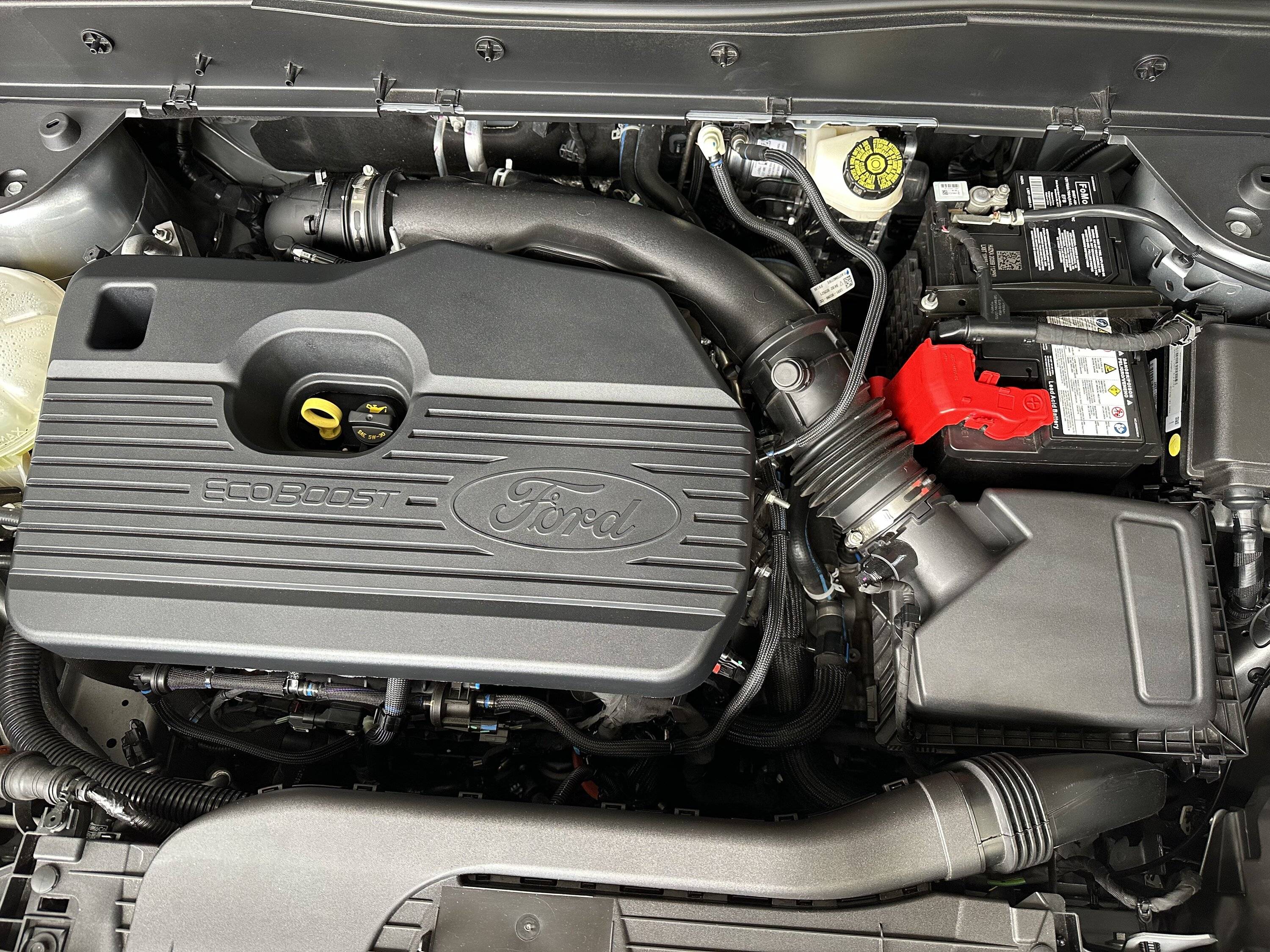

I bought my 2021 Badlands used in January. The dealer did an ok job of cleaning the engine bay.
I did my own detailing when I got it home. I guess I'm more particular than most owners when it comes to keeping my vehicles cleaned and detailed. It helps to be in this climate with minimal rain and no winter conditions.
I hose the engine bay with low pressure water after hand washing with soap and water in a bucket.
Then I use low pressure air from my air compressor to blow off all the residual water from the engine bay, under the cover and area's that I can't reach.
I use my Griot's detailer on all the plastic and the engine cover to keep it looking new.
Ford Bronco Sport What do y’all do to clean your engine bay? 21
I use a small California duster on occasion to get the dust off and every few months just hose it down and repeat the process above.
