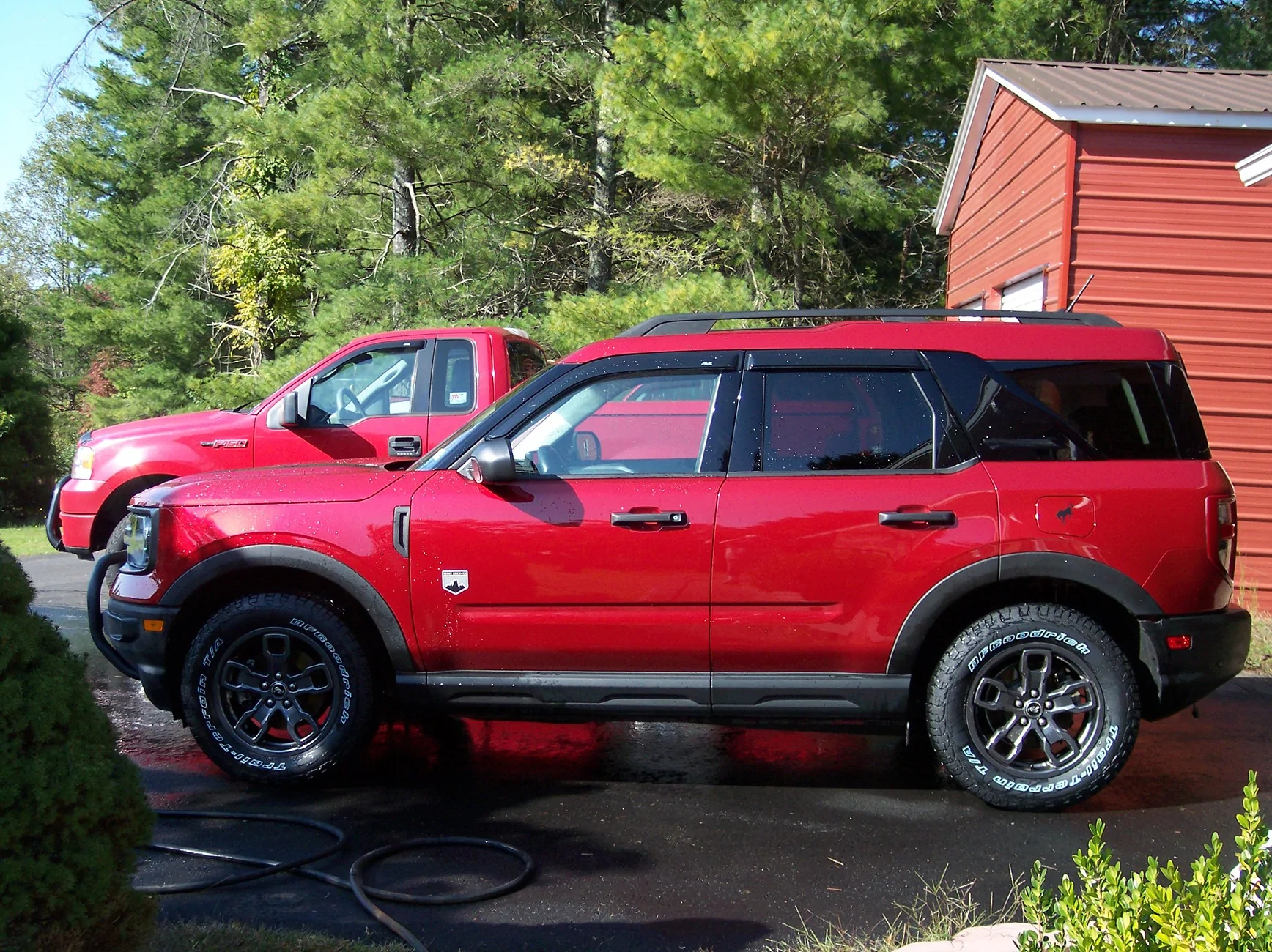

Outside water is shut off for the fall/winter. Car wasn't a mess. I used waterless (no water) wash/wax with lots of microfiber towels. Came out good. I even did the wheels. Kind of surprised how easy it was. Many brands out there and they all are good for this but I used a 'waterless' product (not 'rinseless' product) with a bunch of microfiber towels.

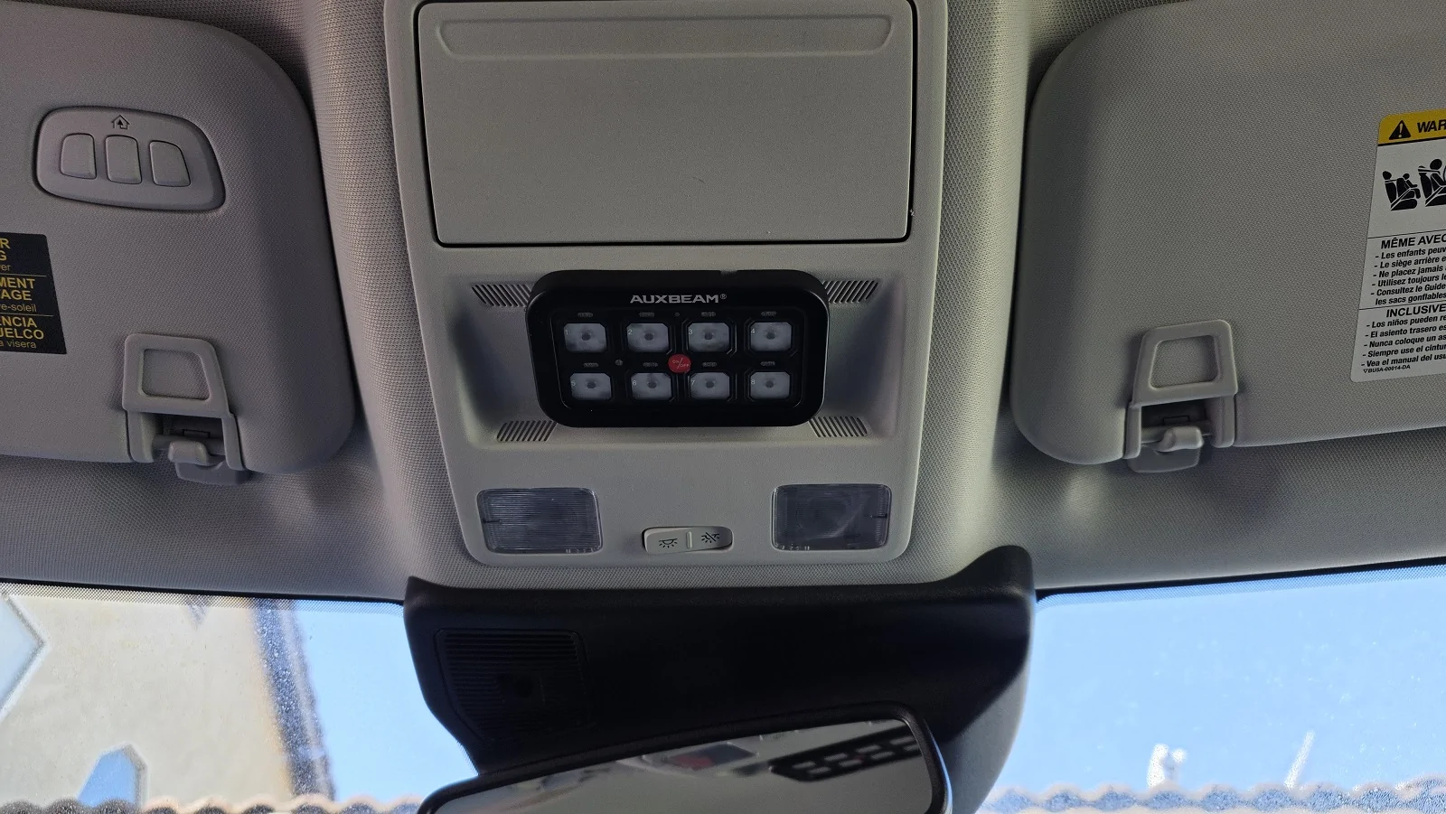

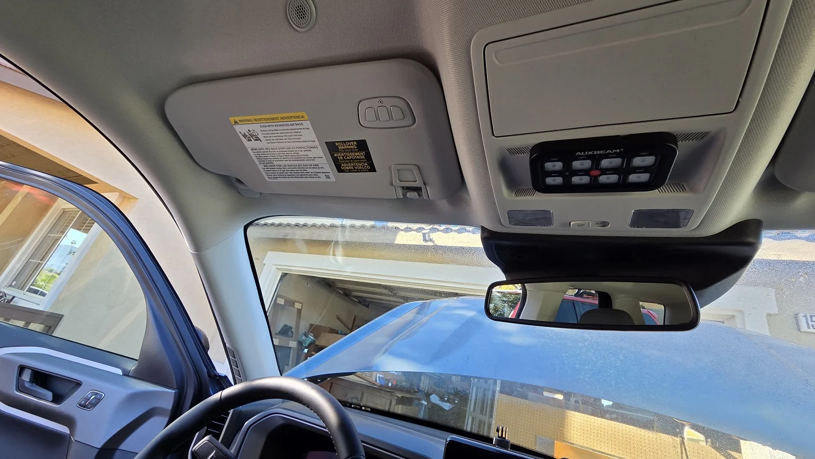

Today I started installing a switch panel. The under-hood fuse box is a no-go for the supplied accessory power tapping fuse, as the lid won't shut, and I'm not going to cut into it. I either need to tap a wire somewhere or order some wire and tap into the internal fuse box?
Mounting the switch panel wasn't too difficult. I only had to drop the upper console, remove the sun visor, and the pillar trim panel. I used a stiff wire to fish the cable from the corner of the headliner to the console opening. I then ran the wire down the factory harness and out of the unused grommet under the dash. The hardest part was removing and reinstalling the pillar trim panel.
Ford Bronco Sport What did you do TO your Bronco Sport today? Switch Panel
Ford Bronco Sport What did you do TO your Bronco Sport today? Switch Panel2

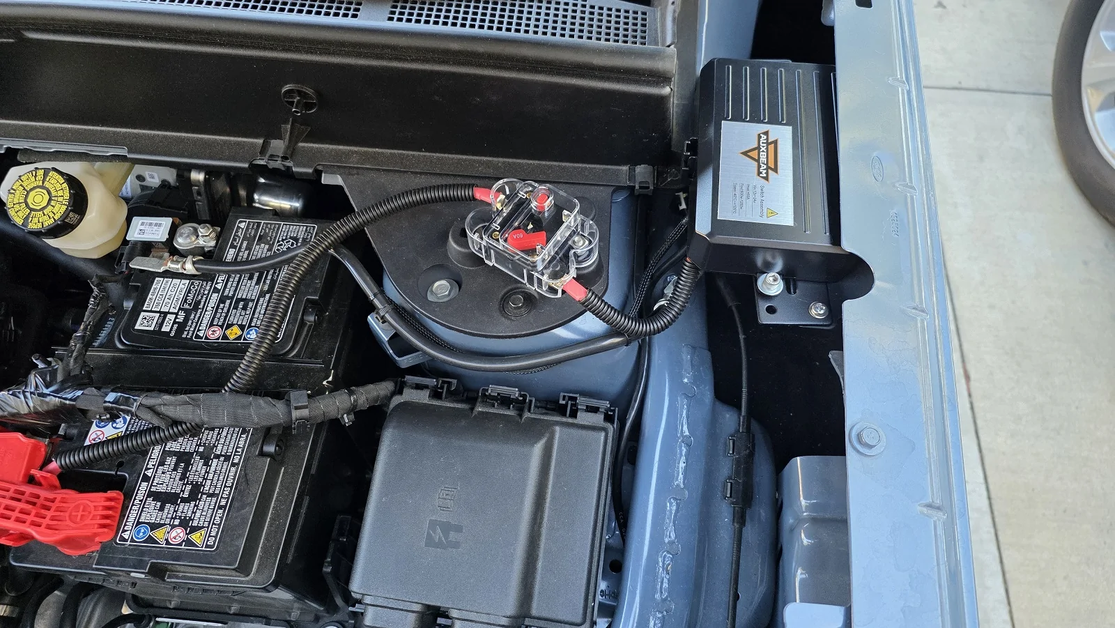

There really isn't a whole lot of available real estate under the hood to work with. This was the best I could come up with while keeping it looking somewhat tidy.
Ford Bronco Sport What did you do TO your Bronco Sport today? Switch Box
It's a tight fit in that corner, but by removing the visible mounting bolt, I'm able to pivot the box and remove the cover to access the internals. The circuit breaker does look somewhat getto, so I'll probably order a more visually pleasing one when I order some more supplies.
