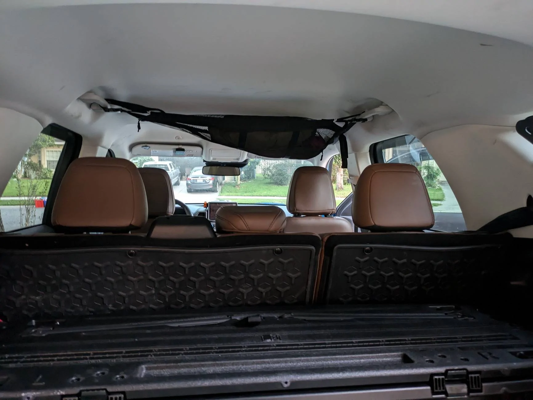

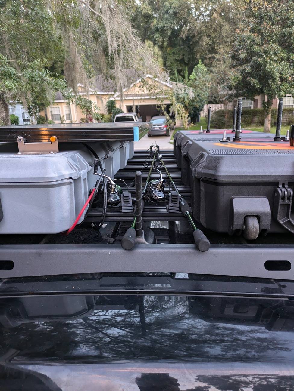

Two minor additions to get ready for a big group road trip. Added a three-point ceiling net for my Wife and my raincoats as well as quickly rigged some Quick-fist connectors to my roof rack to serve as fishing rod holders. The quick fist solution is working marvelously in testing and event at highway speeds the rods are secure and not banging against anything

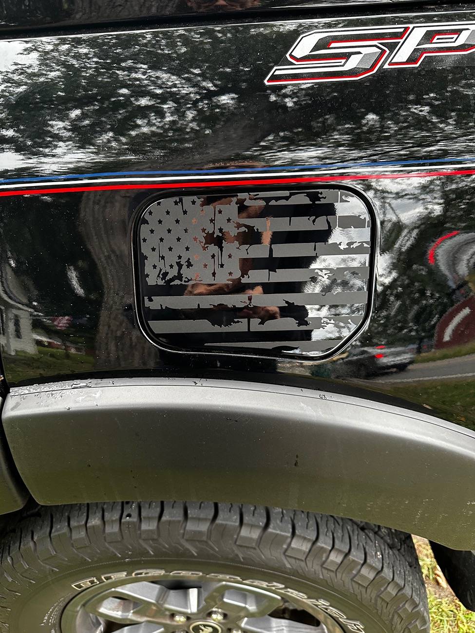

I really have a problem with finger prints on my gas cap door every time I fill it up so this is my solution for that for under $30. If this stands up to Delta Sonic’s car wash for a month (I typically give Tilli a bath twice a week), I’ll be looking at Underground’s distressed flag for the quarter windows and their A,B and C pillar graphics in the spring

? What brand are your flares? And how wide are they . Looks great.

They are EGRs. If all was available were the "faux bolt" style, you can bet your first born I would have nut-certed the fenders/doors and....BOLTED them on!
A tip I mentioned in a post elsewhere, purchase some 1/2'" 3M tape (PN 03614C), apply it to the flare where it meets the fender lip. This cements the bad boy in place for one, adds a little thickness so the clips provided bite a bit better (there are countless posts about our Sportie brothers and sisters complaining that they lost a few). I also added a few #8/1 black stainless self tappers for good measure.
Where they goin??? They goin NOWHERE! :cool:

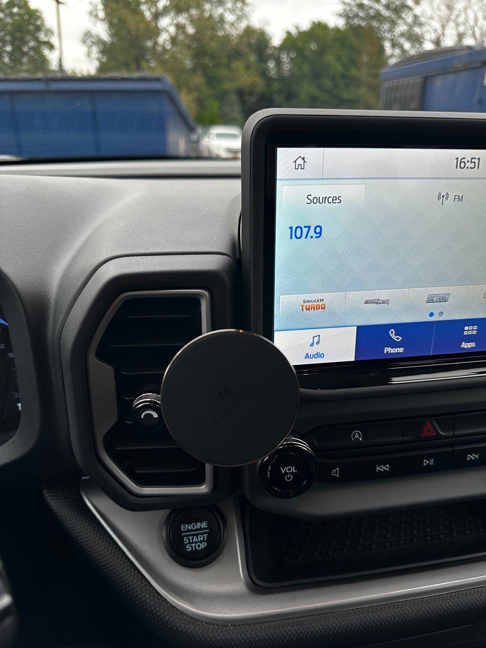

Installed a phone mount. Kinda sketchy removing the whole shebang, was a bit nervous as I don’t have a great history with plastic clips. Whole deal took me less than 15 minutes and most of that was looking for my trim tools

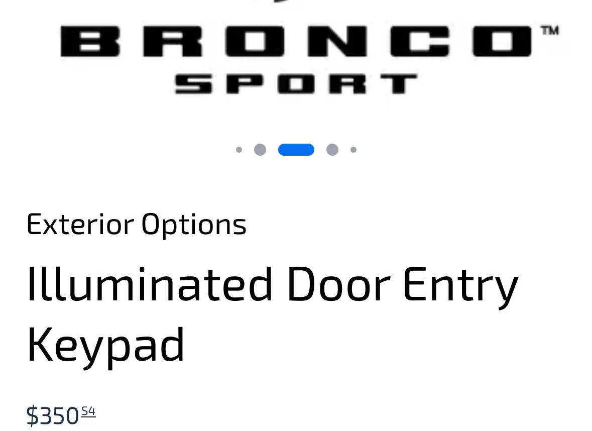

Going to dealer for installation of the Illuminated Keyless Entry Keypad since it was a DIO that wasn't installed so I bought it afterwards

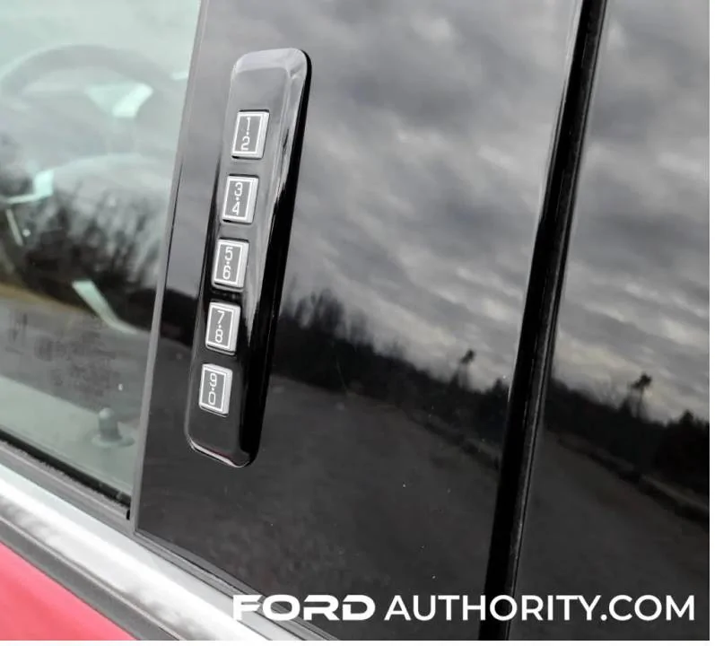

Just curious in case I buy a ‘25 or ‘26
Just curious in case I buy a ‘25 or ‘26, is the DIO the stick on keypad or the flush keypad? The order site didn’t have a pic.

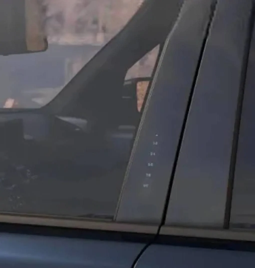

for my 24 its the touchscreen style one on the a pillar and not stick on

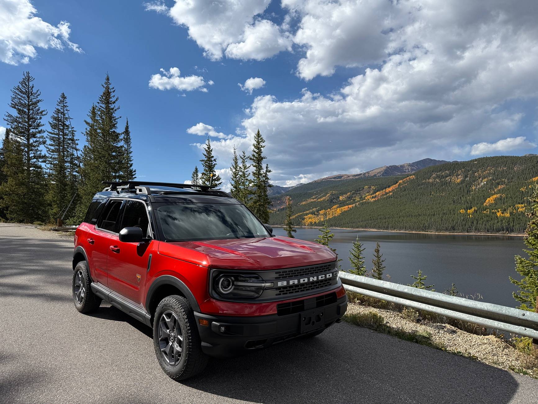

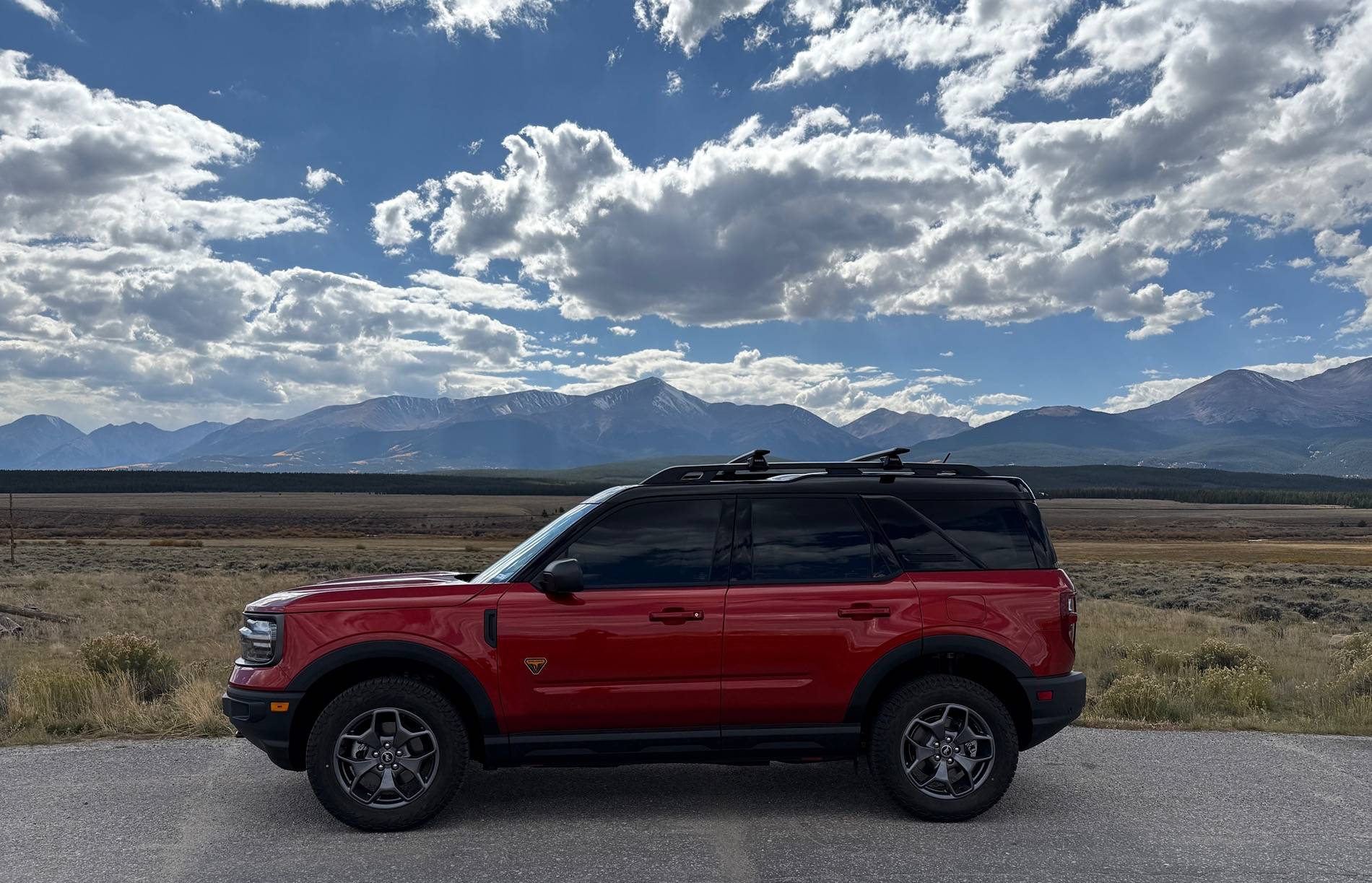

Successful trip to Leadville today.
