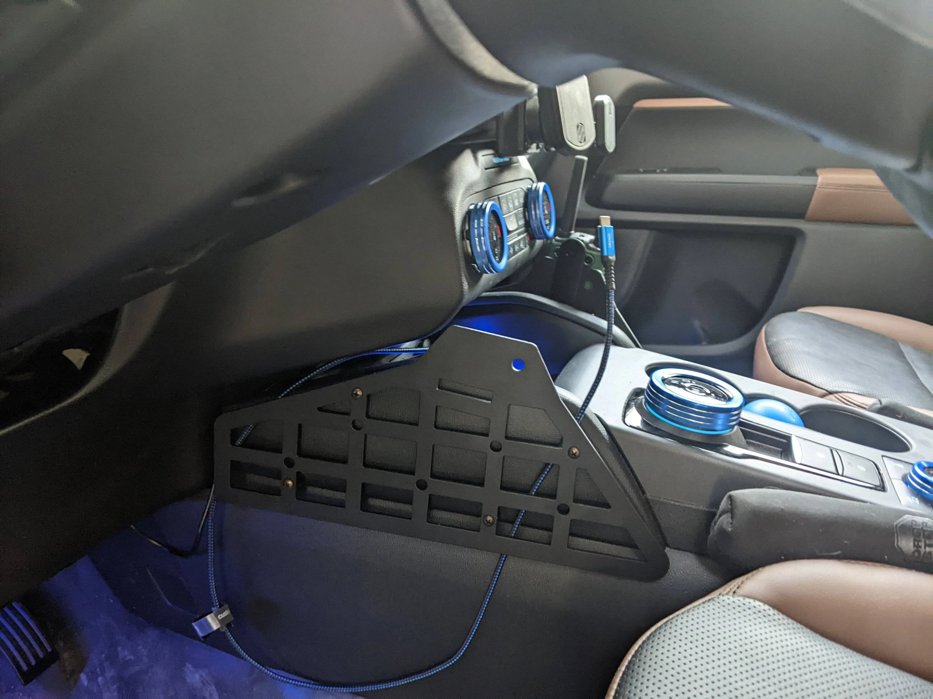

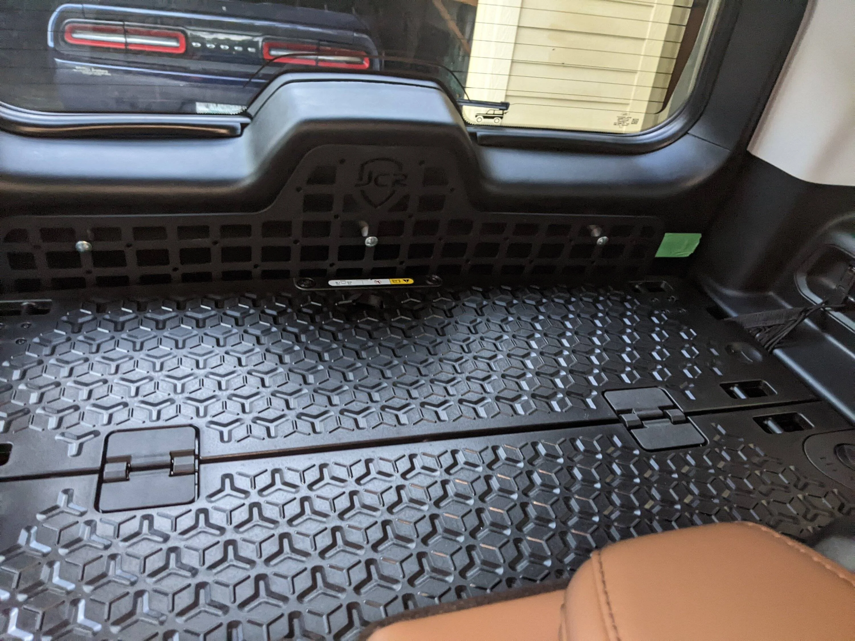

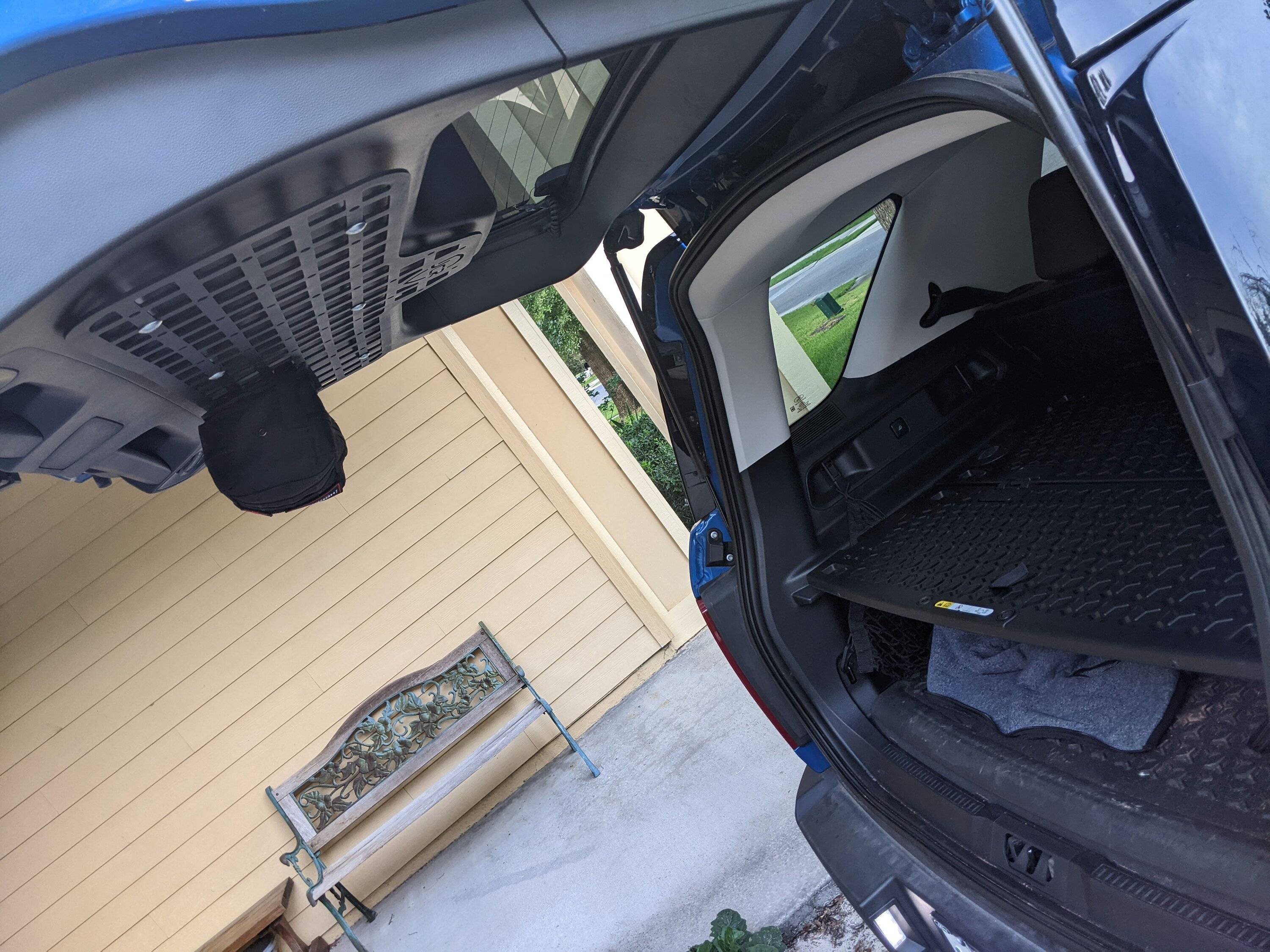

Today I installed both the JCR front center console MOLLE panel and the JCR rear hatch MOLLE panel.
I used the installation guide videos on their website for both of these installs and they were relatively easy and straightforward and I had no unexpected hiccups in the process except for a minor issue with the Center Console panels.
Working doors open on a stool or on your knees while trying to awkwardly brace those damn metal panels and keep them somewhat symmetrical was not fun and not pleasant.
I installed every piece with the included hardware but long term (eventually) I think I'd like to change from the coarse thread screws on the front panels to a Rivnut connection.
I can confirm that the rear hatch panel is compatible with the OE cargo organizer shelf though you won't be able to open or close the shelf with the trunk closed through the lift glass.

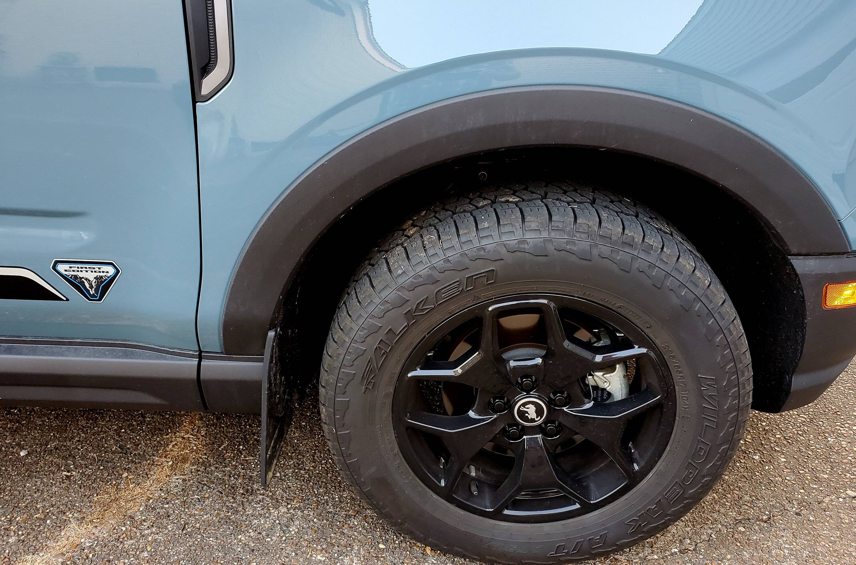

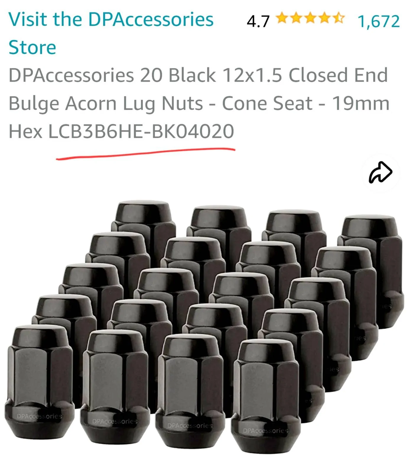

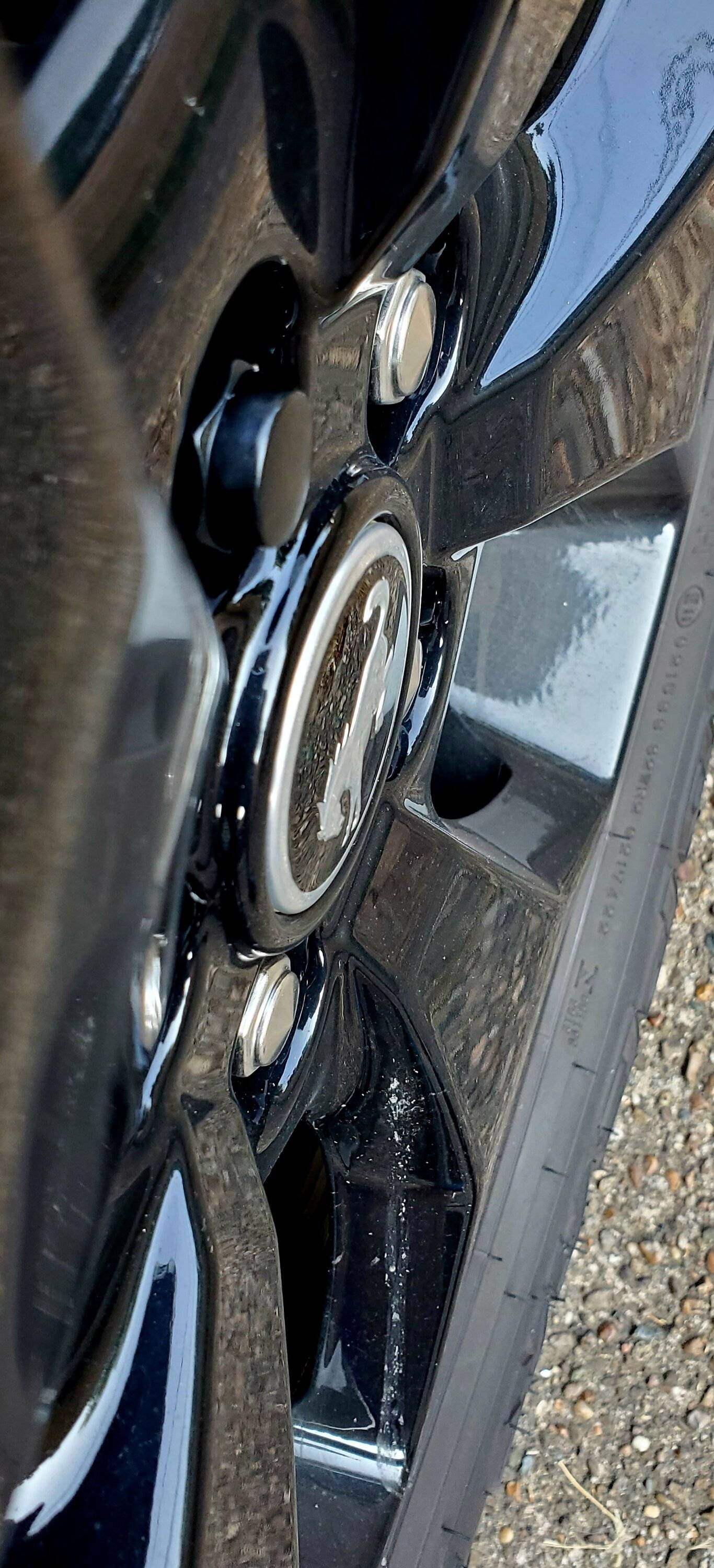

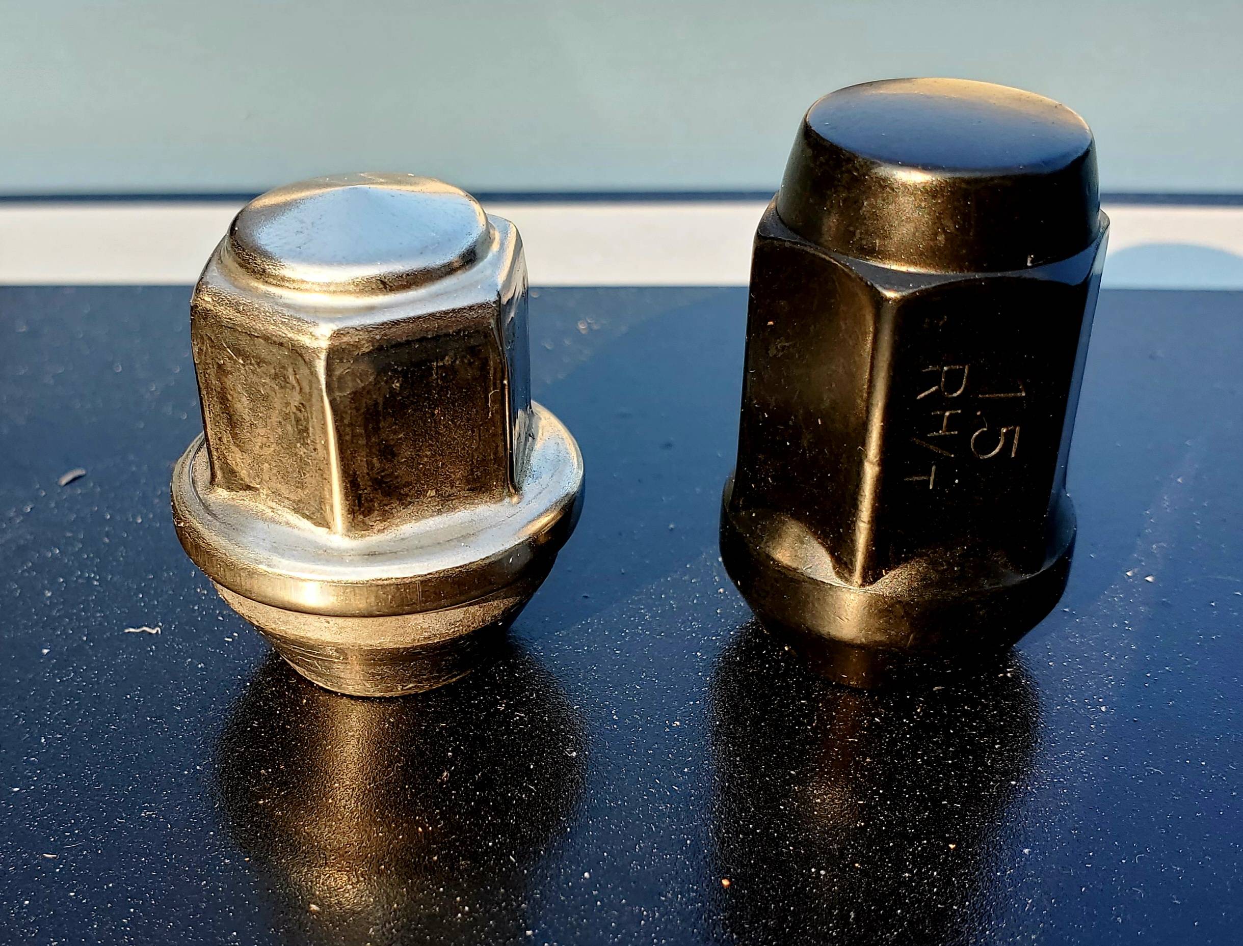

Installed new, Black, 1-piece lug nuts.
Dp Accessories closed-end M12 x 1.5 thread / 19mm hex bulge acorn conical style.
About $40 for the set @ Amazon. Part # underlined in Red.
