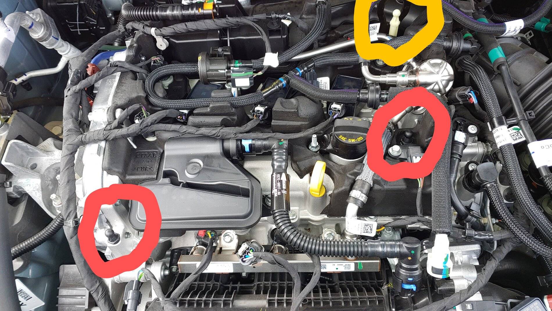

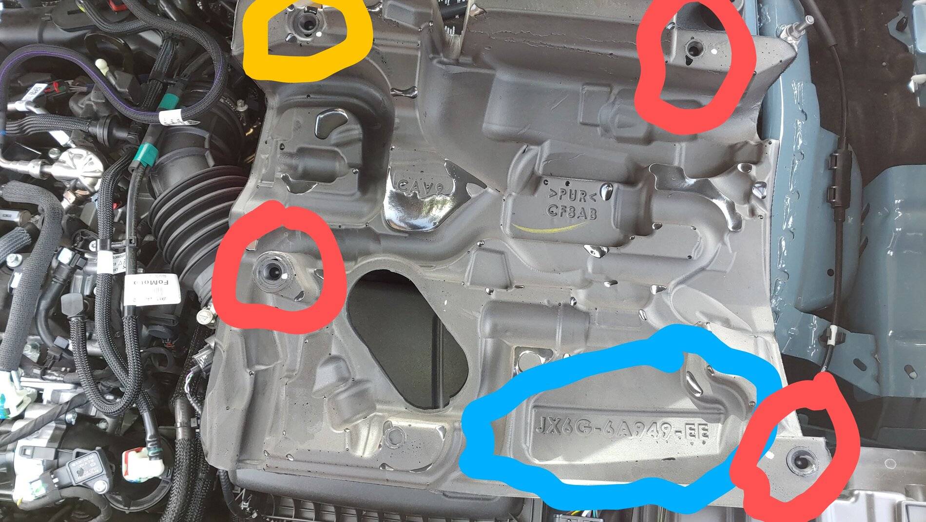

There are 4 mounting posts 1 long white post circled yellow. 3 short black post circled red. The cover is flipped over on top of battery part number circled in blue.

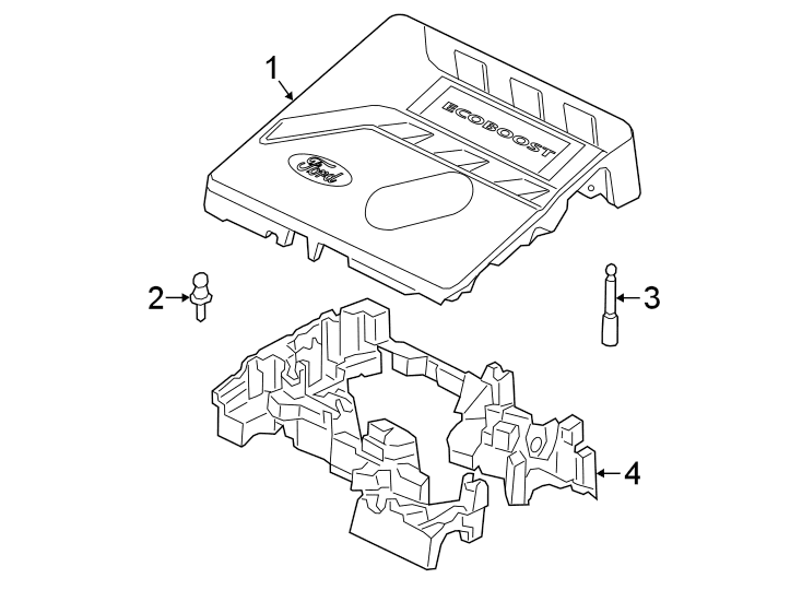

Correct me if I am wrong, but for the 1.5 we need Part Numbers:
#1: JX6Z6A949B is the actual cover and it includes the 3 studs, part #2: AA5Z6N958A.
#3 DT1Z6A957A is the longer white stud.
What is part #4 JX6Z9K540B, and where is it on your picture? Do we need this?
Ford Bronco Sport Upset over missing engine cover! BS21260
540B is number 4, "Insulator", you dont need to buy this, it's already on the engine, under the wire and pipe rat's nest.
I have tried to buy the white stud, 957A from several sources, all have told me that it has been discontinued. If anybody finds a source or replacement, please post.
The cover does not come with the 3 958A studs, you have to buy them separately.

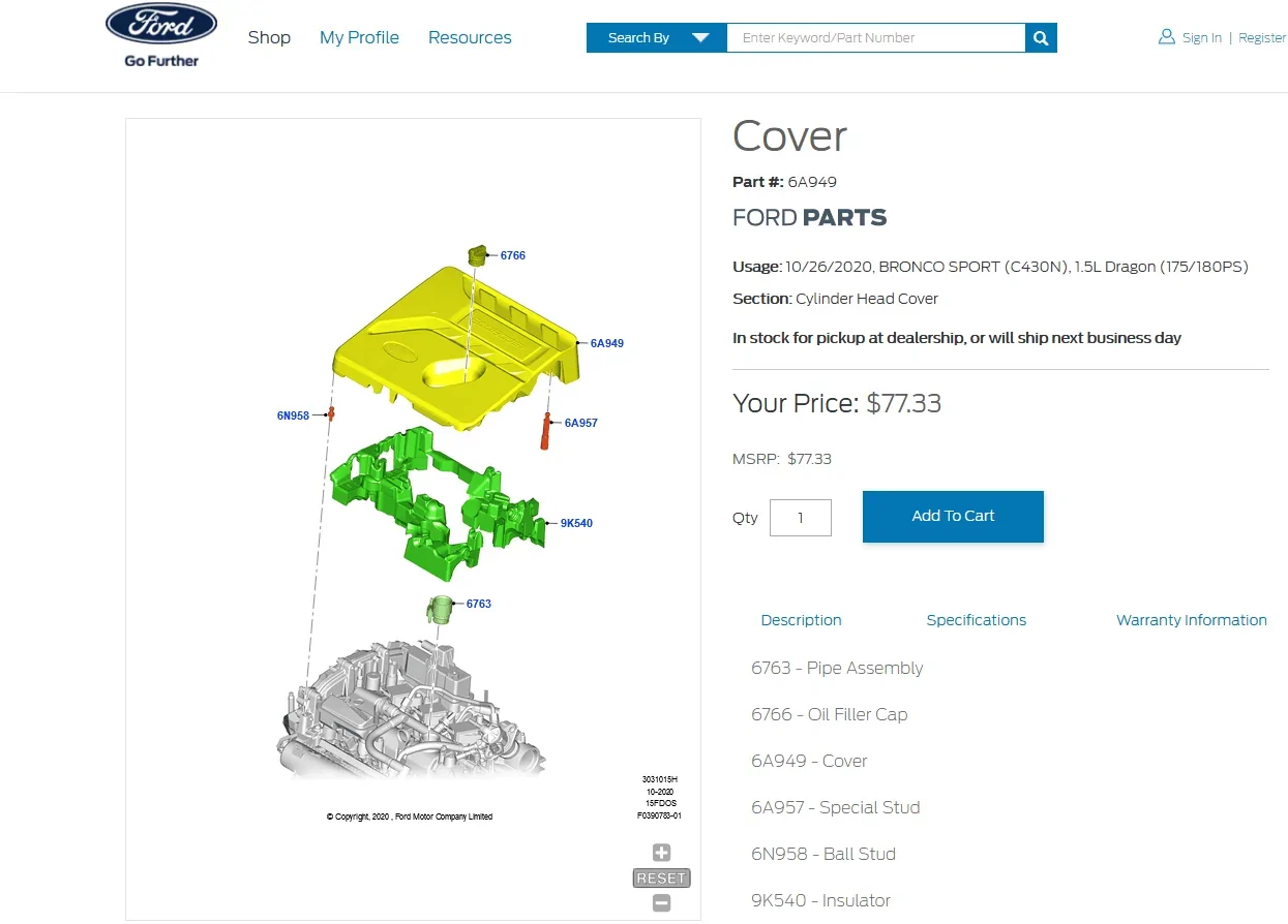

This is the parts list for the Bronco Sport 1.5L Dragon. No dealer has the special stud 6A957 around my area. You will need that new cap and extension for the oil filler. From what I can see, the Special Stud is different from any other engine config, as it appears to be longer than the 6A957-A
Ford Bronco Sport Upset over missing engine cover! 1.5L Cover

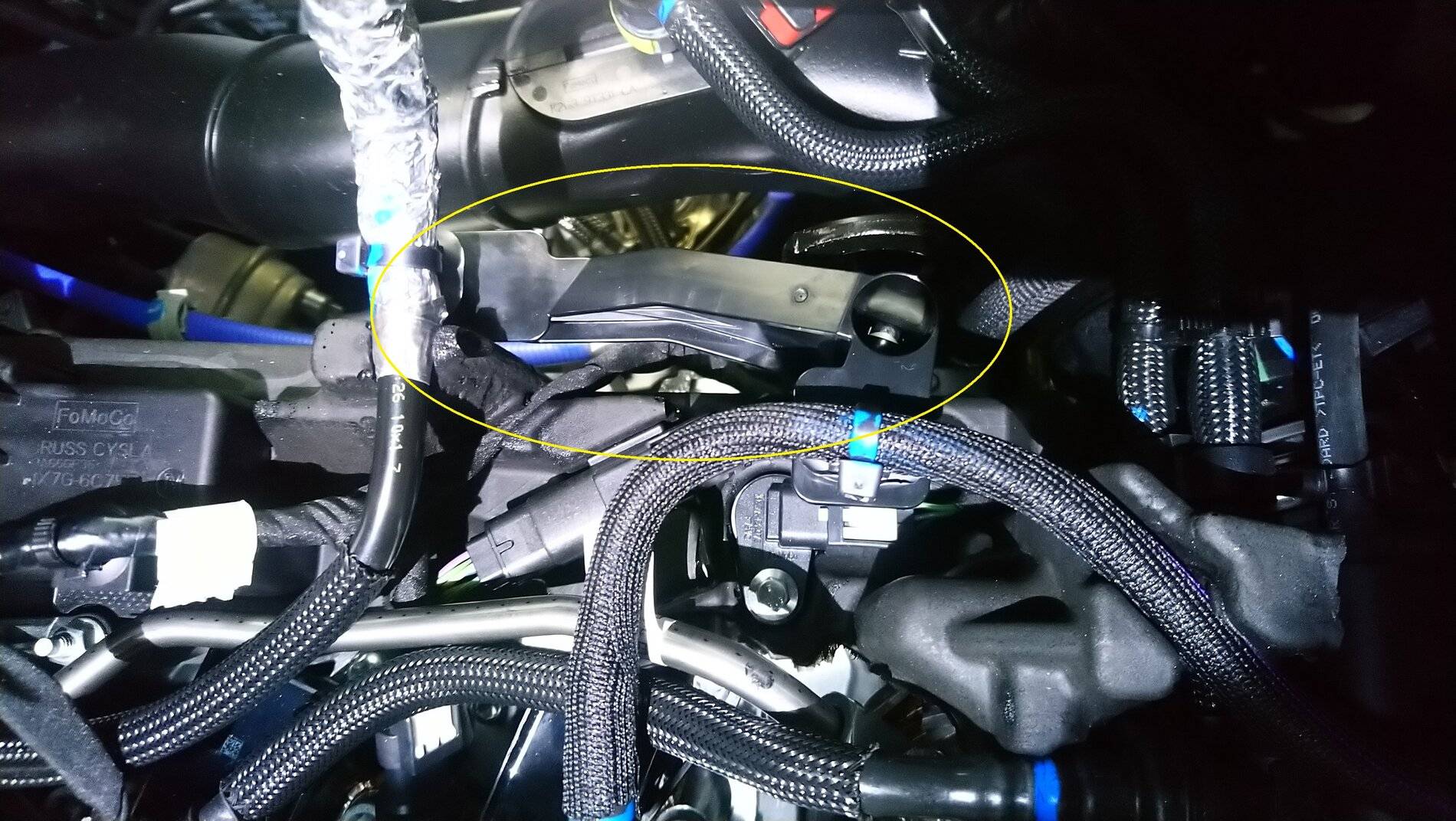

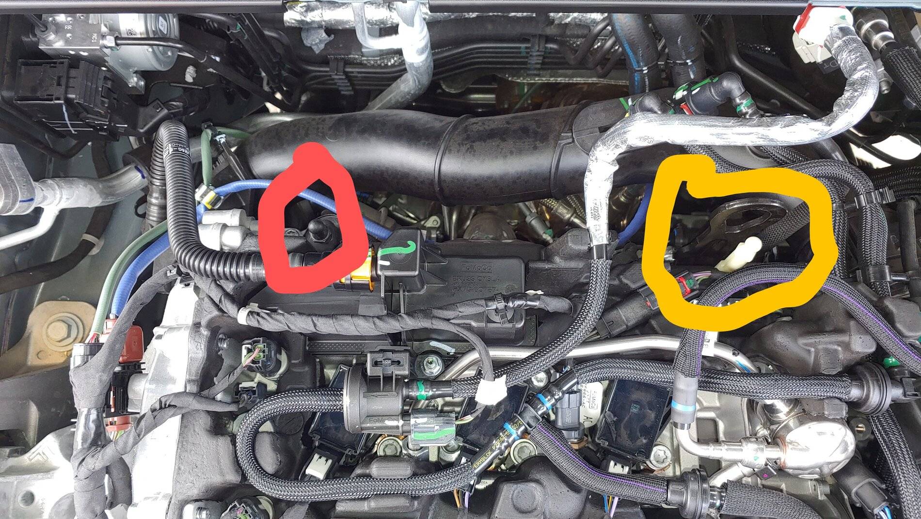

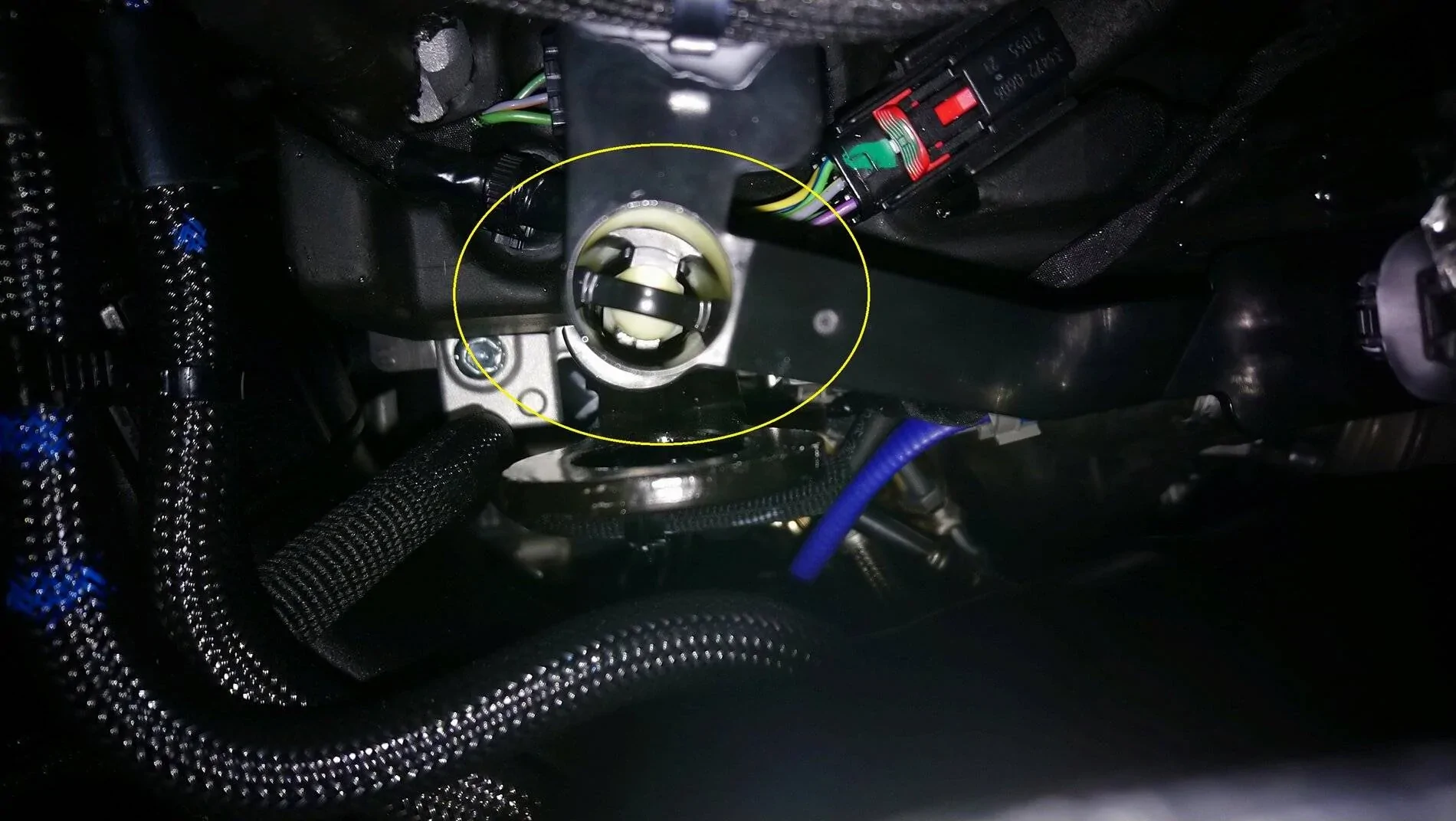

Ok, I believe I understand why Ford stopped providing the covers....They wont fit!... After carefully looking at my engine I have come to this conclusion******** Caveat///*** (I'm not a mechanic, and have never claimed to be smart, resourceful, or PC)
The "Special Stud" DT1Z6A957-A (White in color) that was installed on the back right side of the engine has been used instead to fasten a plastic wiring harness brace over it which locks in to the tip of the stud.
When the plastic harness slides down the stud, they lock in on the tip where normally the cover would and there is no longer a protruding round stud to fasten the cover to anymore. I assume this is why they state the Special Stud is no longer in production, because it wont work for you to attach the cover to anymore with that plastic brace in the way. See attached photos...anyone interested please review and tell me what you think

Well, you are correct Viking, it doesn't fit. The back right corner sits raised up and looks dumb. Is that plastic brace removable, and would that allow the cover to fit???
