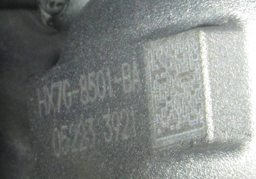

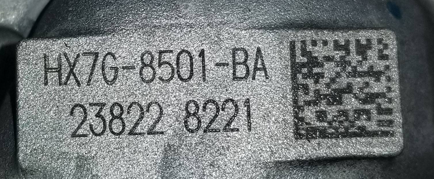

UPDATE from 05/03/23. Boy am I feeling vindicated. Replaced the water pump under warranty on my 2023 Bronco Sport Big Bend 1.5l 3 cylinder engine today. Build Date 12/??/22, purchased 03/23/23.
Because of all the forum posts about defective water pumps I had ordered a spare water pump and gasket set from fordoempartsonline, back in early May, 2023.
URL is https://ford.oempartsonline.com/oem-parts/ford-pump-assembly-water-hx7z8501b.
Back on September 25th I had taken the BS-BB to my selling dealer's Quick Lane for an oil change, I had noticed the coolant reservoir was almost empty. Asked them to look at that also. Apparently they could not duplicate the problem, but did top off the coolant reservoir. Fast forward to last Friday, Dec 8th. Again found the coolant reservoir almost empty. Looked around the water pump area and could see coolant on various surfaces. Took several photos. Saturday Morning 12/09 drove to my selling dealer. Explained the issue. He claimed they couldn't install owner supplied parts due to liability issues. I told him it was a Ford part I had purchased from a Ford website. I also told him I was aware that there was a issue with the water pumps on the Bronco Sport 1.5l engines. I told him that was why I had purchased a spare. So as not to be out of service waiting for a part. He looked at the water pump area and thought it might be a loose hose. The earliest appointment he had was 01/04/24 @ 0730 (24 days later). I asked him if I could take it to any Ford dealer. He said yes and referred me to Beach Ford in Va. Beach. I told him if I got an earlier appoint I would call and cancel the one for 01/04/24.
Drove over to be Beach Ford, spoke with the Service Director. Explained the problem and showed him my replacement water pump. He called his Part Department and confirmed the water pump was on back order, with an expected delivery date of 12/21. He set up a 0730 am appointment for me for today Monday 12/11, even had them come and get the BS. Long story short. Bad water pump, they installed my replacement, bought the BS back to me. They have ordered a replacement water pump and will email when it comes in, and I will go pick it up. So instead of being out of service for 10 days, it was out of service for one. WHEW!!!
Canceled the service appointment for 01/04/24 with selling dealer.
Now the rest of the story. The water pump that started leaking and was replaced was the same Part Number as the new replacement water pump. Supposedly an upgraded water pump.
Old Water Pump HX7G-8501-BA 23822 8221
New Water Pump HX7G-8501-BA 05223 3921
So even the new upgraded water pumps can be prone to leaking. Time will tell.
Purchased 03/23/23, already have 26,385 mostly highway miles on it.
