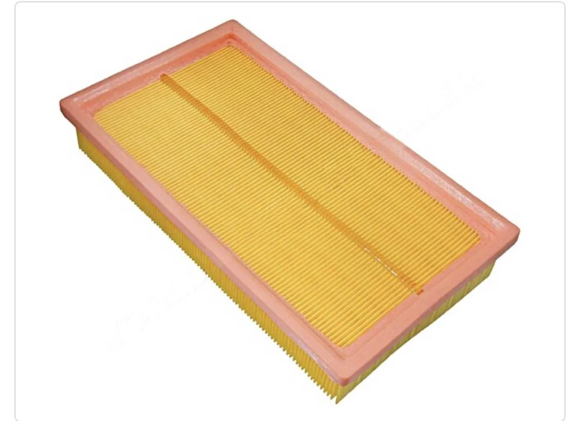

Check the condition of your engine air filter. I assume it has never been changed. Do you have the OEM air filter still installed?
Just remove the filter and tap it on a hard ground surface until the dust no longer shakes out and reinstall.
Also check for any blockage around the air filter box and the fresh air intake coming into the box. The fresh air comes in from the bottom of the box.
This is what the Motorcraft OEM filter looks like.
