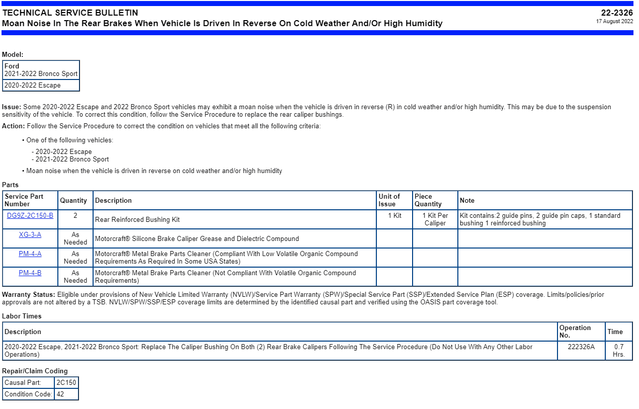

Yes but did you show the dealership TSB 22-2326? It’s shown at the top of this post.

I hope with a TSB date of August 17th my BS OB built on 9/19/22 will have the new bushings for the calipers. Is that what Ford does during each build schedule, retools for known bug-a-boos. To rid of the known bad parts. I know that would make sense. However you never know. Thanks for posting the TSB. I hope to get mine from the dealership in a couple of weeks.

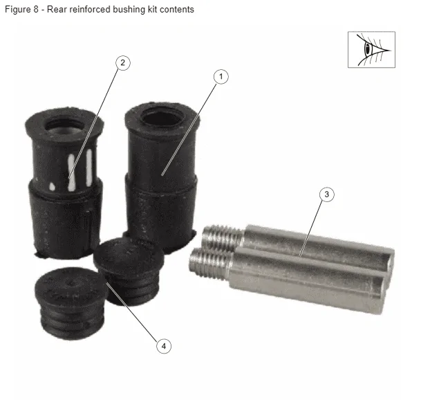

I've seen a few mentions of the recent TSB regarding brake noise. Here's the full scoop!
Ford Bronco Sport TSB 22-2326 : "Moan Noise in the Rear Brakes When Driven in Reverse in Cold Weather or High Humidity" Screenshot 2022-10-24 144733
New parts:
Ford Bronco Sport TSB 22-2326 : "Moan Noise in the Rear Brakes When Driven in Reverse in Cold Weather or High Humidity" Screenshot 2022-10-24 144843
please search back brakes growling fix
Ford Bronco Sport TSB 22-2326 : "Moan Noise in the Rear Brakes When Driven in Reverse in Cold Weather or High Humidity" 0EC80D99-5676-488F-9EF6-4761666D98D1
Ford Bronco Sport TSB 22-2326 : "Moan Noise in the Rear Brakes When Driven in Reverse in Cold Weather or High Humidity" EB650933-7794-4447-BFCD-A3A80BF51352
Ford Bronco Sport TSB 22-2326 : "Moan Noise in the Rear Brakes When Driven in Reverse in Cold Weather or High Humidity" 4A60FDD5-02D4-4DEE-8D0B-658AE5D349A4
Ford Bronco Sport TSB 22-2326 : "Moan Noise in the Rear Brakes When Driven in Reverse in Cold Weather or High Humidity" 63B0E381-AC72-415B-A5DF-53F0EC548950

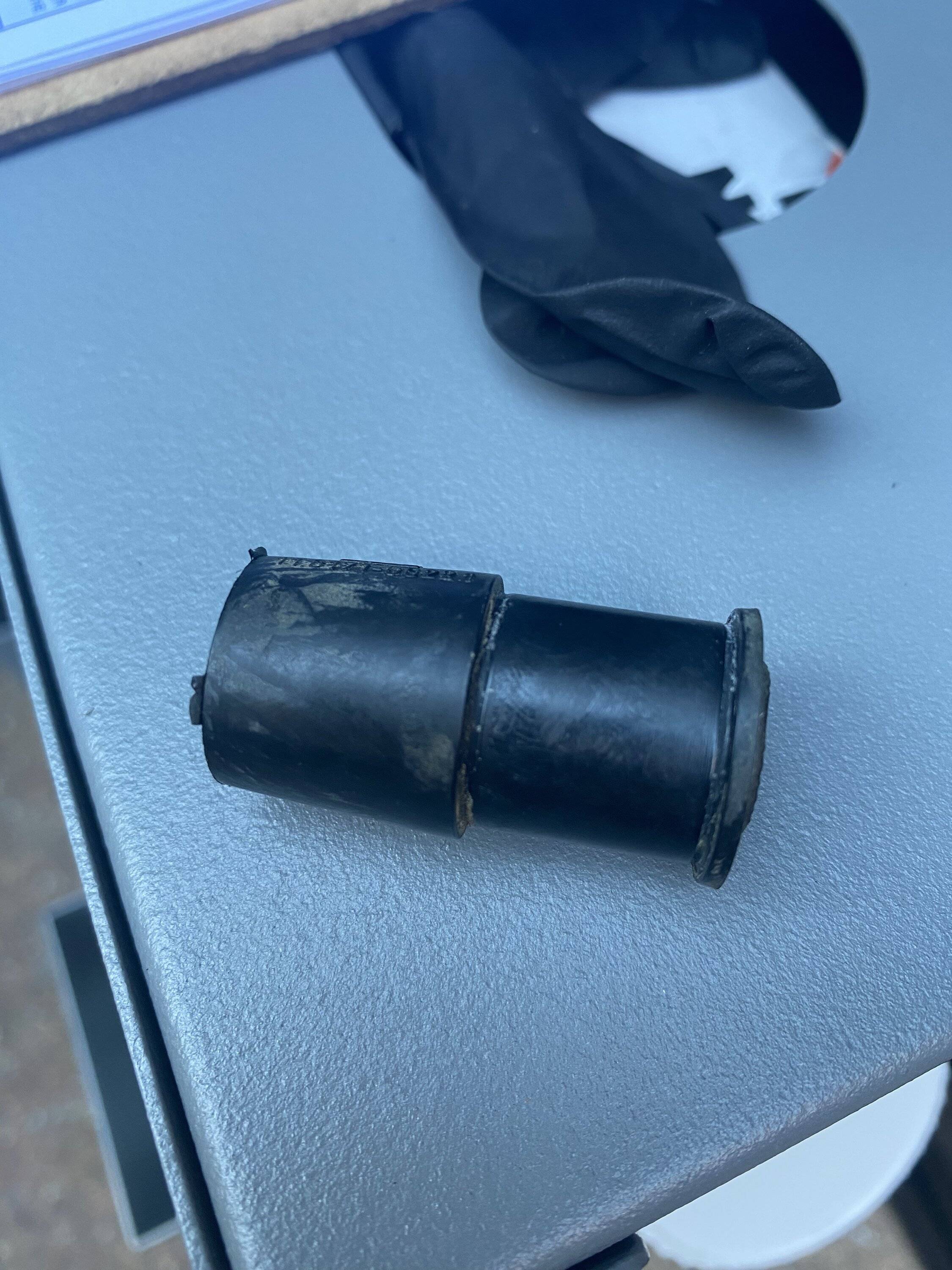

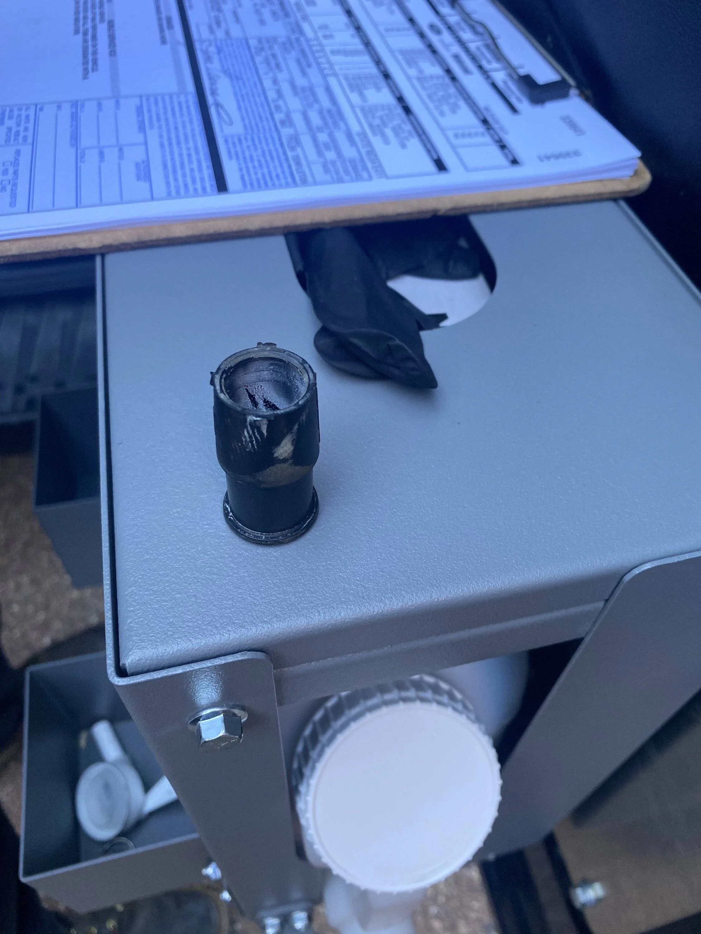

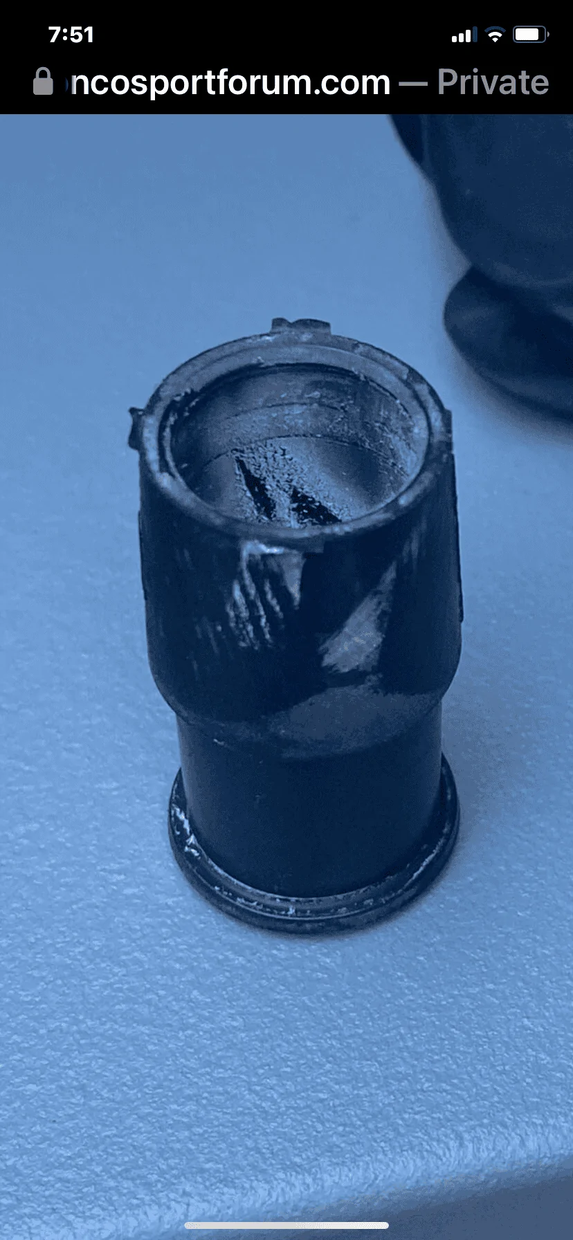

Adam CW
Apr 22, 2022
357
513
Last night after driving for around 30 miles, the car made the thud/bang again. My wife was driving and it happened after she removed her foot from the brake pedal as the vehicle was moving. It’s coming from the rear.
It feels a little like hitting a pothole.
