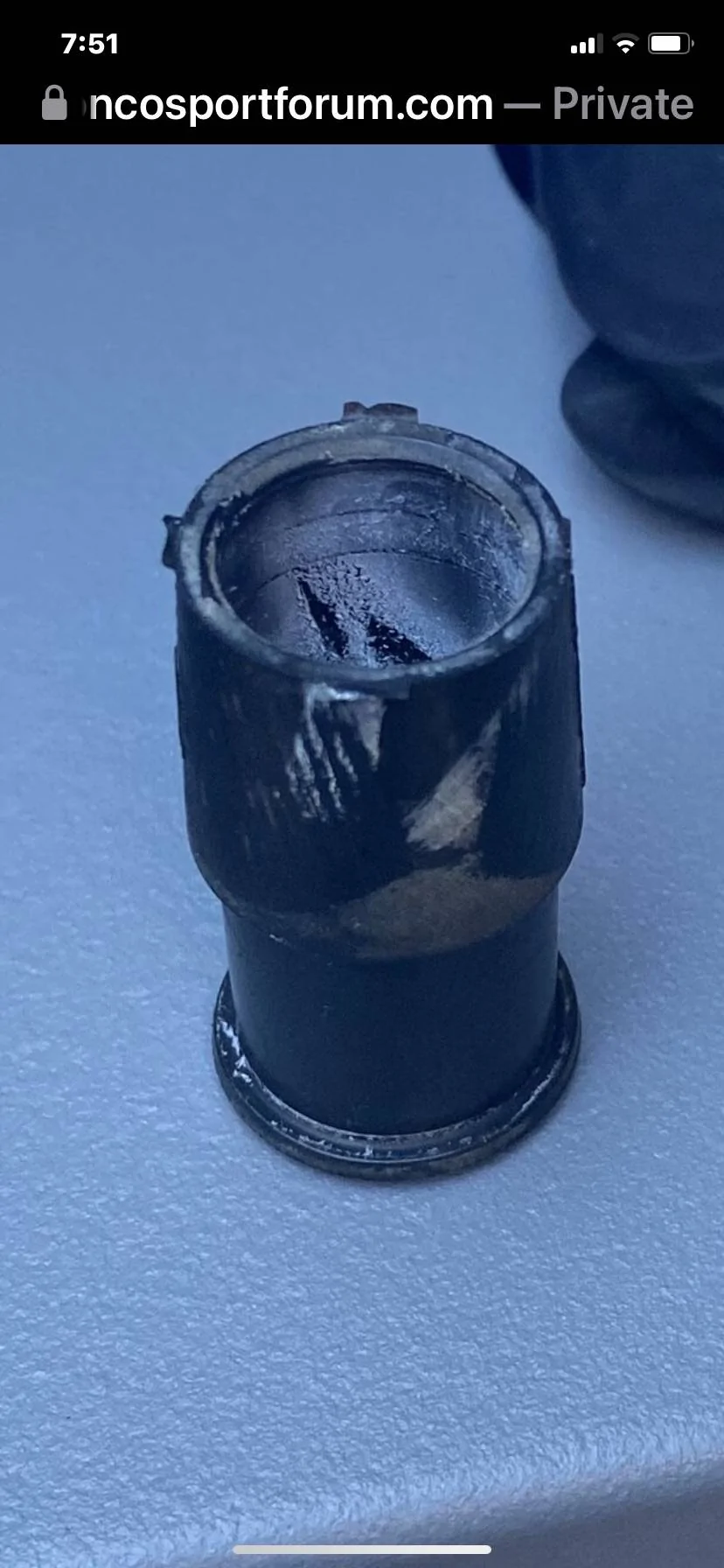

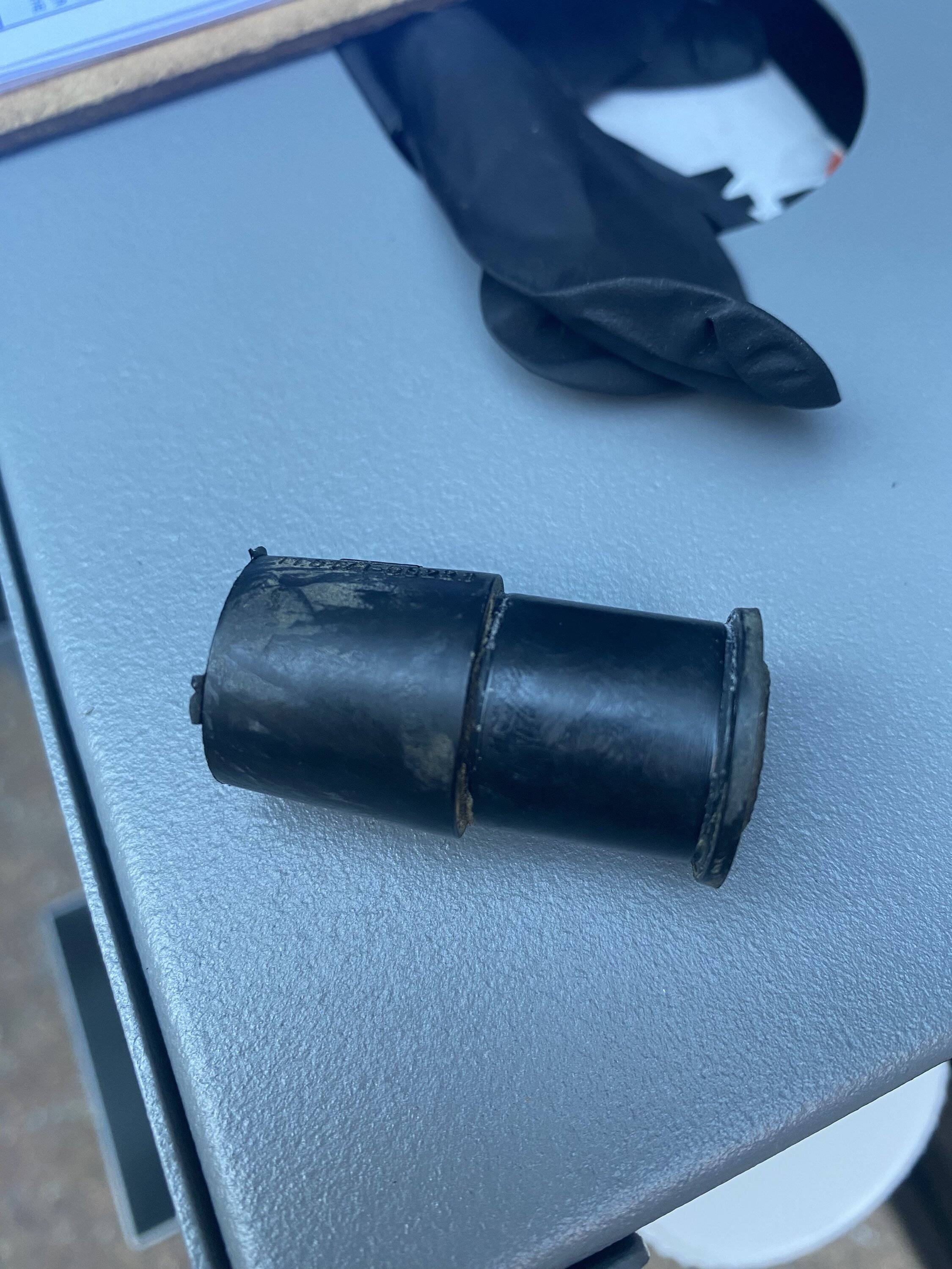

Definitely get it done , the ford dealer came to my house and replaced the bushings in about a half hour. What is happening is the bushings had no grease in them , not 100% sure if they ever where greased from factory. good luck .

If it is just a matter of getting some grease on the pins, there are some plastic caps on the back of those rubber bushings. You can pull the caps and put some appropriate grease in there, maybe with a small brush (like an acid brush). Then reinstall the plastic caps and see if in a week or so the noise subsides.
