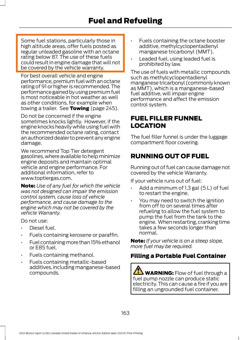

My problem in NM is that regular gas is 86 octane. I understand that carburators run fine on lower octane at altitude, but maybe not turbo engines. Will using 86 octane damage a turbo engine?

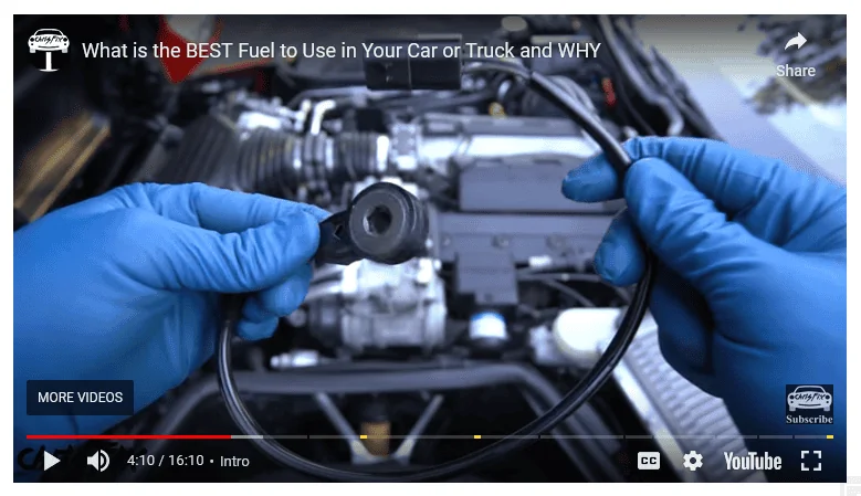

Octane Boosters 101 (video link)
Ford Bronco Sport TOP TIER - High Quality Fuel ... Page 163
Watch the video on the OP starting at 3:28 to 4:28 and 11:12 to 11:36:
Yes, it's very possible. And as Joe points our, your owner's manual makes it clear any damage caused by using less than 87 octane may not be covered by your warranty.
I agree with those who say that 86 octane might cause damage, and the owner's manual does recommend against it. Two points:
1) If possible, run the mid-grade or premium.
2) Unless the engine is going to be given a serious workout -- towing max GCWR up steep grades in 100*F heat -- 86 should be OK. After all, Ford says 87 is acceptable under all operating conditions -- including heavy loads -- so 86 (just 1 point lower) should be fine for normal operation.
My wife and I have traveled pretty extensively out west and we've been in areas where the only fuel available was 86 (or just 85!) octane. There is no choice but to use it -- or be towed 100+ miles to a station with higher octane.
In short, BS owners who live out west cannot always follow the owner's manual.
