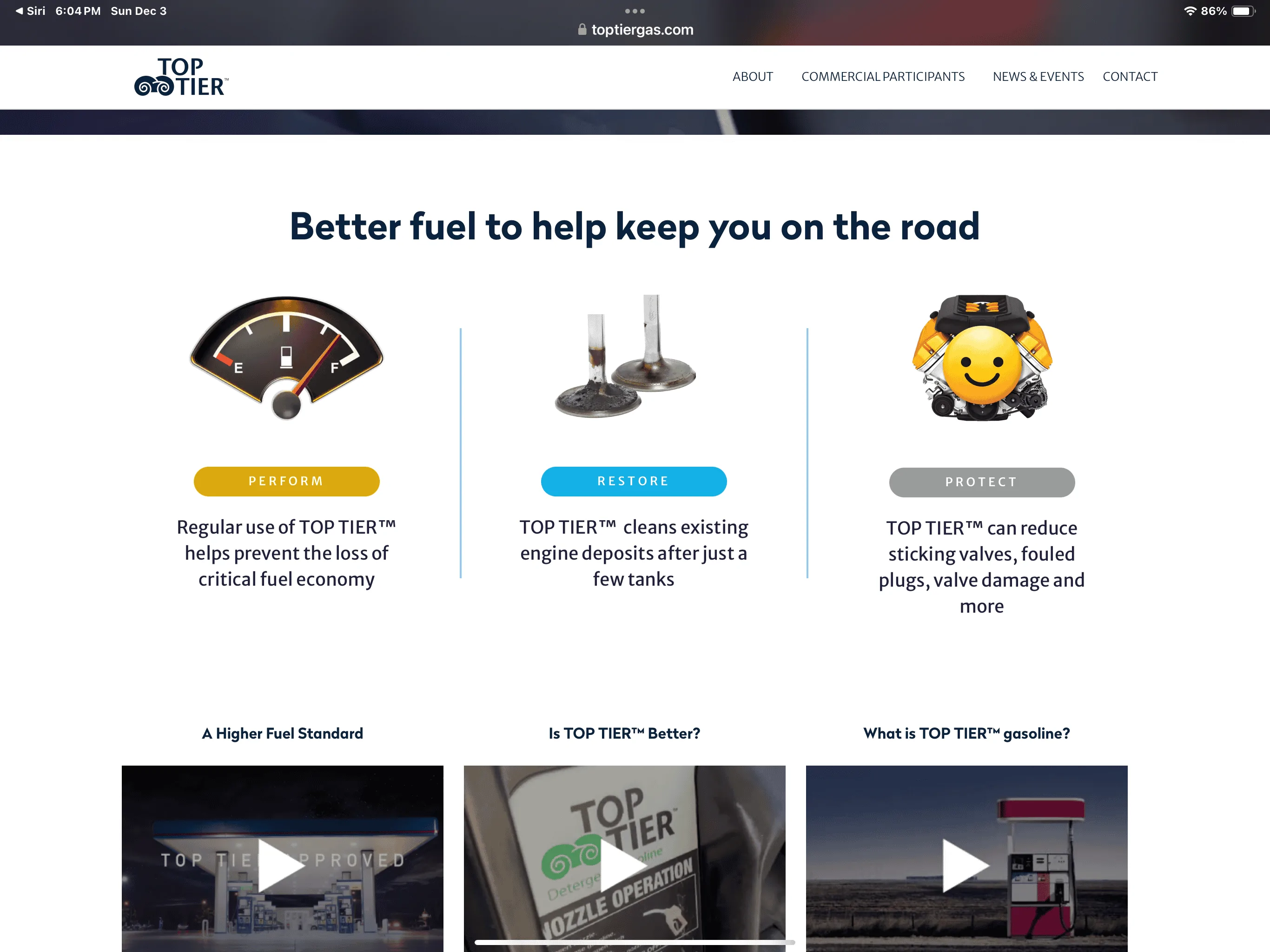

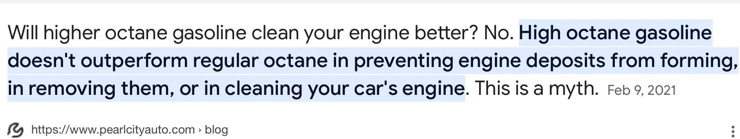

That would only be true if it also included additional cleaning additives. Higher octane gas by itself is not an influence on cleaning your engine.
Ford Bronco Sport TOP TIER - High Quality Fuel ... IMG_1035
Well according to this article higher octane does clean better !!! So who’s right ??? Like I said earlier we could go on an on about this. You like what you like and I like what I like. That’s all. Steve
Ford Bronco Sport TOP TIER - High Quality Fuel ... IMG_4730
Not trying to be argumentative, but top tier doesn’t mean high octane. You can get a top tier gasoline at 87 octane that still includes the cleaning additives. My point was that a higher octane doesn’t mean cleaner running just in itself.

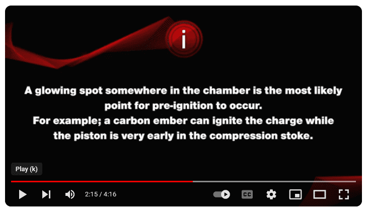

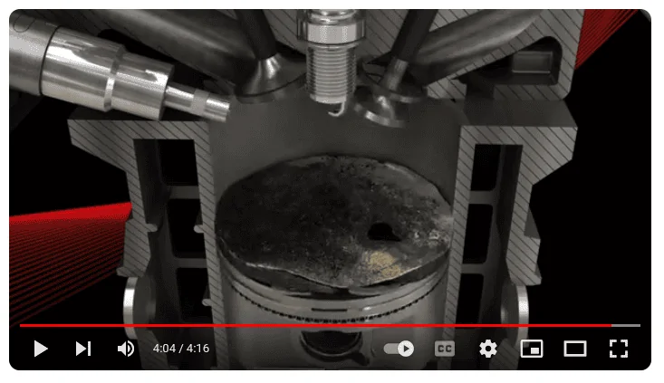

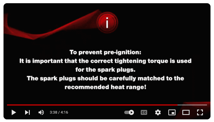

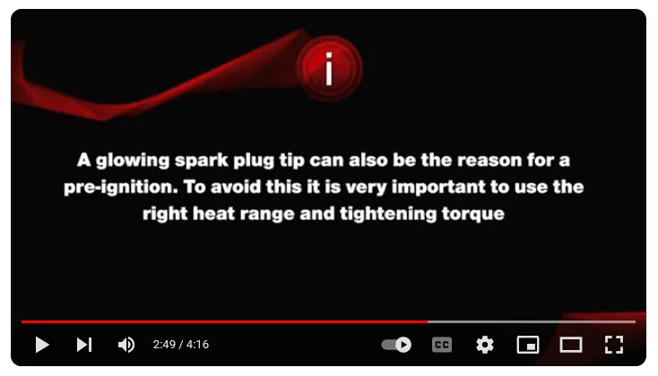

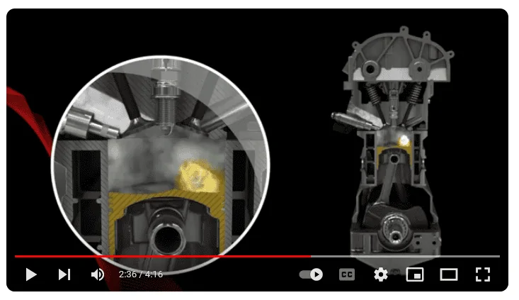

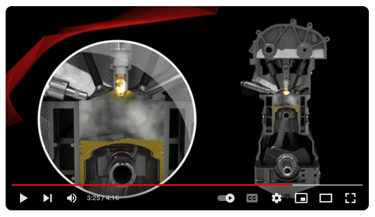

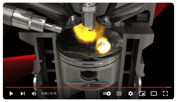

From the Motortrend article: "Knocking or pre-ignition occurs when the air/fuel mixture ignites before intended."
This is not exactly true. "PRE-IGNITION" is when the mixture ignites before intended, i.e. before the spark plug fires. Detonation occurs when the increasing heat and pressure from the ignition event--i.e. AFTER the spark plug has fired--causes the mixture to spontaneously ignite in other areas of the combustion chamber. This results in two (or more) flame fronts propagating in the combustion chamber at the same time. The "knock" or "ping" is the sound of those flame fronts colliding.
The video at this link graphically illustrates the difference.
There is so much confusion around the web regarding these two phenomenon (detonation vs pre-ignition), which is unfortunate, because they are often conflated. Pre-ignition is an engine killer. If the mixture ignites before the spark has fired then the pressure from the combustion event is pushing down on the piston while it is still traveling upward on its compression stroke (see the video linked above for a visual). All the momentum of the engine spinning is pushing the piston upward against that growing pressure. Pre-ignition can destroy an engine after a single event.
Detonation, on the other hand, is a normal occurrence for the operation of some engines, including Ford's EcoBoost series. The PCM (powertrain control module) modulates various engine parameters (ignition timing, mixture, etc.) to optimize power output while avoiding prolonged or heavy detonation. It does this by ramping up power output while "listening" for the telltale knock or ping with acoustic sensors. At the first indication of detonation the PCM clamps down power output to a level just below where detonation first occurred. If you're paying attention, that means the engine must operate at light detonation for the PCM to work correctly. This operation pattern occurs whether you use regular or premium. The only difference is at what power level detonation first occurs. Engine heat increases with power output. With regular gas, detonation occurs at a lower power output than with premium. This is because premium requires greater heat/pressure to ignite, which means the PCM may increase power output to a higher level before detonation first occurs.
Use premium fuel if you need it (prolonged high power demand, such as towing on a hot day), or if you simply like the way your engine runs. I've noticed better throttle response and definitely more pep when using premium fuel in my car. But there's no reason to believe the use of premium will net better fuel mileage or in any way increase your engine's longevity or durability. Now that you know how it works you know it will experience the same light detonation no matter what fuel you use. It's programmed that way.

Screen shots from your video link:
Ford Bronco Sport TOP TIER - High Quality Fuel ... 0136 Engine Knocking
Ford Bronco Sport TOP TIER - High Quality Fuel ... 0231 Engine Carbon Dislodg
Ford Bronco Sport TOP TIER - High Quality Fuel ... 0236 Engine Carbon Ignites
Ford Bronco Sport TOP TIER - High Quality Fuel ... 0249 Engine Glowing Spark Plug
Ford Bronco Sport TOP TIER - High Quality Fuel ... 0325 Engine Glowing Spark Plug Ignition
Ford Bronco Sport TOP TIER - High Quality Fuel ... 0338 Engine Heat Range.PNG
Ford Bronco Sport TOP TIER - High Quality Fuel ... 0345 Engine Double Ignit
Ford Bronco Sport TOP TIER - High Quality Fuel ... 0404 Engine Piston Carbon
Ford Bronco Sport TOP TIER - High Quality Fuel ... 0408 Engine Piston Carbon Ignit
