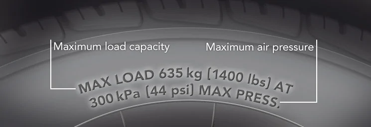

Which tires? It should be printed on the sidewall. Also the vehicle data plate on the B pillar or driver's door edge should have info, but that is only applicable to the stock tires.
Ford Bronco Sport Tire Pressure EDUread-sidewall_maximum-capacity-inflation-pressure-markings

Factory tires should be at 33 psi. Most aftermarket tires should be pretty close to that, too. Don't inflate your tires to the pressure on the tire sidewall. That's max pressure and the majority of drivers will never need that much pressure in their tires.

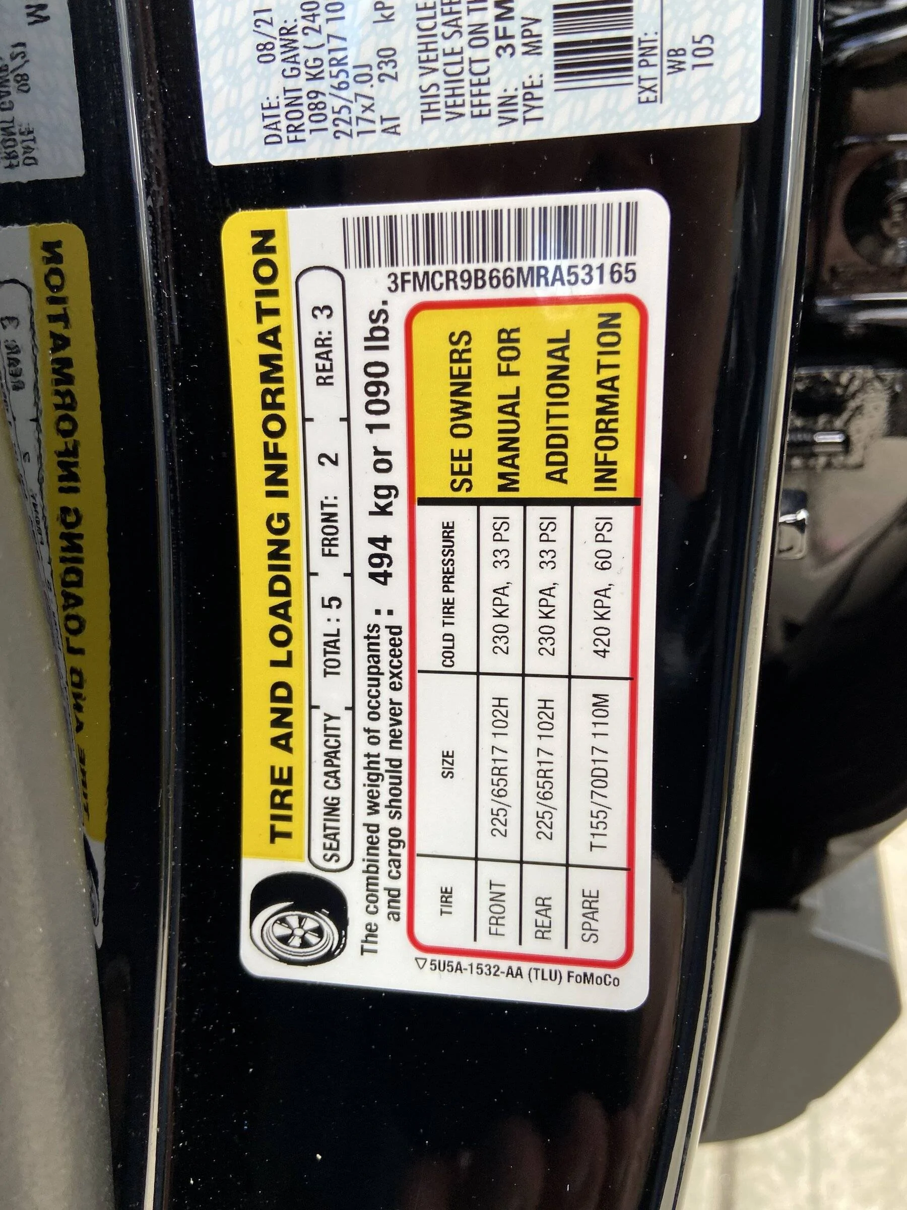

JAD67428
Nov 21, 2021
678
1,140
MA.
According to the Manufacturer it’s on the drivers side when you open your door. 33 Pounds.

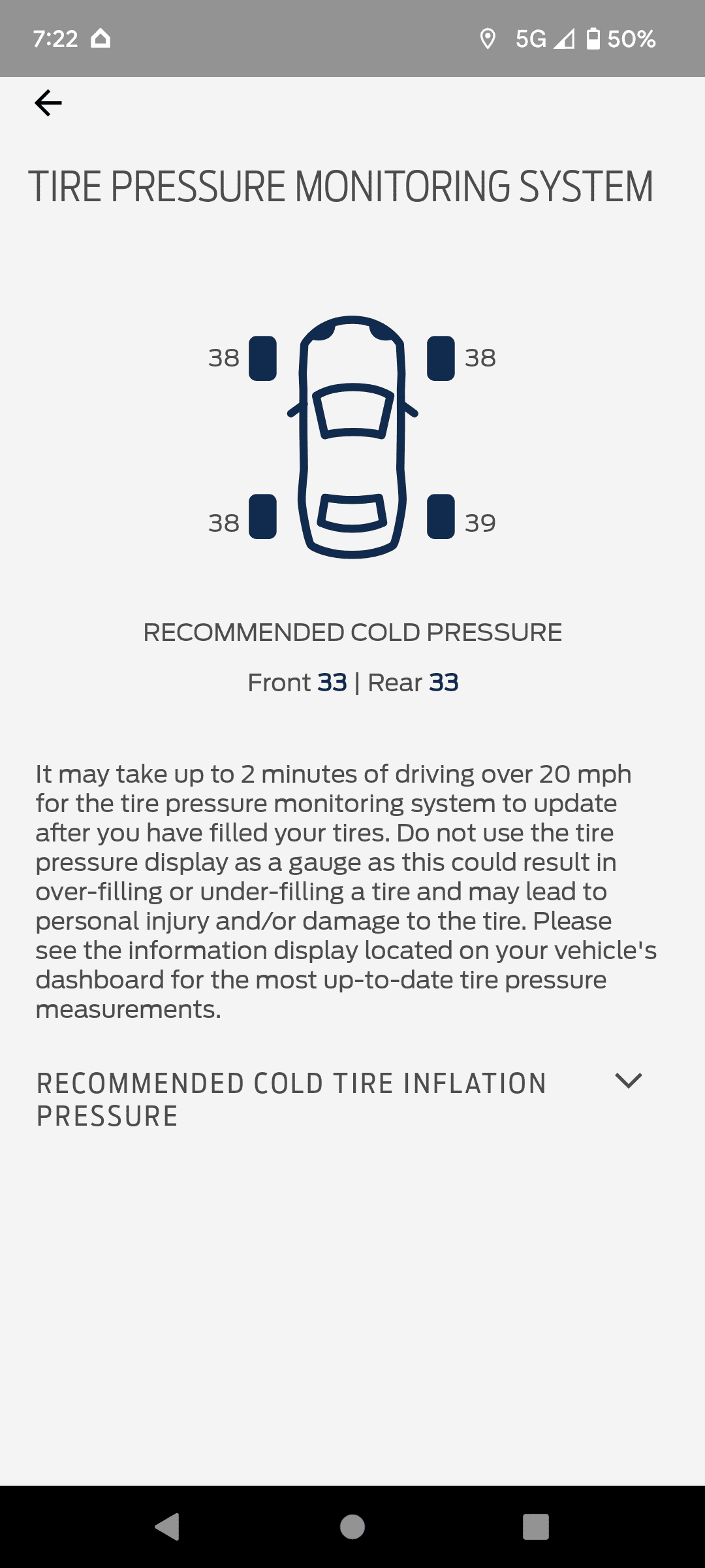

Bdud
Brian
Mar 16, 2022
49
24
Chicago
Ford Bronco Sport Tire Pressure Screenshot_20220410-192205
Oh wow. I would have thought the dealership would know what pressure to put in the tires.
