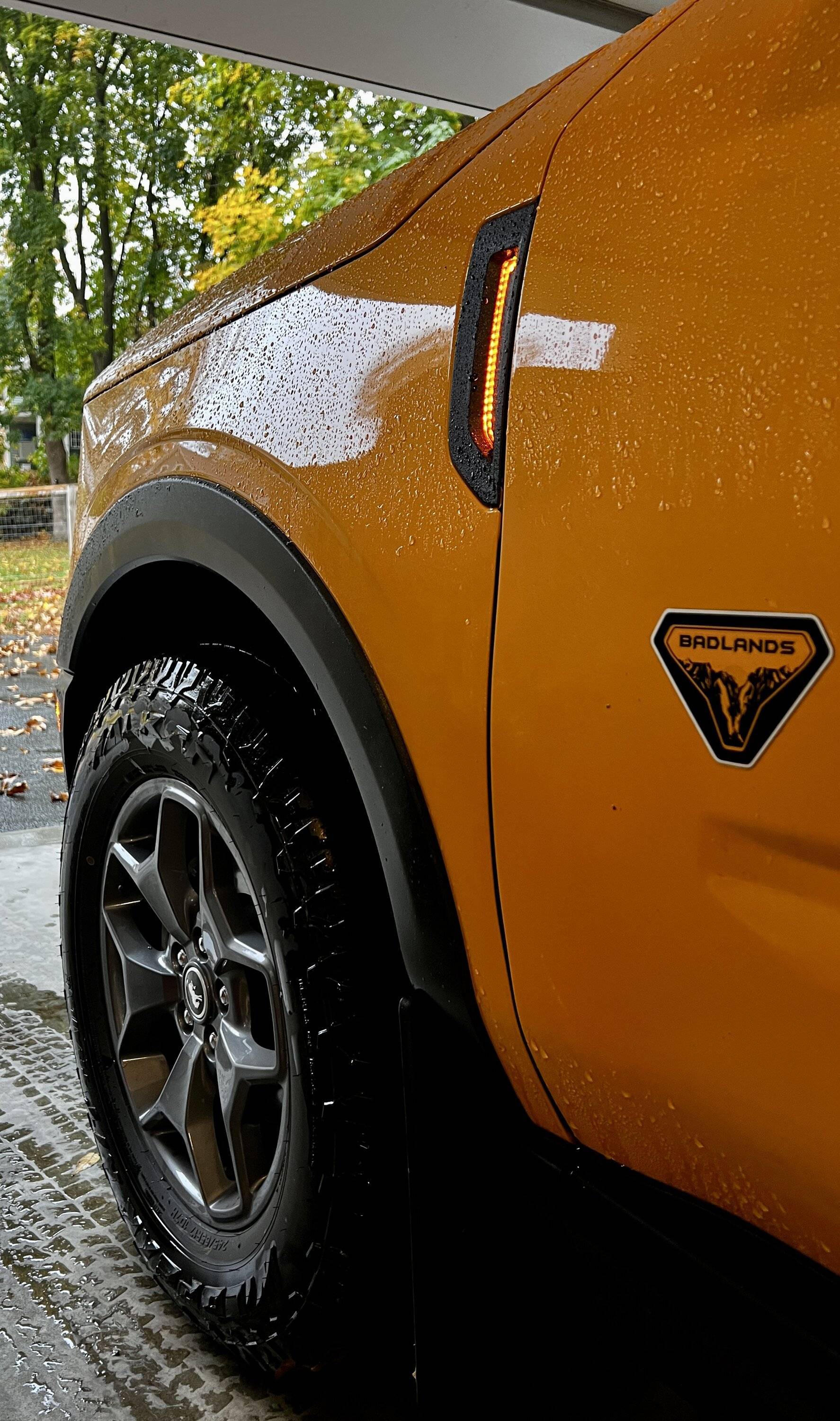

2022 Ford Bronco Sport Badlands
The best comfortable setting I found is 27 psi but I don’t have the AT3w’s
