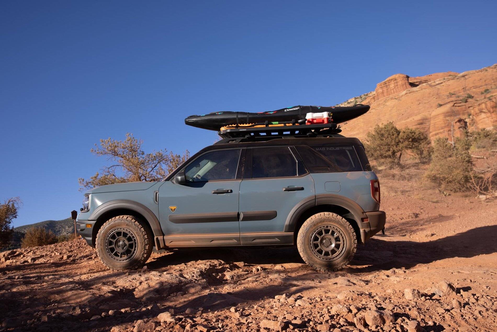

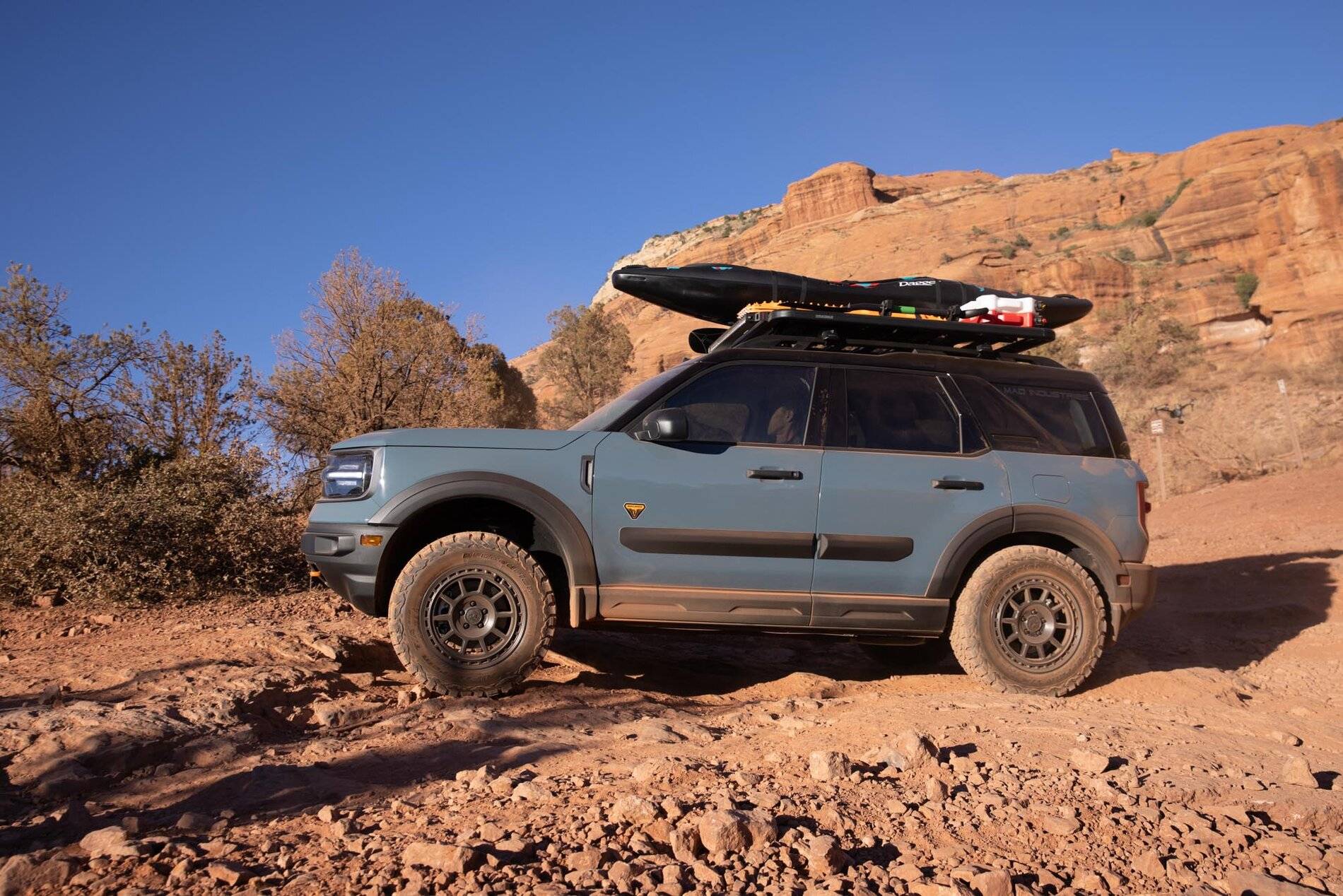

Hello All,
This is what you need to follow for proper clearance based on our set up only.
Specs on our vehicle Bronco Sport, Badlands.
We installed 4 Wheel parts 1" lift / level that raises the front and to the rear so remember they call it a lift / level but we also gained additional clearance in the rear that was needed to clear tires. Also note we removed the rear deflector on the rear wheel well that is mounted on the lower front side that would not have cleared the tire we used. FYI
We test fitted 3 tire sizes on 17" x 8" Wheels with a +35 offset the only tire that had clearance to our standards, i.e. clearance to drive the vehicle with proper clearance are 245/65R17 we used BFG KO2s we did not test fit any other brands or model of BFG remember KO2 and KO3 have very square shoulders on the tire that can tend to rub on a tight fitment. We had absolutely no rubbing on our selected tire size and we tested it on all type of off-road terrain.
Other tire manufacture that have a rounded shoulder such as Nitto Ridge Grappler that we have used on many vehicles provide additional clearance at the critical point in the turn radius this tire may clear in 30" or 30.5" OD but any tire over a 30.5 will rub on this set up period. You will need to test fit this tire on this set up to determine if 30" or 30.5" will fit.
KO2 Specs on the size we used.
SIZE
UTQG
Tire Weight​
LT245/65R17
111/108S
D
None​
2,405 lbs​
65 psi​
13/32"​
44 lbs​
7-8"​
7"​
9.8"​
8"​
29.5"​
704​
Good photo below driving rock terrain shows just how much movement in suspension.
