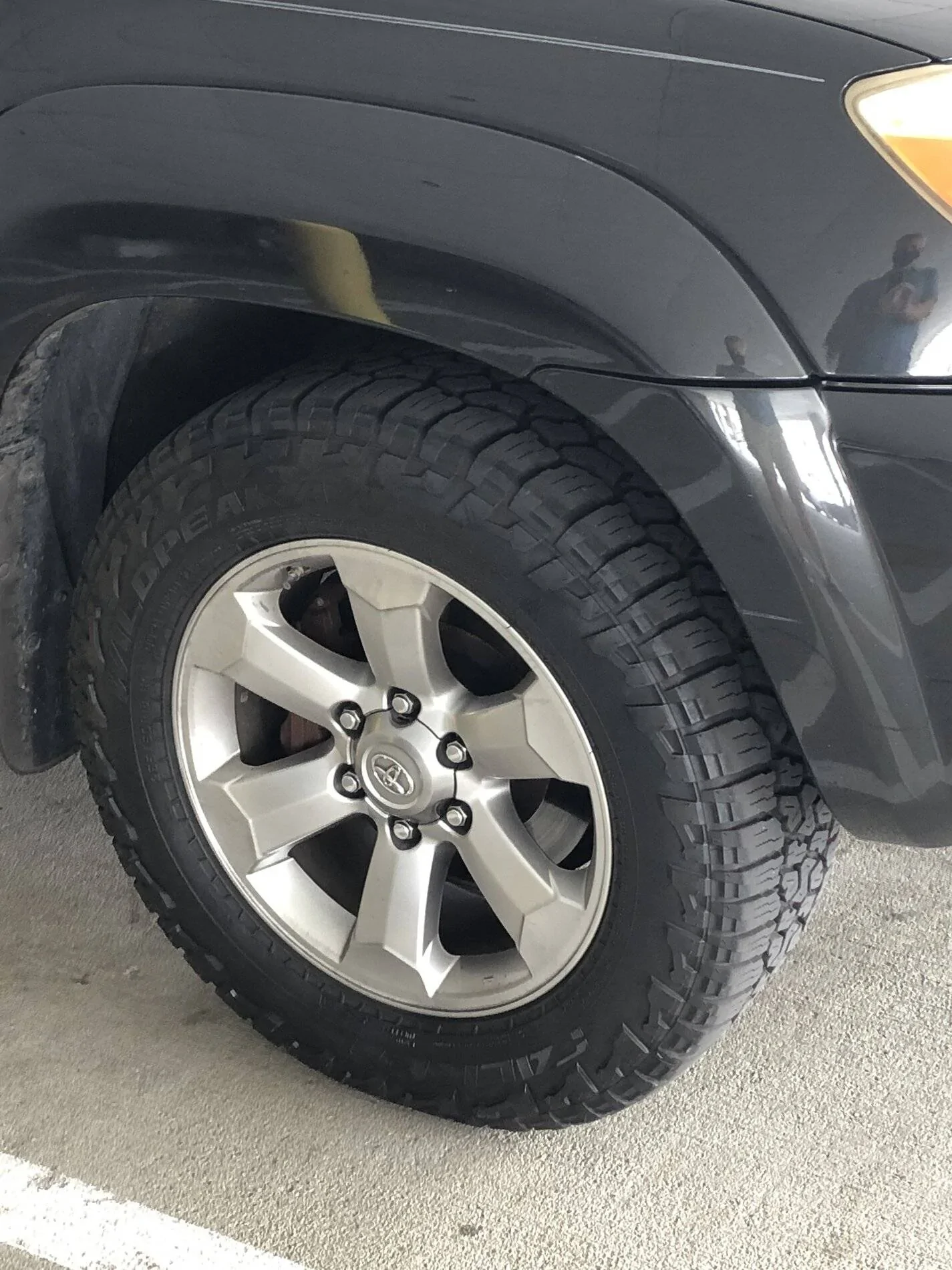

I mentioned this in another post, but I have Falken Wildpeak A/T3W tires on my 4Runner right now and really like them. I'm not much of an offroader, but these tires behave very well on the highway and in torrential rain. Plus, I think they look cool. :)

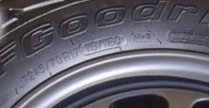

The Cyber Orange with the lift has 245/70r17 on it but the 265/65r17 is wider.
Thank you, you beat me to it, I saw the new pictures today where you could read the 245/70R17, I'm working on an update to my first post.
Here is a closeup of the photo I saw it in:

I have updated my first post with the correct tire size Ford used on the Bronco Sport Trail Rig with 1" lift, it is a 245/70R17 not a 265/65R17 size tire.
