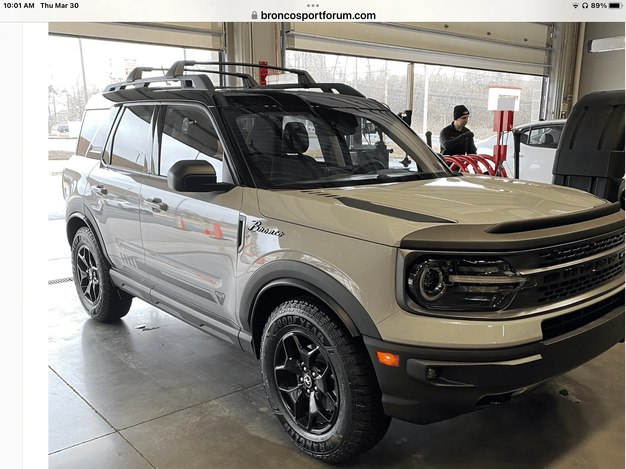

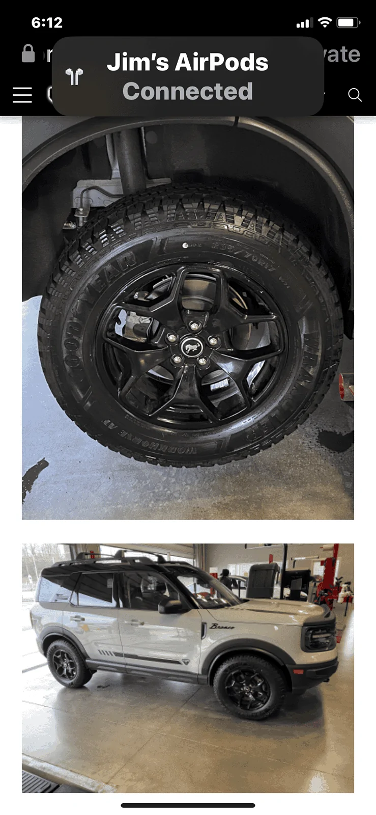

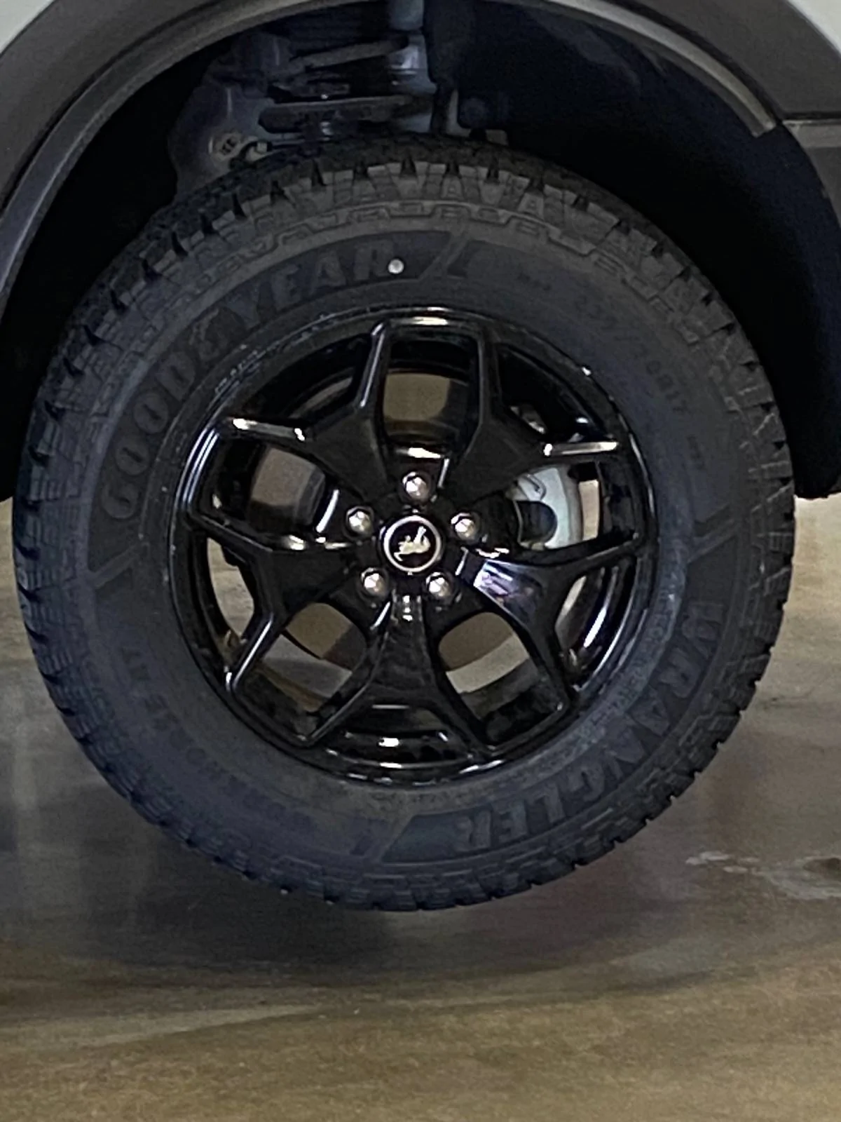

Thank you, you beat me to it, I saw the new pictures today where you could read the 245/70R17, I'm working on an update to my first post.
Here is a closeup of the photo I saw it in:
Ford Bronco Sport Tire Options for Bronco Sport with 1" Lift 2021 Ford Bronco Sport Tire LT245-70R17 - closeu
235/70/17
