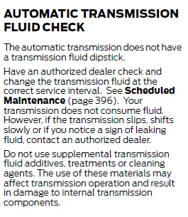

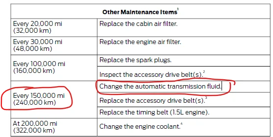

From the owner's manual....
Ford Bronco Sport Thank You Ford 1767057275878-ou
Ford Bronco Sport Thank You Ford 1767057162342-wz
The OP wasn't required to have the transmission fluid changed. If he was required to and IF that is the cause of the failure, then it is Ford's fault for not recommending it be done at a lower mileage.
There is still no evidence that the OP did anything wrong or should have done anything different (other than buy a different vehicle or sell this one sooner), and more importantly, that changing the trans fluid would have prevented this from happening. We don't even know what's wrong with it. I'm familiar with one particular transmission having snap ring issues that resulted in a failure but it had NOTHING to do with fluid changes and doing so would not have prevented it from occurring. How do we know it's not something along these lines? The answer is we don't.
So, it's really pointless to keep suggesting the OP didn't have the fluid changed and claiming that would have prevented the problem. There is simply not enough information to determine root cause. Without that, it's not possible to conclude having the trans fluid changed would have prevented it.
Your pic is out of context and is not the "Severe Duty" schedule. Even if he did have an warranty and did not perform the correct maintenance for severe duty the claim would be denied. FYI 12k-15k miles/year is average. He's driving 43,333 miles/year. Hes has 130k and has not clarified if he has or has not performed a transmission fluid exchange.
He was asked several times "when did you have it serviced last" yet he never replied. I know I would of provided detailed proof that I took care of the vehicle in every way possible. Did you notice he never asked for advice or help he just complained and called out Ford right in the title of his post? The OP came on here looking for an audience hoping someone from Ford was on here would fix his problem if he was the "Squeaky Wheel". Sorry I'm not cutting this person any slack, he knows exactly what he tried to do with his first time post on this forum and you fell for it hook line and sinker.
On top of all this the day he purchased the Bronco Sport he was offered a extended warranty and 6 months before his factory warranty expired Ford sent him a email and letter letting him know if he wanted to extend his factory warranty he could. He chose not to just like the maintenance on his transmission, he chose not to.

@Whpony96 You may be correct that he came here looking for an audience (or just help). I actually have no issue with that. I thought that's what this forum is for. IF he was trying to be the squeaky wheel and Ford actually helped him, would that be such a terrible thing? I also agree it seems likely he didn't get the extended warranty, but we don't really know that either because he didn't mention it. None of this is in dispute.
The picture from the service manual is not out of context. Below are the "special operating conditions" which define when the trans fluid should be changed every 30K. As you can see below, the simple act of driving 40,000+ miles a year is not enough, by itself, to suggest the trans should have been serviced prior to 150K.
COULD he have been towing a trailer or using a car top carrier for most ("primarily") of those 130,000 miles? Maybe, but we don't know that. IF he was towing or using a car top carrier "primarily", did he change the trans fluid every 30K? Probably not, but we don't know that either because he didn't answer that question. Even if he was towing or using a car top carrier "primarily" and if he didn't change the fluid every 30K (which, IF true, I would definitely agree with you that it is shady to blame Ford!!!!), we still don't know that changing the fluid would have prevented the problem because we don't know what the problem is. It could have simply been a bad trans with an outside-the-bell-curve component that slipped through quality control built on a Monday. He could have changed the fluid once a month and STILL had the issue. We don't know and will likely never know.
Ford Bronco Sport Thank You Ford 1767104345231-22
Your issue seems to be that he's blaming Ford. Blaming him and suggesting the problem would have never happened if he would have serviced the trans according to the special conditions maintenance schedule without sufficient knowledge of his driving habits and without knowing what the actual problem is with the transmission is just as perplexing.
